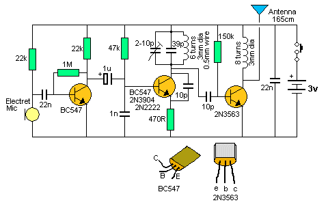

Here is a very simple,working and tested Fm transmitter circuit for newbies! It has built and tested by me and works a very long time using a 3.7 volt mobilephone battery! You may expect about 100-150 meters with a 400cm long antenna! Try more length for cover more range, the inductor can be an 8 turn,3.5 diameter of copper wire eg. Take a pen refill and wound 8 turns on it,remove the coil and solder it on the circuit, the second inductor that connected directly to the antenna is not needed plus adding a 22n (223) ceramic capacitor to couple the antenna will be useful to get rid of those frequency changing problem when touch or move towards the antenna, (i used the copper wires from a damaged transformer to make coils and it works fine) and i used 2xBC547 transistors,.. This is just a very basic fm tranmitter for newbies to work with..Good luck

I went ahead and redrew this schematic for you.
You do realize the original was drawn upside-down, don't you? Not wrong technically, just weird. Why would someone draw a circuit that way?
Anyhow, this looks a lot more believable than that 1-transistor circuit you posted earlier.
Funny; I found what I think is the original schematic for this circuit:
This was apparently modified (and redrawn, badly) by someone, possibly one of those notoriously error-riddled Indian circuit sites.
I'm curious: where did you find this circuit? Did you make any changes?
The original site seems to be reliable, and the author seems to have tested most of his stuff.
LTSpice is sure it won't work, too!
Which circuit above did you simulate? (I'm guessing the latter one.)
I take exception to Ziddik's comment: this circuit was definitely not designed by a "noob". Check out his website if you don't believe me.
Well, I simulated both of the circuits I posted here earlier in LTspice (attached below for your simulation pleasure).
Guess what? According to LTspice, neither one of them works! Now, I don't know if that's just due to some quirk of the software, or if I made an error somewhere (that hardly seems possible!). However, if Ziddik claims that one of them actually works, then I guess I'll have to take their word for it.

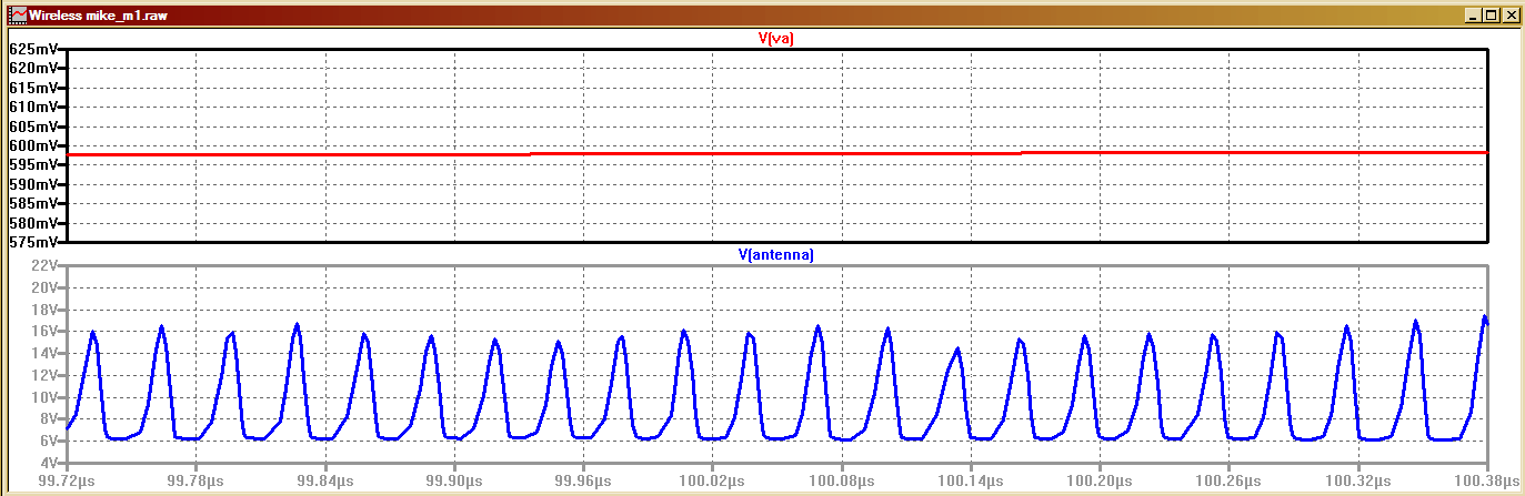

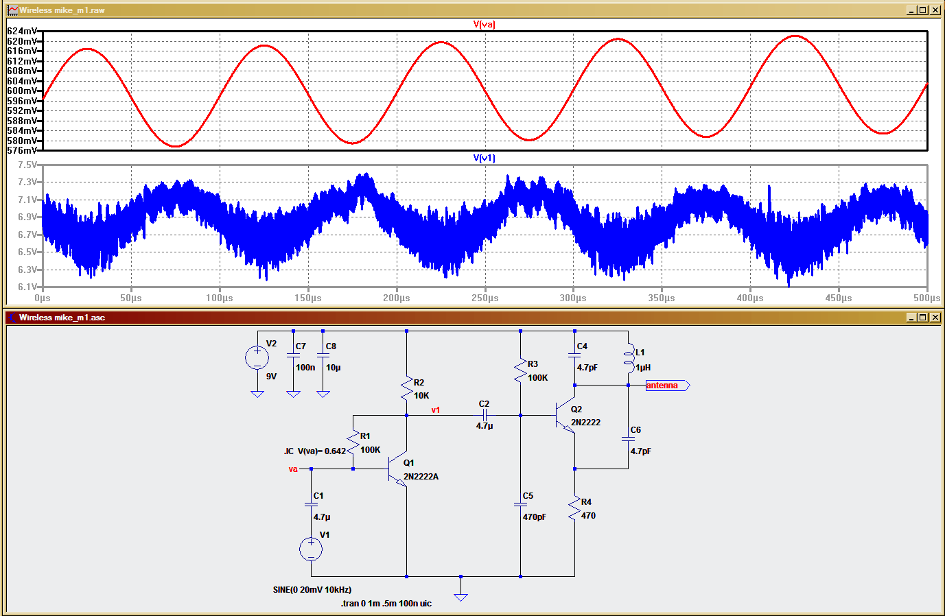

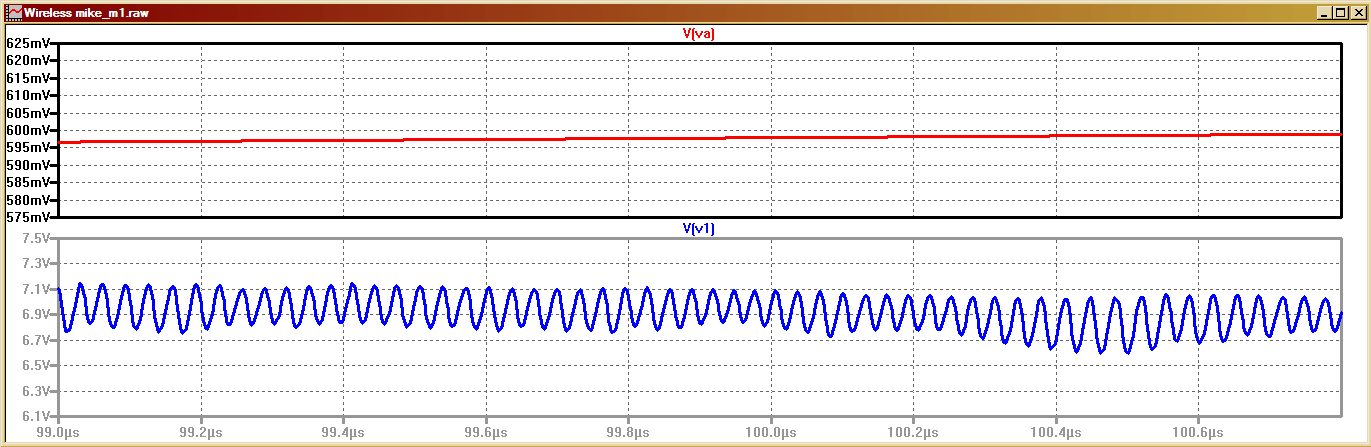

cz,
Look at the .IC [ initial condition] on the base of the 1st transistor.
If you start from zero V, the 4.7uF cap takes ages to charge up via the 100K, so the transistor is not biassed on until the Vb reaches ~0.65V.
To see the 'RF' you must select a time interval shorter than the wave form you want to see, look at the .tran values
Also you dont want to see the start up initial conditions.
I have also reduced the audio drive and made it 10KHz.
The right most image is the RF out

  • Wireless mike_m1.asc
Which if I interpret it correctly is a grossly distorted "sinewave" with a frequency of about 33Mhz.
All in all a truely horrible output for a radio transmitter which is supposed to be running in the VHF FM broadcast band.
hi Jim,
It is a horrible little circuit.!
My interest is only in the LTS simulation problem that 'cz' had with the circuit.
I second that. It will splatter interference over a wide band. Very anti-social.
