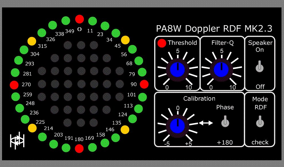

This is a good article on direction finding; the two antenna diode-switched system is a simple one that can give very good results:
Or, this is a rather more complex setup that gives a relative bearing - it's pretty much the same as used by police for tracking stolen vehicles equipped with a "Lojack" system.

I want to share an update. I've been reading the article about a radio direction finder. Seems like it will solve my problems. I really was missing a lot of information to base good questions upon.
