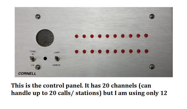

Hey new guys here, have an LED display project I need help with.
So I have a panel with rows of LEDs that correspond to each room, when a call is sent from a room the corresponding LED is illuminated.
I want to take the power going to the LED and instead have it light up a large 2 digit numeric display LED that will show which room number the call is coming from.
I only have basic soldering and electronics skills, so I want to keep it as simple as possible.
I would guess there is some kind of module/ chip that has a bunch of input channels (for each LED, 12 total) which when triggered with a input voltage would illuminate a programed number?...
Huge thanks in advance!!

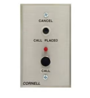

The call button panel in the room has a "cancel" button, Which in turn shuts off the LED on the control panel. I see it being the best option to take the power going to the LED and divert it into being the input signal for displaying programmed digit on LED display.

It wouldn't... I though you wanted a "basic" system.... I would do it with a pic..
I agree, this is definitely suited to some form of processor.
Arduino (nano) is probably most suitable as there's lots of example code available.

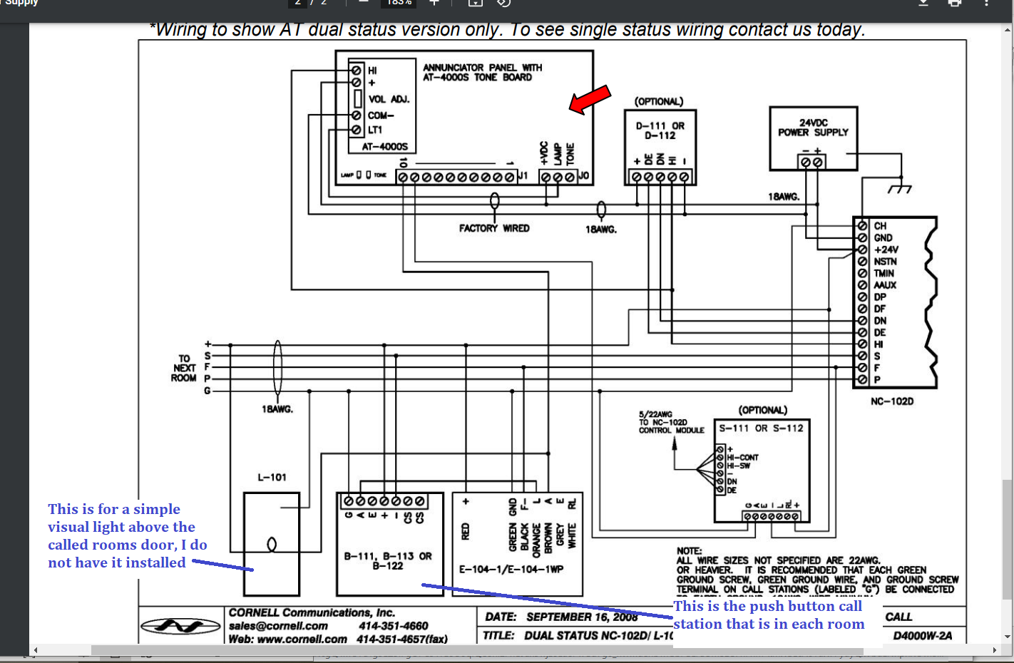

Yes more than one can be lit at once. From what I can tell on the diagram, and from what I remember when I wired it up, there was 3 wires that I used. Both the call and cancel buttons are momentary push, so it does not hold a circuit. only sends a momentary signal to the control panel.
Heres some pics if that will help

Everyone here was assuming that each room had a simple push button with wires back to the display panel. We now find out that each room has a "communication" device to inform the control panel what to display. That completely changes the ball game.

It may be possible to make a design that simply looks at the LEDs and displays a number but it would need a processor to remember the order that LEDs were lit so it can display the next priority number.
Edit, Another problem is the LED display is probably a multiplexed display so the LEDs aren't constantly lit.
From a look at the makers other diagrams and info, each room alarm unit just switches it's "A" terminal to ground when triggered, so it's not using complex signalling in that part.
The LED panel is not much more than lamps commoned to V+ (12 or 24V) and each lit when it's individual terminal is externally grounded.
There's 5 wires go room to room, two of them are power. How do you signal 12 (or 20) events through three wires without some kind of complex signalling?
It presumably does use digital signalling on that bus - but the annunciator panel with the LEDs does not connect to the bus wires.
It just has power, ground and the "A" wire from each unit, which is also used for an optional alarm indicator light for local alarm indication.
The LED panel shown in the diagram is only 10 way, showing "A" wires to the first two input. They make them in different sizes.
Ahh, I see what you're saying now, I think. The A wire travels from each of the rooms back to the annunciator panel.
I'm guessing the two modules (center bottom) must be in each room.
Not sure why 5 wires need to travel to each room (especially the P wire).
So, in the OPs case, a 12 LED unit, 5 wires go out and 12 wires return.

Each room has a small panel that has only mechanical switches, no circuit boards. (only has a few resistors or something that keeps the "call placed" led on until the call is cancelled).
Has a momentary switch for placing a call, and a momentary switch for cancelling the call.
Cancelling the call at the room turns off the LED for that room and audible beep at the control panel
If there are other rooms that placed calls at the same time, the LEDs for that room will stay lit at the control panel until each room call is cancelled inside the room, and audible beep will stay on until all rooms are cancelled.
