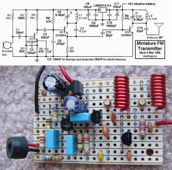

My FM transmitter fixed many problems with an FM transmitter that did not work. It is fairly cheap and simple but it works and sounds very good. I explained its good points.

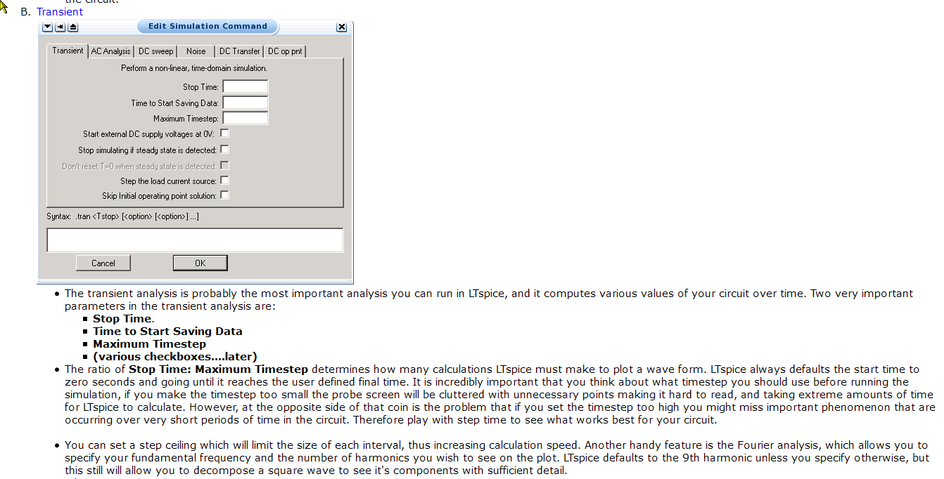

To see the 'RF' you must select a time interval shorter than the wave form you want to see, look at the .tran values
Well, your simulation certainly does work, I'll say that.
But I'm still in the dark concerning the time interval ("step") setting for the .tran command. What exactly does this do? Yes, I've looked at the online help; it explains nothing.
Does this set the absolute step used in the simulation, the smallest step or what?

Ziddik is absolutely right. Power supply ripple of only 100uVpp will produce about 200kHz of frequency deviation for the first circuit. Here is taken into calculation only oscillator part of the circuit. This 200kHz of deviation is actually maximum deviation for any FM transmitter and voice from microfone will be practicaly muted.
And a question for some quys here. How many kilos if smoothing capacitors do you need to acheive at least 40dB of S/N for this FM troublemaker?
My admiration goes to India and it's people.
cz,
Look at this extract from the web page link.
Its explains the use of the 'maximum time step' and what it means.

i am getting sick of audiogurus "pre emphasis" and "trouble boost", just add a 22n (223) capacitor to couple the sound input..
Sorry, but if I make you sick then maybe you should talk about your poor quality FM transmitter on a website in your country in your language.
Pre-emphasis makes an FM transmission sound perfect. ALL FM radio stations have pre-emphasis. Yours has no pre-emphasis so it will sound very muffled without high audio frequencies (something like an AM radio).
Pre-emphasis boosts treble audio frequencies, it does not cut bass frequencies like your idea of a low value coupling capacitor.
This FM transmitter is practicaly capable of only telephone voice quality. Thus it needs no pre emphasis so as all variants of this transmitter does not have it.
audioguru is exaggerating all the time and is well known by his arrogance.
i have said u hundreds of time that its just a simple circuit for noobs (not a profesional one to make a radio station!) so it does't need your "pre-emphasis" nd "trouble boost" ok? We dont want it! Ok? Nd i dont want go to another website, ok? I get better and clear sound output without using ur "pre emphasis" and "trouble boost" (treble).. This is not to start their government approved radio station.
