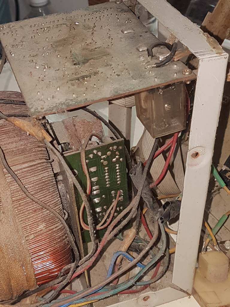

I have an AVR that uses a toroidal transformer and a Servo motor to stabilize the voltage. Now if it was new all would be well, but this sad little thing has seen some battle and i thought as a small learning project i would try and restore it. I know i could buy a new one but i just feel it would make me happy to get it working again.

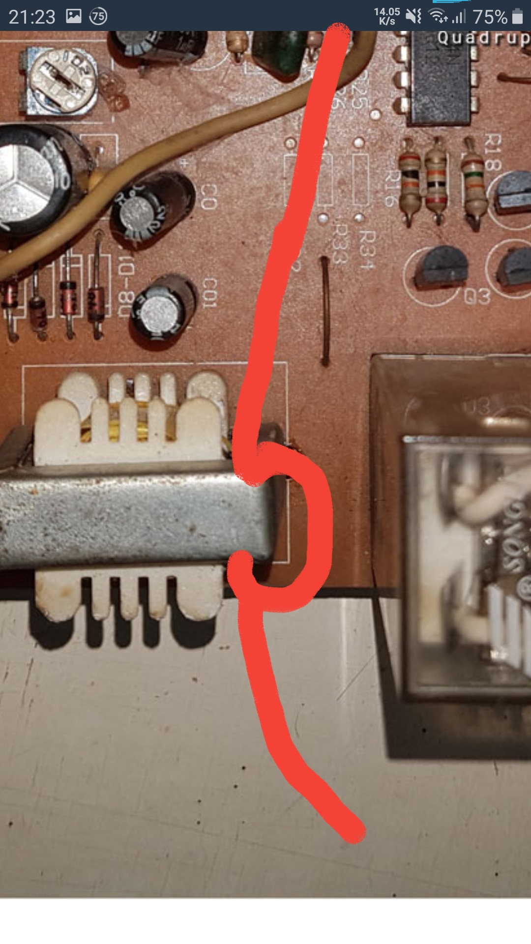

The Safety circuit below only had one input from the secondary coil from the big transformer at about 15v and then strangely it had the phase AC wire (direct from mains) wound once around the right side pillar of the small transformer and then it went to the big transformer primary winding. I'm trying to understand if it is just some anchor point for the cable he used, or it actually does some sensing that way? when powering on the AVR the relay switches on after a few seconds and the LEDs show its on, so it seems the delay/timer works and displays it ok on the leds

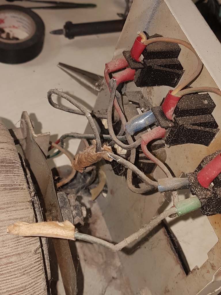

Now the servo motor control circuit i think is broken or not very happy. One of the limit switches was broken in half (ive photoshopped in the missing right one)
This circuit also only had one input from a secondary coil and it was just around 2v which must be either wrongly changed by someone or used as something else i totally dont understand. I did try and use the Safety Circuits input on this as i guess they use the same rectifier components an it uses the voltage difference to somehow control the servo....what i am trying to find out is.... does it, the circuit make any sense or did the previous owner just jerry-rig it to statically raise the voltage and moved around the inputs for some reason..? what do you think?
I've ordered a new motor driver IC and the other as well just in case. I only got 8v on the BA6208 output when it had 12v powering it so maybe it somehow blew..

A single turn around a core is a classic current transformer, though I dont know why this thing would need one,
Interesting... This is how the wire was wrapped.. Not around the central core but the side... Is thst how it works? Also the transformer in the photo only has one winding... Would that have some sensing function?
This board has a 2 pole (?) relay so i guess it has some over and under voltage sensing and shuts off the output or input..

And looking at that wire no its not being used as a current transformer, prbably just as you say mechanical securing.

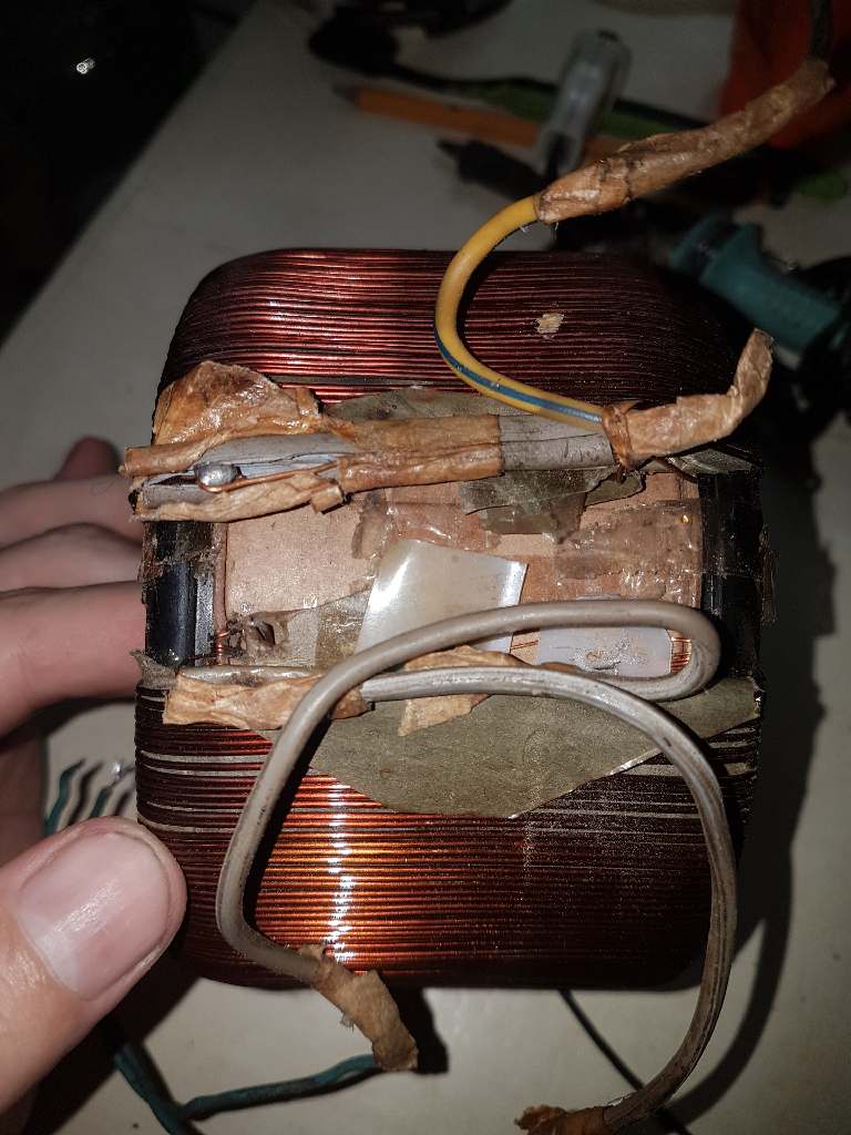

Last one is me finding out what the guy did to the poor variac before.. I did find a winding that broke off, that was under some plastic and measured both secondary windings and they gave me 1.5 Ohms each.. And the main between 6 and 8 Ohms depending on where you measure it before the slider or somewhere on it..
Interestingly on the back of the case there is (was) a 110v socket and on the variac there is a cut/tap at around 4 Ohms... But that cable was just in the air when I opened the case..

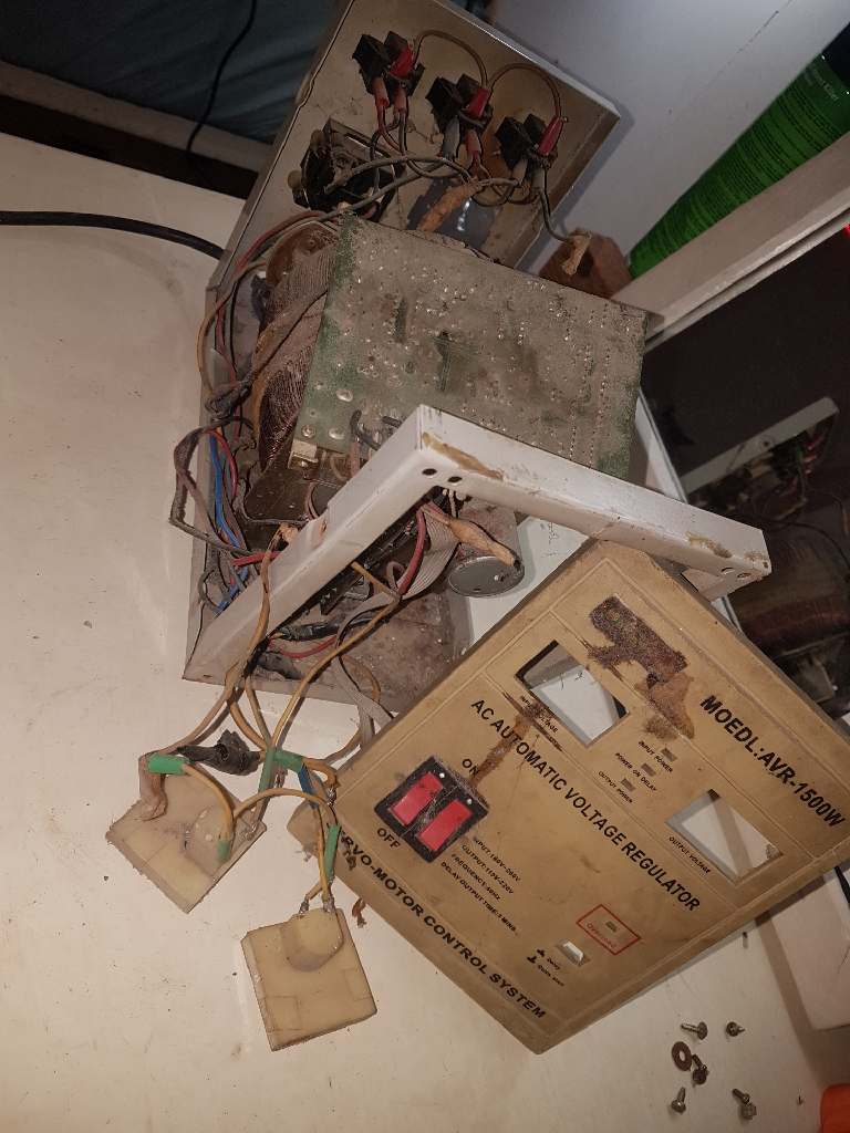

Anybody notice the nice label... Think the guy might have had a few too many :banghead:
It's possible they used the method to implement a current transformer. The"small transformer" only has one winding.
KISS you are totally correct I thought it was the OMNI 1500w AVR... Until I saw the nice spelling of MODEL (Moedl) on the front panel and deducted it must be some copy :meh: Mine also lacks the built in fan the branded one has. That leads me to the conclusion more things might be different. But I did however email OMNI customer support a while ago and asked if they would be willing to send me the wiring diagram, although I doubt it...
Dr pepper commented on the photo of the one turn winding and thinks it is most likely just a anchor point.. The previous owner used... But what does a one winding transformer do?
A one wind or current transformer transforms current.
Say you have a 1000:1 current trans (thats how they are spec'd), and you put 1 amp through the single turn (primary), you would get 1ma through the 1000 turn secondary.
So you transform a high current into a much smaller current that you can process with an electronic circuit, or even just display on a low current ammeter.
There are ac and dc variants, the latter uses some electronics to do the measuring.
That regulator has seen better days, but it might well come back.
P.S. just occurred to me you asked what does a one winding trans do, not a one turn. A one winding core would be an inductor not a transformer.
Yes I thought it would act as an inductor.. But using a transformer core/housing for it, is it like a cheap shortcut..? Or... For some specific reason? Not sure just scratching my head here haha...
