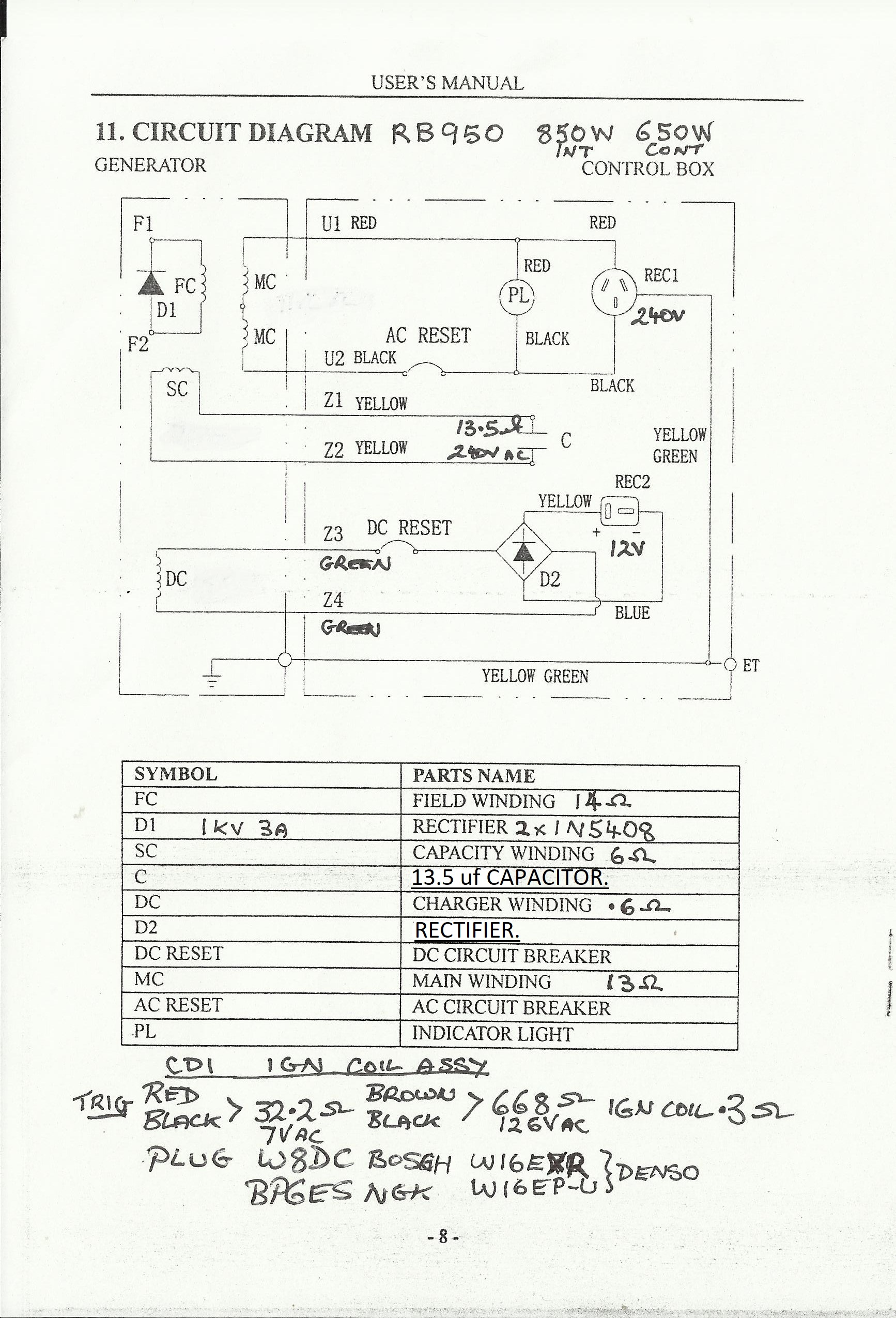

How does this generator work ?
With the gasoline engine running the yellow wires are your excitation, measure across the yellow wires.

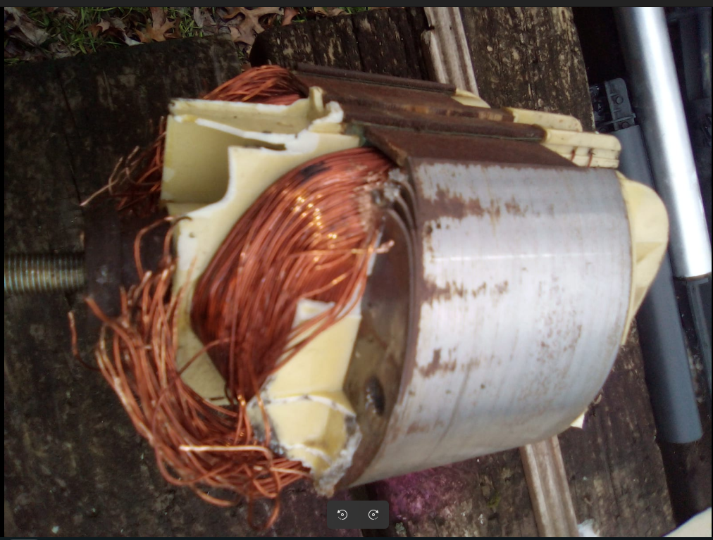

Generator section is defunct. Its fan shattered and destroyed stator and rotor windings. :arghh:

Well beyond economical repair. Unobtanium parts at robbery prices if found; and rewinding would be 10 times the cost. So am lurking for an used one to canibalize for parts... Its B&S engine surprisingly reliable, starting always at first pull...
But in curiosity, how is the rotor (field) energized ? Stator feeds the outlets and one capacitor.
Checked for any remnant magnetism and found nothing in the cores. Automotive alternators do have a 'steely' portion of the iron rotor that initiates generation. My strictly guess is the stator induced something towards the rotor but no evidence.
This is a circuit of a typical generator that you have. The output voltage is controled by the capacitor. Dfiferent values give different voltages, as also does diff
erent engine RPM. If the capacitor is open circuit you get no output voltage.

This is a circuit of a typical generator that you have. The output voltage is controled by the capacitor. Dfiferent values give different voltages, as also does diffView attachment 147818erent engine RPM. If the capacitor is open circuit you get no output voltage.
EXTRAORDINARY FINDING ! Thanks, debe ! :joyful::joyful::joyful:
Mine has no DC generation section; and did not find FC - D1 but could be hidden tied under insulation winding layers.
Outlet being 120VAC or 240VAC makes not much of difference in the working principle.
Perhaps some day I will learn the mystery of the brushless field excitation :) ... Faint earth's magnetic field acting on the cores ???

The secret is that you have a small generator, called the exciter, which rotates with the main generator's rotor field.

This the defunct rotor after its fan shattered and destroyed the windings... Has diodes hidden in plastic crevices but no magnetism at all. :oops:
