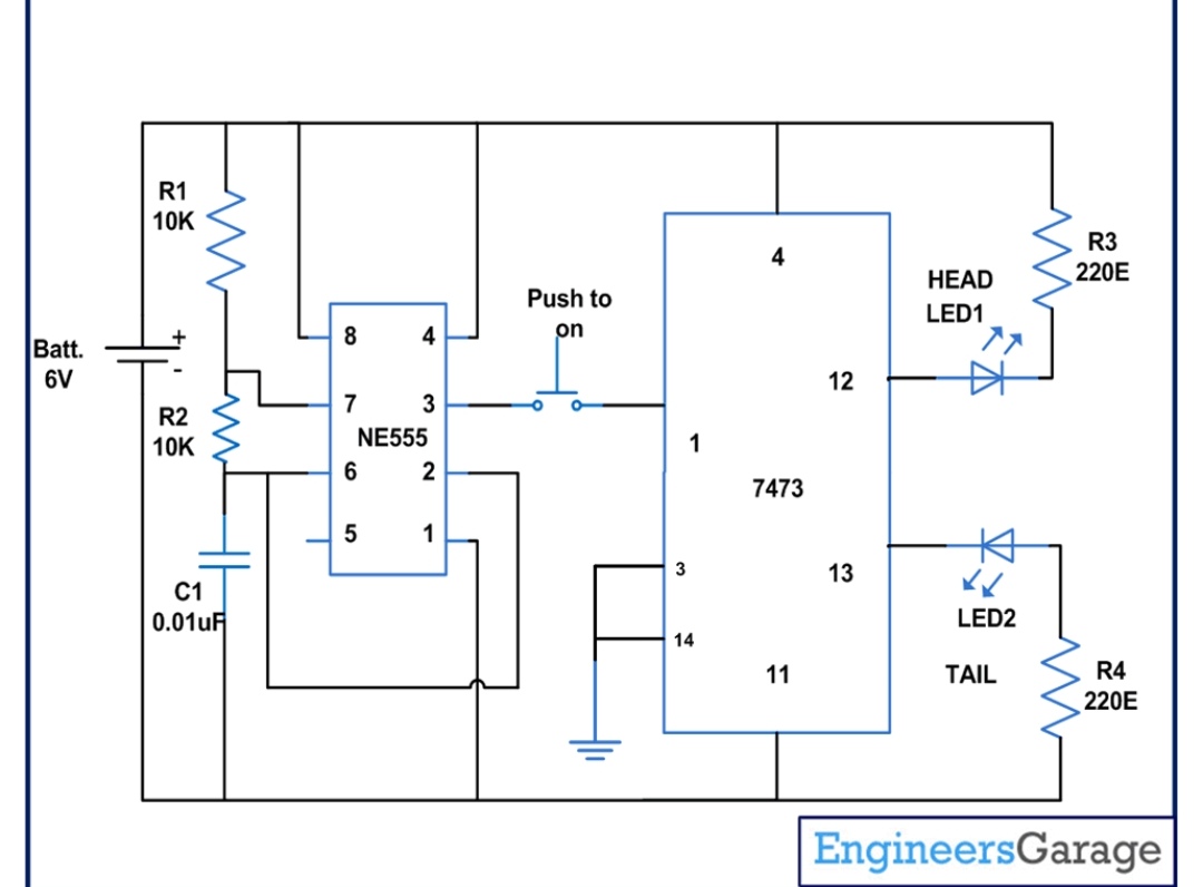

please help, i need this circuit to work :(
timmychangga
Is there anything wrong with this circuit? because it does not work in my breadboard i also tried it on proto but i seems like it is also not working. please help i really need it for my school :(
That is not a good design to copy for many reasons. TTL on 6V, etc
I think you want to which may be a 20 Hz toggle LED flasher.
make the change I said for pulling J=K=hi.

If using CMOS 74HC73, then you are advised to connect floating inputs with 10k to 100k to gnd. Whereas for TTL floating inputs are approx 1.3V and recognized as a logic "1"

use D or JK FF for registers , counters dividers.
>Circuits> Sequential Logic> counters> pick 1st or any, figure out how it works.
The schematic from Engineer's Garage has backwards LEDs and logic errors as if it was intentionally made wrong.
