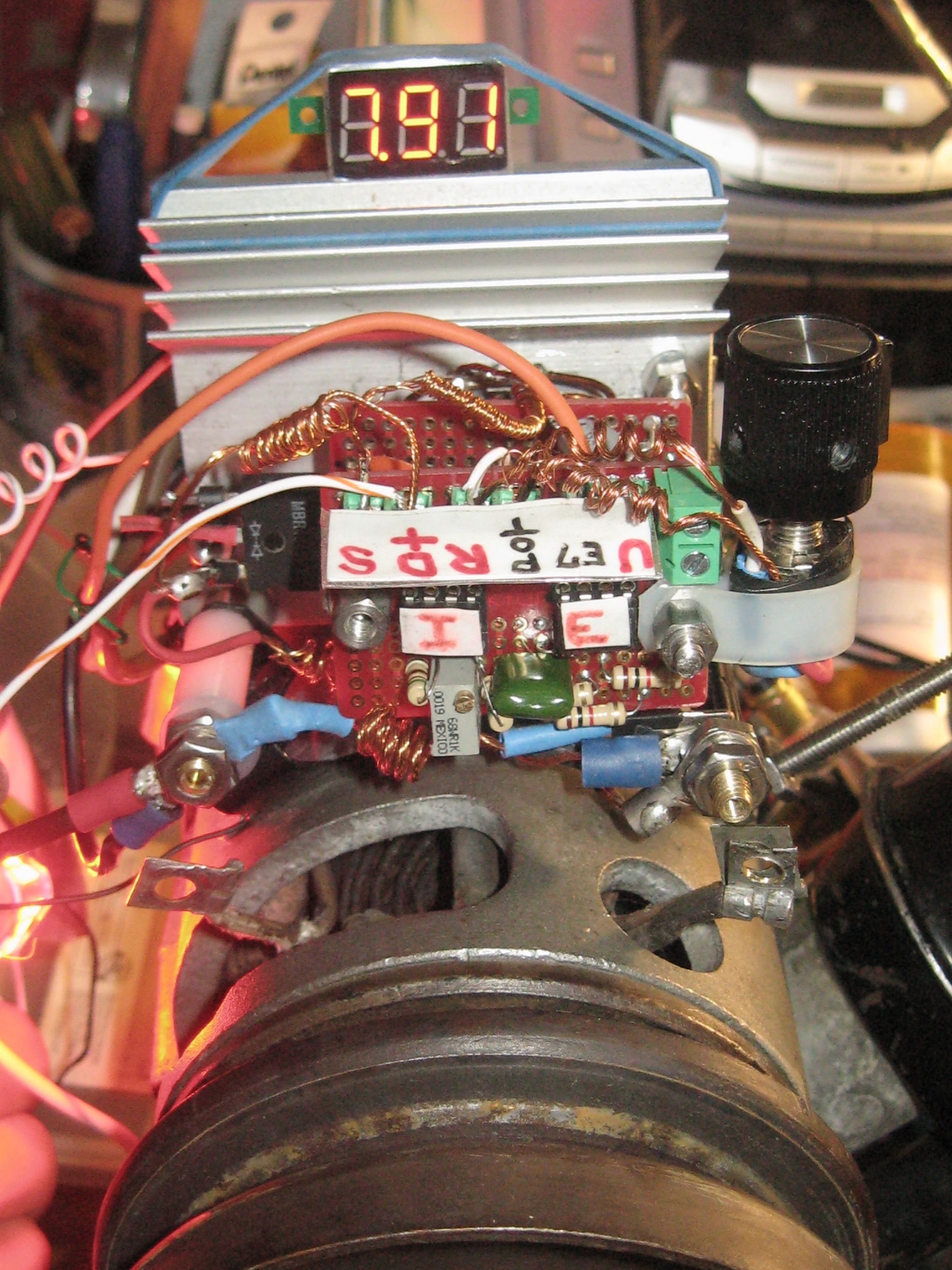

I keep thinking about the https://www.mouser.com/datasheet/2/827/DS_UJ3N065025K3S-1530382.pdf Jfet still. Mouser has them in stock at $15 each. Maybe I will send for one and try on the 6 volt generator. I just took the 12 volt gen off of my test engine and replaced it with a 6 volt gen to try the housed 6 volt Electronic regulator on.

Hello rjenkinsgb glad to see you posted. I was wondering about using a voltage doubler I have played with them a bit years ago but using 117 VAC. We need it to be fast to come up though! a few ms.
I could take another look at using the indicator light power to start it. I had it that way with the 1st prototype for a while it sort of worked and the Gen. light would just barely glow when on. (Isolating the internal supplies from D+ with the Oring Diode worked best for doing this but then the Gen. Lamp doesn't come on.)
The added connection to the cars ignition coil and Oring Diode with the MOSFET Design in prototype 2 actually works very well. And. That is on the car engine now.
Just mainly curious about using The 25m ohm Normally On JFET myself. Interestingly the 9m ohm Motorola MOSFET s I have been running will stay where I put them (On or Off) without a gate connection. Perhaps that could be used somehow.

The BU2508 should handle it mounted to the main heat sink used in prototypes 2,3 Prototype3.jpg or even the B+ terminal of a mechanical housing. (Probably will have to add a external heat sink anyhow to the B+ terminal to handle the main schottky barrier diodes).
I calclaste this circuit to pull 3.125 Amps through the BU2508 and drop 1 Volt across it directly into the armature (Calculated the 1.6 ohm armature resistance using its rating of 7 volts at 45 amps but it's DC resistance could be much lower I should measure that to make sure first.) The Lamp is something like 2-5 ohms cold 32 ohms lit. I have some 2.5 ohm varistors , one probably should be placed series with the lamp.
