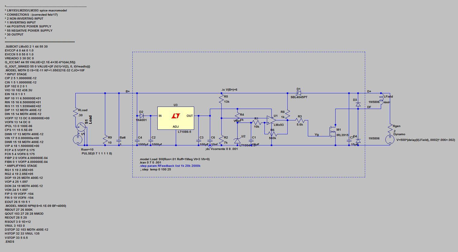

I am open to ideas, certainly worth checking out. The current through the field is less than 10 amps. One critical rating here is the "on ohms" Prototypes 2 & 3 use the Motorola HDT Mosfet which is only 8m Ohms of resistance when turned on. In (prototype 1) I used the IRL540 which had 77m ohms of resistance and it worked ok but the kick in rpm is higher with it.
Just calculated the (+-)15 volt supply loads above But didn't add in gate current. Any idea what that would be at -15 Volt? The leakage current is only 100ua and the gate ohms I think is just for High Frequencies. Not sure. The resistors and the gate diode in the "Prototype 4 Schematic" above use the JFET
UJ3N065025K3S limit gate current.
I read somewhere that P channel JFET's are not developed for high current applications. The 6 Volt Generator Regulator circuit needs the load to be on the Drain side. So I used the N-Channel MOSFET.

Will the JFet design overshoot because the Recom module startup is at too high a voltage? At a glance, It appears have an undervoltage lockout on the diagram for the module.

Found this, It may be the Schematic for a Bosch Regulator: Amazing how close it is to what we came up with.
Hi, your schematic is more advanced than the spice model one. It does not have current limiting :) As for your other query, I meant that from memory, the Recom modules have a minimum voltage before they start. As for the undervoltage lockout, I was mistaken. I now see the transistor and Zener near C1 are actually a voltage limit/regulator for ~5V.
The circuit will not be able regulate / turn off the JFet before the Recom module has started up and during that time, there will, as you said, be full output to the battery.
In practice, I am not sure if it would be a problem as it would be very short. one would have to see how it works.
But, in case of component failure, it will also overcharge the battery something terrible. It will likely fail ON instead of OFF.
So where does this leave us? I don't know.
One more notable difference between your design and the "Bosch" one, is that they have the diode D1 at the D+ side and the whole regulator circuit on the B+ side.
That will take the diode drop out of the equation and it allows the circuit to be powered before starting the engine.
Do you think that helps with eliminating the original problem we are trying to solve of it not starting the regulation?
My guess is that it will (if the battery is not too flat) but on the flip side, it will always sit there drawing some power from the car battery.

In hindsight, the easiest solution for a drop in replacement, no extra wire, will be to just move the diode from the output to the D+ side.
Like in that spice diagram.
Then the circuit will have initial power (in fact permanent).
It may need tweaking of the power consumption in the design a bit.
Just looked up the no load supply current to the LM311P it's (.4ma output Low) and (7.5ma Output high) the negative is (-5ma) so it's probably capable of operating in the off mode at .4ma plus whatever else you want to power off of it like the quiescent current of the LM193. (1 ma) Bosch uses a 5 volt regulator to run everything which uses 6ma quiescent current but it would draw that plus whatever load is on it's output. Looks like 7K + 13K that's say 12.6v/20K=.63ma some maybe the total for the Bosch Voltage Regulator is only 6ma + .5ma + .63ma + 1ma = 8.13ma .
