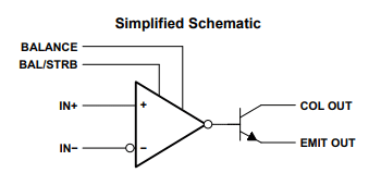

That should work, though I'd move the sounder to pin 7 rather than pin 1; the IC dissipates less power that way.

So on the LM311 alarm circuit it measured something like 16ma, not sure I understand why it would use more power with the load on pin 1 of the LM311, guess it has in internal resistor to ground on pin 1? But yes, I moved the voltage display and alarm circuit to the switched ignition voltage on the back of the ignition switch and hot glued the Piezo Sound Transducer to the back of the speaker grill behind the dash of the car.

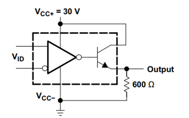

With the output on the emitter, the output stage is being used in "emitter follower" mode and the minimum drop from V+ to the output is over 1.2V as the last transistor is driven by another emitter follower plus further stages.
With the emitter grounded, the output transistor is the only device (other than the current sense resistor) in the output current path and the voltage drop is much smaller, so much lower internal power dissipation in the device, for any given load current; plus more available voltage across the load.
See the full internal schematic on page 10:
Thanks for the explanation. The LM311's I have test at about .47 volts on the Emitters as I recall. It's good to know though.
