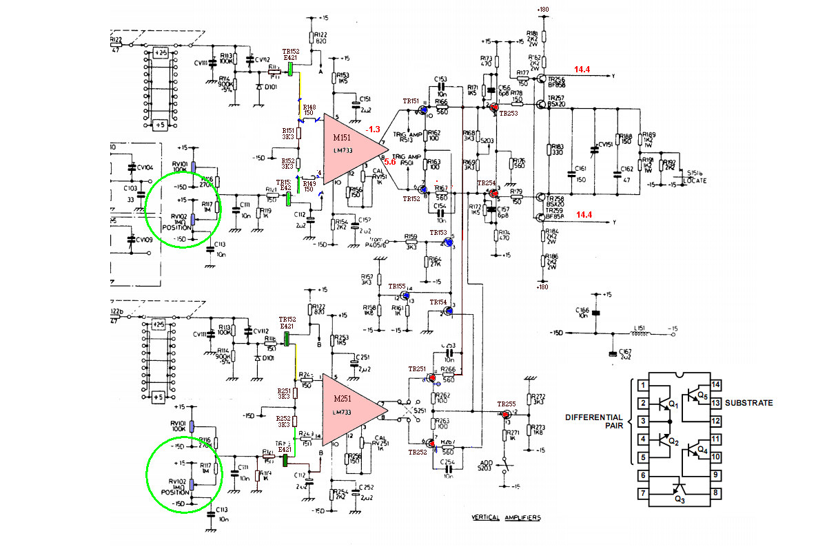

hi Al,
The green ringed POSITION pots on this dwg.
I hoping we havnt cooked any of the power resistors on the Y1 plate drivers,, we will see.
The rough finger sine wave sounds promising, what about the probe test.?
Ignore the old voltage readings on this dwg, I have used an old dwg.

Hi Eric,
I have been studyingb the drawing for almost 2 hours now and cannot find RV102 or R117 that feeds it. Can you point me to it?
Also I notice on the schematic you marked that there is RV102 with adjacent RV101 fed from M151 and below there is an identical RV102 and RV01 but this time fed by M251, are there 2 pots or one, and is it RV101 and RV102 I need to adjust or does the schematic confusingly show a sinle RV as 2 parts?
Truly baffled............Al
Hi Eric,
It appears that RV101/102 are duplicated as are R116/117 and C117.???:confused:

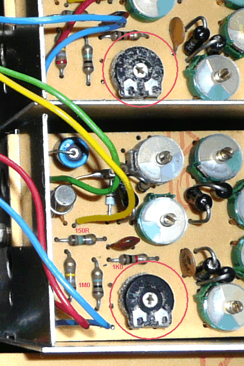

Do you see the 150R on the Gate of each FET, can you trace that bit of track back to the pots.
I dont think you sent me any photo's of the RV101/102 board layout.
Do a shot of the underside of the pcb near the 150R's
hi Al,
I believe it must be these black furry pots.
Make a small pencil mark on each pot, before you try to move the trace.
It appears that there is only 1 pot/trace.

Al,
Look at my 14:40hrs posted image, thats the ones Im sure, just adjust them slowly, watch the traces as you do it.
Dont touch the ones in your pics they look like CAL pots.
Result!
Hi Eric,
You were as usual spot on! I now have both traces centred with the knobs centred.
