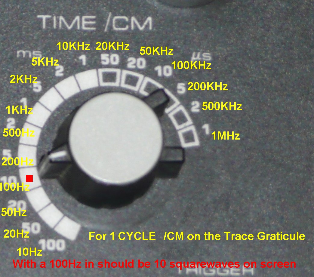

The scope is working to some extent, but I'm puzzled about something.
I have made a small square wave generator that can go from 1hZ to 100khZ in decades. When I measure the wave I only get the horizontal lines you see in the picture I took. I always thought and expected to see the whole wave, that is an unbroken line made from vertical and horizontal sections!
The square wave was set at 100hZ in the picture. As to the settings of the scope I am puzzled as the Time/CM knob has 1 to 50 uS, 1 to 5 mS and 1 to 100 ?S So I don't actually know what the three sets of numbers denote, as I said two are marked up but the third is baffling me!
Eric, you have a HiRes picture of the controls, could you clarify for me?

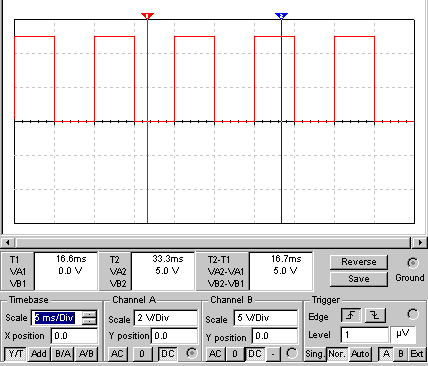

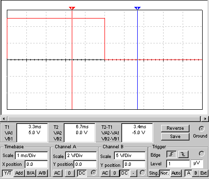

You should convert Frequency to time. The formula is 1/frequency, or in your case
1/100Hz = .01 sec which is 10ms. So to see 1 cycle you would set your time/div to 1ms (This is because graticle is 10 divisions 1ms each) With scope set to 5ms/div you would see 5 cycles, assuming you indeed are measuring 100Hz. See attached pics.
If you still see no waveform make sure your volts/div is like 5v, also verify your waveform gen is working.

hi Al,
The TIME/CM control sets the speed of the spot that produces the trace on the scope screen.
The visible bright spot moves across the screen from left to right, the spot is blanked [set dark]
and quickly flys back to left side of the screen.
When the TIME/CM is set to 1uSec, this means the spot travels 1cm/uSec from left to right,
so with a scale of 10cms it would take 10uSec to move to the righthand side of the screen.
In order to see a 100Hz input signal on the YA or YB inputs, set the TIME/CM to 10mSec,
this should give 10 square waves across the screen.
If you now set the TIME/CM to 1mSec you will only see 1 square wave.
In cases where you are not sure of the waveform frequency you are scoping,
just click the TIME/CM around until you see a recognisable waveform.
By knowing the speed of the trace spot and noting the peaks/troughs in the waveform
you can work out its frequency by counting cms at that TIME/CM setting.
OK.?:)

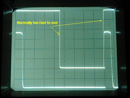

Hi Bigal scorpio,
I think I know what you mean.
You can't see the vertical step because the step is too
steep with respect to your timebase setting. Very few
electrons reach the same spot of your screen with respect
to the distance the trace traveled.
The only thing you can do is increase the intensity (a bit).
The top trace was the input signal from a function generator
(I think), If you look more closely you can see that there
is something visible. The bottom trace is a mosfet switch,
it switches on very rapidly but needs more time to switch
it back off. You can clearly see the difference in intensity.
The dimmer a trace is the more quickly it moves on your screen.

EDIT:
Added the 'missing' fast invisible edges on1aag image, to show the ideal scope trace.
Hope you don't mind on1aag.:)

Do I feel stupid or what! The THREE sets of voltages I mentioned are only two! I never noticed the decimal points before! DOH!
Anyway thanks forn all the input guys, its made me feel a lot happier about the scope. on1aag was right about my concern and Erics photo retouching was the clincher, thats what I was expecting to see and never having the scope working properly before it made me wonder if it still had a problem, but thats all sorted now. :)

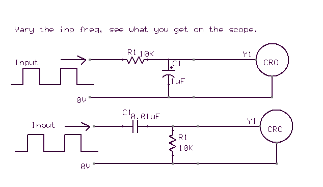

hi Al,
That ESR Wien osc output should a good sinewave.
I would like to know what you get.
also a low voltage mains transformer, say 5V thru 24V would give a 50 Hz sine.
Connect a microphone, set it to 5mV/cm and you should see your voice.
EDIT:
try these two common type of circuits

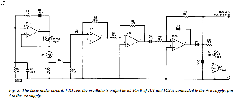

Hi eric,
Just realised that the wave I'm getting is only 0.5v P-P!
The author mentions 5v P-P but that is when testing with the MM, is the scope test in a different place?
Am I measuring the output at the right place? Clip on 0v (between batteries) and probe on pin 1 IC1.
Is this correct?

hi Al,
Whats the battery voltage.?
Where are you measuring the wave.?
Do you have the probe switched to *10 ?
What setting is the YA amp on.?

Hi Eric,
I'm a complete ^%^%$^^&!
You were of course quite correct :eek:
These new fangled gadgets take some getting used to! ;)
Al
