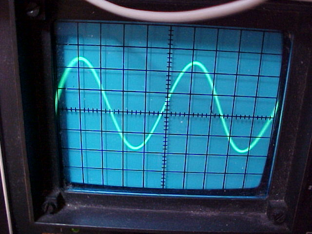

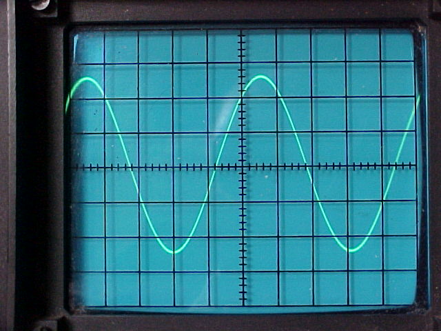

Hi Eric,
Pics of my lovely Sine wave. :)
Al

hi Al,
Thats a nice sinewave, a Wien osc when set up correctly can produce a pure sinewave, which is essential for measuring the caps ESR.
Cant wait to see the next project you mentioned.;)

hi Al,
This is the pdf you PM'd for.:)
Nigel,
Looking back thru Al's picture postings of the Wien trace, it looks like 200KHz rather than the 100KHz in the design pdf.
Al's checked R1/C1 and R2/C2 OK.
Wondering if his Scope X Time base may need confirming.?

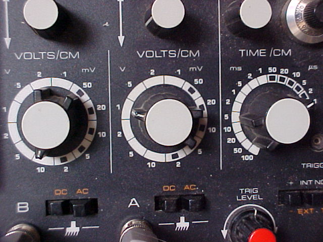

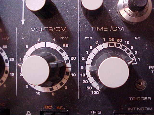

Hi Nigel and Eric and all,
Tell you what guys I'll do the test again and note the settings exactly. :)
Al
Here they are guys settings 1v/cm vertical and 2uS time/cm.
Think Nigel was right, it was set on 2uS the first time.
Al

hi Al,
Thats good, As they say 'If in doubt, Ask.!'
hi Al,
I don't know about you Eric, but I've used scopes in the past where it's difficult to read the exact setting, even with the scope in front of you. I often resort to turning the knob fully to one end, and counting the clicks back :D
No such problem on my Grundig scope at work, it has a digital timebase display, and auto-setting timebase, with manual override (buttons to step up and down).
