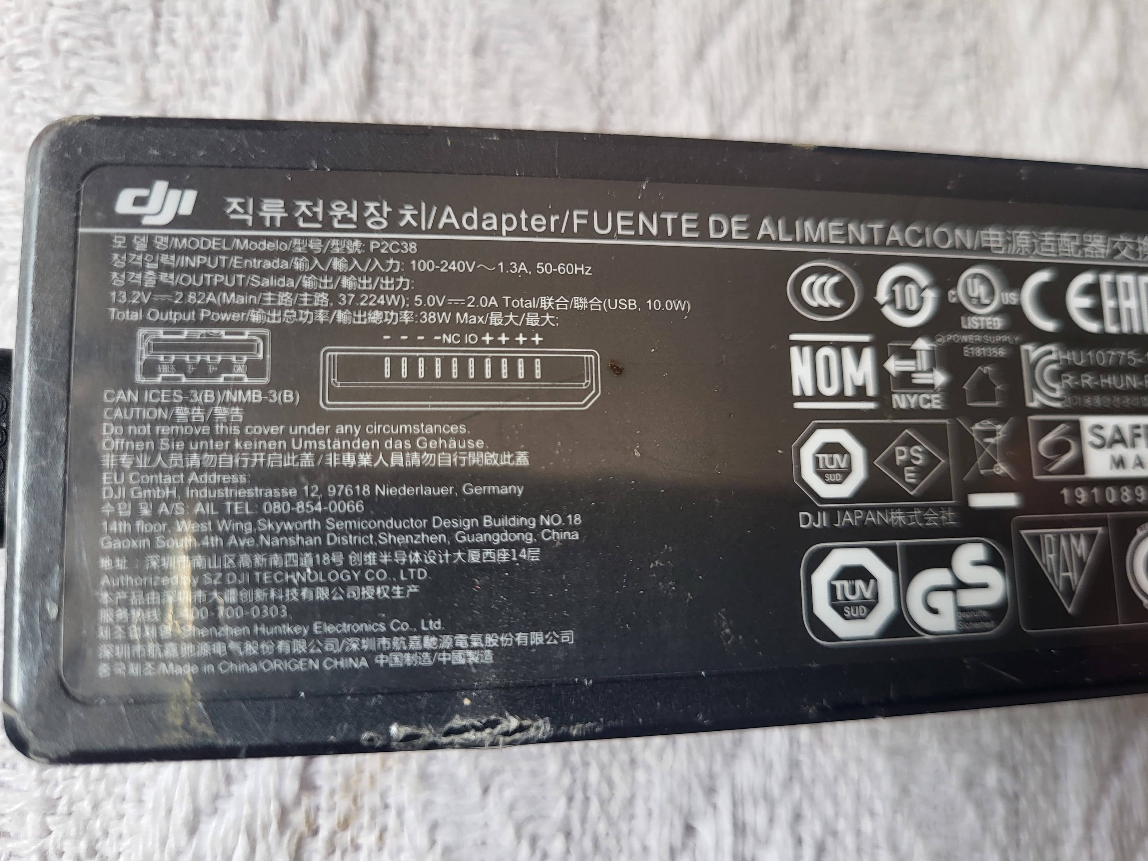

Can I charge my Pocket 3 with this charger?
FoxAdriano
I recently got the DJI Osmo Pocket 3 (small Camera) but I don't have the charger.

But I already have a DJI charger but I can't figure out if I can charge my Pocket 3 in the same way without damaging the battery. I attach the photo of the Specs of my Charger which is always DJI.
Can you tell me if I can do without spending more money?

But the charger they advised me to buy is not PD, maybe I'm wrong?
Anyway, this morning I received the charger that works with PD.
It's this:
In your opinion, with which specific USB port should I charge the Pocket 3?

PS: But I hope that the battery of the Pocket 3 charged with the charger in the photo will not be ruined. Maybe in an emergency I could use that. Right?
Any USB-C charger that lists different output voltages is a "PD" one, in general.
For the PD one you have, any USB-C port should work; I can't see the camera needing particularly high power.
(There are, rarely, dedicated chargers supplied with a device that can only output some odd voltage above 5V - those should never be used with anything but the device they were meant for. It's an abuse of the USB connector as those should always default to 5V, unless and until the device being charged requests a higher voltage).
