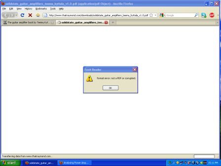

I tried downloading it MR Goodwin but it was corrupted and cant open up......................................
It worked for me in Adobe.
What OS are you using?
I've converted it to a low quality compressed monochrome multi page TIFF file and zipped it so hopefully you'll be able to read it.
The file is much smaller but it is lower quality.
I'm having problems uploading it, perhaps it's too big? I'll try hosting it somewhere else or splitting the file.
i tried again... it cant download.
Why not just download the latest version of Adobe Reader?
