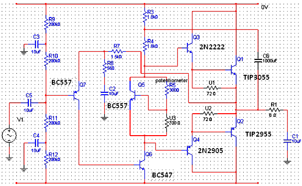

SPECS given: 50v single negative supply, 8ohm load, single transistor input

Many of the transistors will not survive a 50V supply. Select transistors with a higher voltage rating.
C3 is not needed. Then R9 and R10 can be a single resistor.
Q7 needs a load resistor which will help turn off Q6 quickly.
The output transistors need emitter resistors.
The value for C1 is far too small and for C6 is far too large.
The circuit will probably oscillate at a high frequency because it is missing the compensation capacitor that is used on all audio amp and opamp circuits.

Q6 needs a compensation cap to roll off the gain above 25khz or so as AG has said. Q7 needs to be able to sink the base current of Q6 to ground, and cannot do that as-is. your bias pot should be on the emitter side of the Vbe multiplier, not the collector side. if the pot should fail (not real common, but it does happen) by going open circuit or by the wiper going open from dirt or oxidation, the bias transistor will turn full on, shutting down the bias on the output devices. the amp will still work with some crossover distortion. if a collector connected pot goes open, the bias transistor goes open circuit, running the output devices at or beyond their max current and they will short, and take the driver transistors, and Q6 and possibly Q7 along with them.
you might want to move C6 to where R1 is, R1 to where C1 is, and C1 to where C6 is. the bootstrap cap doesn't have to be very large, but the speaker coupling cap has to be large, and it's best not to have speaker terminals that are live with DC voltage (but designers of class D bridged amps do that all the time without it being much of a safety hazard).
btw, this amp will have a pretty hefty turn-on thump through the speaker when it's turned on, so realize when it does that it's normal for this type of amp.
Don't use Word for schematics, use PNG.
There doesn't need to be two capacitors in series with the speaker: C1 isn't needed and will just limit the frequency response to 2kHz.
C1 is needed to block the 25VDC from this single supply amplifier. It should be about 1000uF for -3dB (half power) at 20Hz into the 8 ohm speaker.
Yes, you're right, I misread the schematic.
The circuit will not work at all because the -50V and 0V lines have no DC connection to ground except through a pair of 200k resistors (R9, R12). The 8 ohm load is returned to ground so all its drive current must flow through these two resistors.
It is not possible that 0V and ground are the same as this would short out R9.
[edit] I didn't notice C3 and C4. There is NO connection between the power rails and GND.
