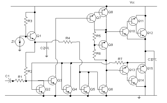

Another Circuit
I welcome any views on this circuit....

Alright, no more weird circuits....Im curious as to the effect of Q7-8 in the circuit?Does anyone know whats its purpose?
Q7-Q8 is a darlington pair connected to the collector of Q3. In the case that Q3 conducts anything, Q7-Q8 slams the output drivers against the Vcc rail producing a square wave. If C3 is the right value then Q2 will try to cut off the base current to Q3 and it will be an oscillator but its stability depends on R7. If Q4 is the right geometry then it will provide some compensation to Q2. But Q5 and Q6 are a current sink and maximize the voltage gain of Q7 and Q8 so they provide the best possible square waves.

So now i would like to know if the reference voltage circuit is better in the last circuit posted compared to the weird cct?

In your last circuit, there was a voltage reference made form Z1 & Q1, which might be the only functional part of the design. But it has no compensation for temperature.

What do R6 and C1 do?
