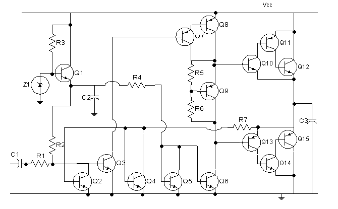

What is effect of Q7-8 in the attached diagram?
is the voltage bias for the VBE MULTIPLIER = VBB = 2 x ( VBE Q10 + VBE Q12)?
Q7-Q8 is a darlington pair connected to the collector of Q3. In the case that Q3 conducts anything, Q7-Q8 slams the output drivers against the Vcc rail producing a square wave.
As we've told you repeatedly, that 'circuit' is completely nonsense - it wouldn't work, so they have no effect.
The circuit consists of stages that are used in the design of a Power amplifier.
input, driver and output stage.
And those stages comprise of sub-circuits
eg. output stage: composite transistors (Darlington & Sziklai types)
driver: VBE multiplier and current source(current mirror, bootstrap circuit)

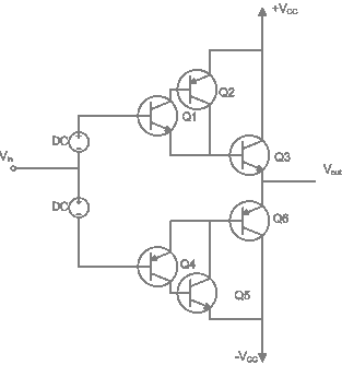

So if I attach a diagram of a sziklai darlington configuration and ask you what it does....your response is going to be
Because its not in a "functional" circuit.
But there is so much that can be said about that diagram.
I think you shouldn't reply at all to my thread if you dont want to help.
Your output circuit is missing important resistors that quickly turn off the transistors.
It is also missing emitter resistors for the output transistors.
Audio amplifiers do not use 3 transistors in series on each side. They use a darlington pair or a Sziklai pair.
That circuit uses both a Sziklai and a Darlington.
Q1 ans Q2 from the Sziklai which is in Darlington with Q3. I've never seen this before, it mush have a very high input impedance and a high voltage loss too.
I've no problem with that part of a circuit, but as already mentioned by someone else - it's a non-practical example out of a text book - check the Amplab link I posted earlier that shows the rest of the parts, both of the output stage, and the rest of the amplifier. A Sziklai is just a different kind of darlington.
Here's the actual link to the Sziklai version, note there's 8 pages in the project, showing three different output stage versions:
Sziklai - Complementary Feedback Power Amp Output
Forums are an historical record - if we let you post complete rubbish and designs that are wrong in every respect, we're going to get people trying to build them. There are hundreds (if not thousands) of working designs on the net, why not pick one of those?, or at least look at them, and compare them to what you keep posting.
Yeah you are right, to make that diagram practical would include the principle addition of base emitter resistors which would assist in turning the devices off & also bias stabilising resistors in series with the emitters of the two power transistors Q3 & Q6 to reduce thermal runaway

Whats the VBB required by the VBE multiplier ? What components make up the VBE multiplier? All these questions have answers which can be obtained from the diagrams posted.
What does VBB mean? The voltage from a Blubber Belly?
R5, R6 and Q9 form the Vbe multiplier.

you also invalidated the current source by putting a capacitor across it's output...
using a darlington as a VAS stage is NOT a good idea. first of all you are still missing a compensation cap in the VAS. with a darlington as the VAS, your compensation cap will have to be much larger than normal. all you have right now if you were attempt to build this would be a radio transmitter for a few seconds, then a smoke generator.

its the bias voltage, its standard terminology used when dealing with a VBE Multiplier.
You showed me what the VBB was equal to on that diagram posted on another forum site.
VBB=Vbe1+Vbe2=total vbe for that diagram

Any comments on the reference voltage in the diagram?
previously you posted you got it off a South African Uni site.
This explains it. Whoever designed the circuit had spent more time smoking weed than studying electronics. Or perhaps they designed it while smoking weed.
lol, i believe you. I was standing in a lab and then i saw this guys circuit smoke & he wasn't even aware :D.

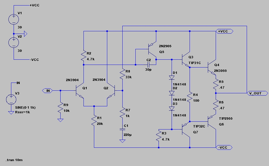

actually the reference voltage for the current source was better when you had the two transistor current source. if i were you i would scrap this whole design, and start off with a simple Lin topology amp and improve and optimize that one this single ended thing with the whacky current mirror VAS is not going to work very well if at all....
here's a simple amp with loads of room for improvement and tweaking. i "built" it on LTSpice in about 10 minutes, and it ran on the first try with no tweaking of component values. there is a lot of room for improvement on this design, and they're all performance tweaks, not changes to just get it working. but as-is, the amp has 0.1% distortion at full output into 8 ohms.
(edit) actually i did have to tweak one component, the compensation cap C2. when i added an 8 ohm load, there was a very small (less than 100mV) 1Mhz oscillation at the output. it was easily cured by changing C2 to 50pf
