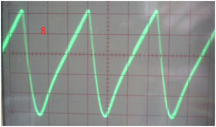

the amp originally had an input of 100mVp-p and an output 3Vp-p with a frequency of 1.5KHz but now whenever i put it at the same settings its output is 4Vp-p{What would cause this change?}. So i used the 4V p-p wave in the following test:
pic 8
output set at 5V/div
frequency 1.5KHz
The amplitude was adjusted to determine the peak output voltage. From PIC 8 it can be seen that the output=25Vp-p.
is it correct for me to use PIC 8 to determine the peak output voltage?

I don't know why the output has very high distortion. Maybe some of the electrolytic capacitors are still connected backwards.

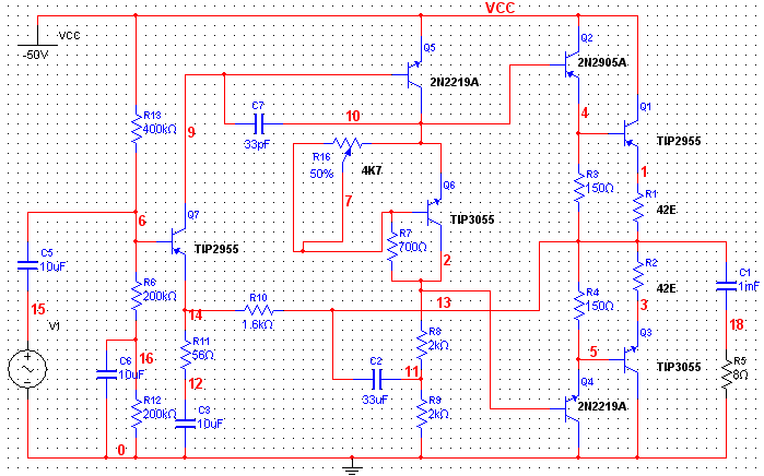

Post your latest schematic.

the output capacitor was fixed on the kit and was 4700u not 1mF as on the diagram, the bias stabilising resistors R1 and R2 were also fixed on the kit and were 42E as on the schematic, not all transistors were available so i had to use the type on the schematic
i pointed all the positive terminals of the capacitor to ground and all negative terminals to the -50V supply

you used 2N2955 and 2N3055 as input and bias transistors?????????????? why?
the input transistor needs to be a bit faster than a 1Mhz device.... the Ccb is around 100pf in that input transistor, way too high for what you're using it for...
it'll work, but you would be better off with a 2N2905 as the input transistor and a 2N2219 as a bias transistor.
are you sure your compensation cap is 33pf and not 330pf? it's an easy mistake to make especially since the value marking of some manufacturers is a 3 digit code, where 330 would be a 33pf cap (digit, digit, multiplier), and 331 would be a 330pf cap, and other manufacturers mark a 33 on a 33pf cap and 330 on a 330pf cap. the best way to tell the difference is to measure it.
with a 330p cap instead of a 33p cap you will get slew rate limiting at 1khz and running the output voltage almost rail-to rail just as your scope trace shows
Your amplifier won't work properly with R15 removed. I said before that it should be about 10k ohms.
It also won't work with those wrong transistors.
the guy from stores gave me a flat yellow cap with no markings on it and said it was 33pf but later i realized that the cap value was higher and replaced the compensation cap with 33pF
yeah but i had to use those components since stores didnt have a good substitute.
the 2955 hasn't enough gain to act as an input transistor (it will work, but not work very well). and using a 3055 as a bias transistor doesn't seem a bad idea at first, because it can easily be mounted to the heat sink and and would provide very good thermal tracking, but the large surface area is also a large capacitance to ground in a part of the circuit that should be a high impedance node (this part of the circuit is bootstrapped to increase the impedance).
Quite the opposite, it will provide poor thermal tracking because of it's large mass, so it would track very slowly and poorly.
No, it's bootstrapped to increase current drive during peaks that side - bootstrapping is used to increase impedance on input circuits, not on this.
In addition to increasing the voltage peak, the bootstrapping makes the collector resistor appear as a higher resistance which increases the voltage gain of the transistor.
Yes, but that's not it's main reason - without bootstrapping or a constant current source it makes a pretty feeble amplifier, much higher distortion and much lower power.

two sides of the same coin, actually, increasing the impedance and increasing the voltage swing.
a current source is probably out of the question as the OP's local parts shop seems severely limited in their supply of suitable transistors.
