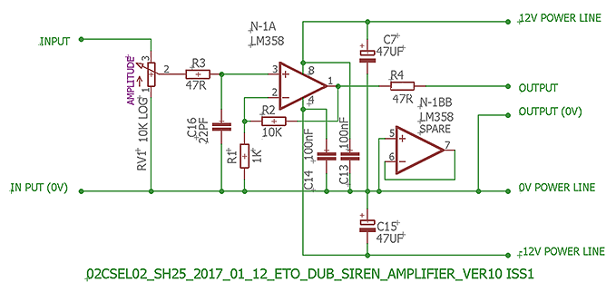

Below is a schematic which you may like to try. The values of the capacitors are not critical but the two 100nF decoupling capacitors should be ceramic or polypropylene types and need to be mounted with short leads and as close to the opamp supply pins as possible.
Also if you can make the layout follow the layout indicated on the schematic that will help prevent oscillations. The order of the 0V line connections are particularly important.

Wow, that was fast! Cant wait to test it. But can I use 1nF instead of 22pF? Only one I did not have. Thank you very much!
No probs Rorut,
No, afraid, 1nF is too big- just leave the 22p capacitor out.
The 47 Ohm resistor and 22p capacitor do not have any effect on the fundamental operation of the amplifier. They just form a low pass filter to keep out high frequency signals in the air: radio, TV etc. I once made a preamplifier that was an excellent radio receiver.:D
Likewise, the 47 Ohm resistor in the output has no effect on the functioning of the amplifier. It is just there to isolate the amplifier output from any capacitive and inductive loading on the output. This also helps to avoid frequency instability and other unwanted effects.
This amplifier is DC coupled so we can test the gain at DC.

Hi Rorut,
I was thinking that you would be using two 12V batteries. If so, call the batteries battery #1 and battery #2 and do the following:
(1) Connect the negative terminal of battery #1 to the positive terminal of battery #2.
(2) The junction of the two batteries will be the OV POWER LINE to the circuit.
(3) The positive terminal of battery #1 will be the 12V POWER LINE to the circuit.
(4) The negative terminal of battery #2 will be the -12V POWER LINE to the circuit.
Connect up the batteries separately from the circuit as a power supply and run three wires twisted together to the circuit. Make the power wires a decent thickness and no more than about 12cm long.

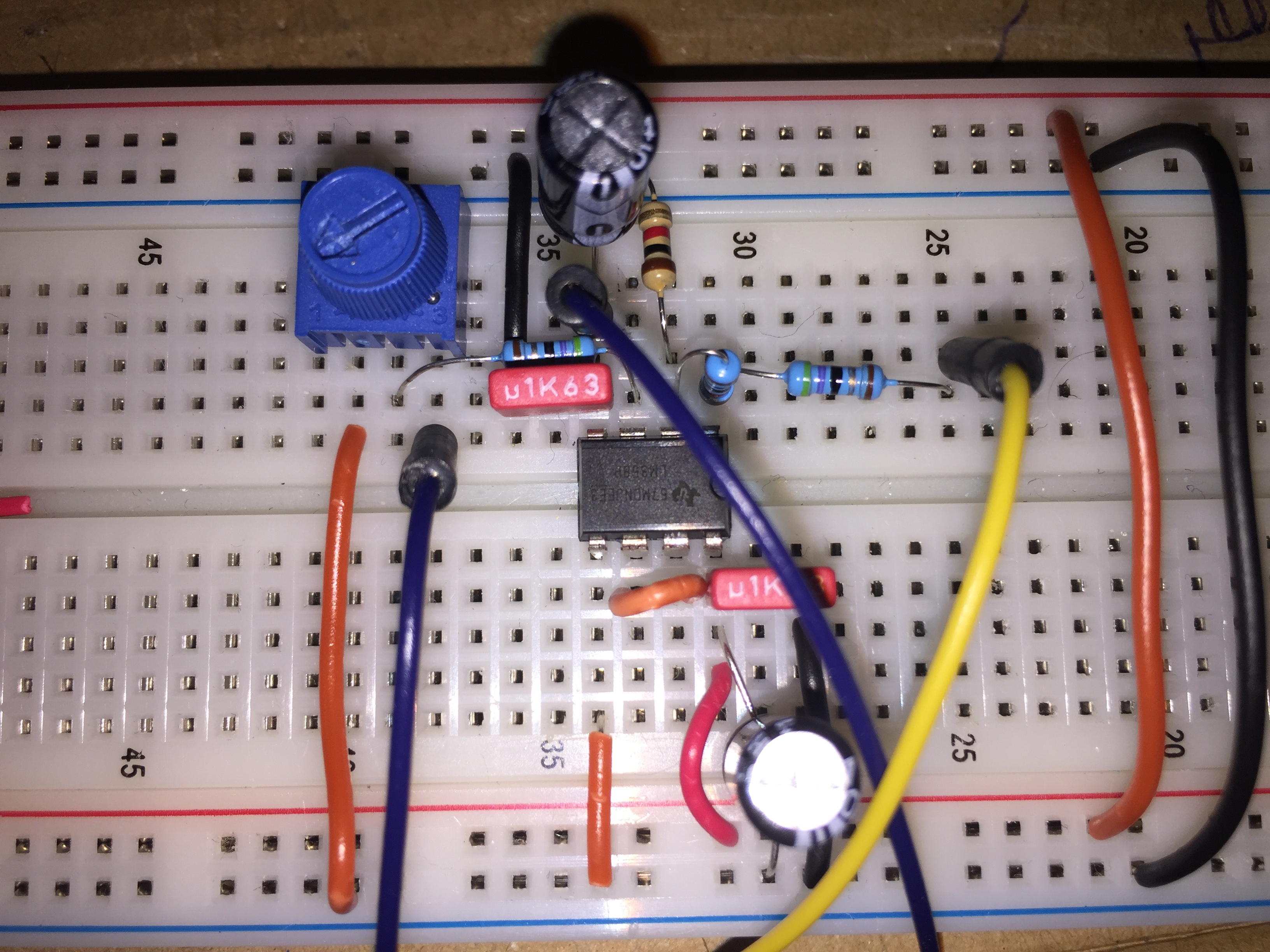

Domt know if I did any progress in breadboarding but tried to keep the components closer :)

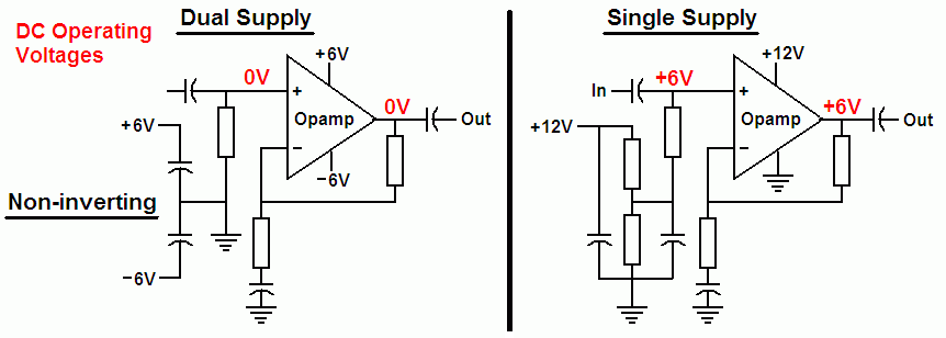

The circuit in post #101 has a gain of only 1+ (10k/1k)= 11 times which is not much. Increase the value of R2 for more gain. The input pot is a volume control, not a gain control. It is easy to properly bias an opamp so that it does not need a dual polarity supply.

That looks better, but breadboards are not really suitable for high-gain or high-speed circuits: afraid it is simply a physical thing.
Spec told me to stay with value for R2 and that in theory it could be changed to increase. I dont know why? Stability on breaboard?
R2 is a feedback resistor which connects to the inverting input of the opamp and thus forms a feedback loop.
Feedback loops can oscillate if reactive components: capacitors and inductors cause phase changes in the frequency response. Stray capacitances coupled with a high resistance cause the phase change to be more troublesome. Sometimes you put a small capacitor in series with with the feedback resistor for this reason.
By the way the inverting input of an LM358 plus stray capacitances caused by the wiring etc probably mount up to 10pF to 20pF.
