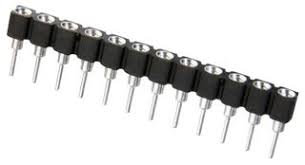

IC socket strip, turn pin, 40 way. [$1.00] (cut to suit chip package)
