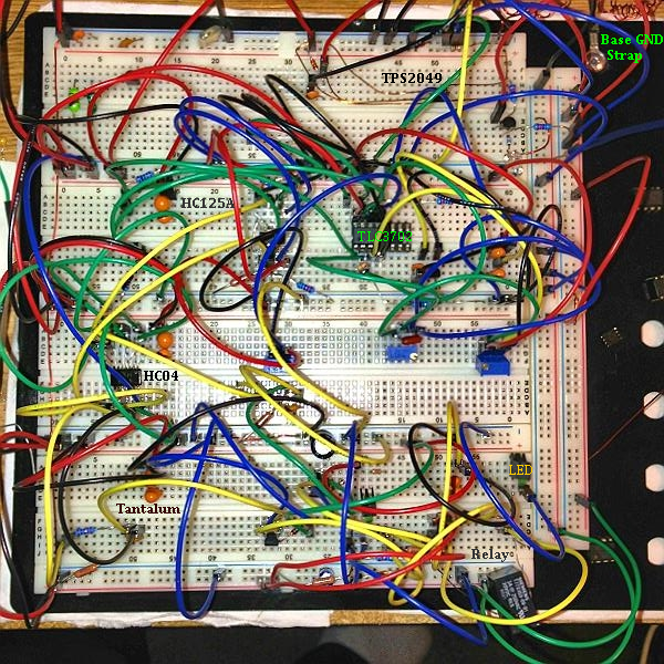

Not At topic, Ideal towards Breadboard issues, The small change effect of the audible output sounds just like the Driver op is acting like a voltage follower on its output. may want to connect the common pin as close as possible to the GND pin and use a capacitor (10-22uF) at the positive pin with the common for the capacitor connected at a primary rail on the bread boards GND, the tracts on the boards often show quite the loss in communication of power flow, even in the same connected row. Also the board I've shown in the attached image has a metal backing with a GND strap to the 5V supply main GND connection.
Solderless Breadboard? Those can be quite annoying to properly ground, The jumper wires often result in current sense effect much like battery chargers use to shut off when batt charged ect. A digital multi tool if avail with some form of self protection built in for a just in case method. Resistance mode auto range or standard low Ohm value. If the circuit is operational in the stable sense (nothing going obviously wrong) and powered on, place the Common test lead to the at most GND point connected to the Breadboard from power supply, then the red test lead at several GND common points only and observe the reading, if well over 4-8 Ohms, that's quite a loss and can cause the components to have a "soft" common resulting in odd behavior. Avoid connecting the red test lead to positive power as applied to the test tool in resistance mode can cause damage to some testers, use caution! this is just an example image of a board using an LinCmos push pull comparator with an LMT84 temperature sensor as the driver and the hassle of wires and multiple common jump points all across the board. Avoiding voltages above 15 Volt for many meters when testing for common losses in resistance mode this way.
Hope this is somewhat helpful (for bread boarding if not all ready known)

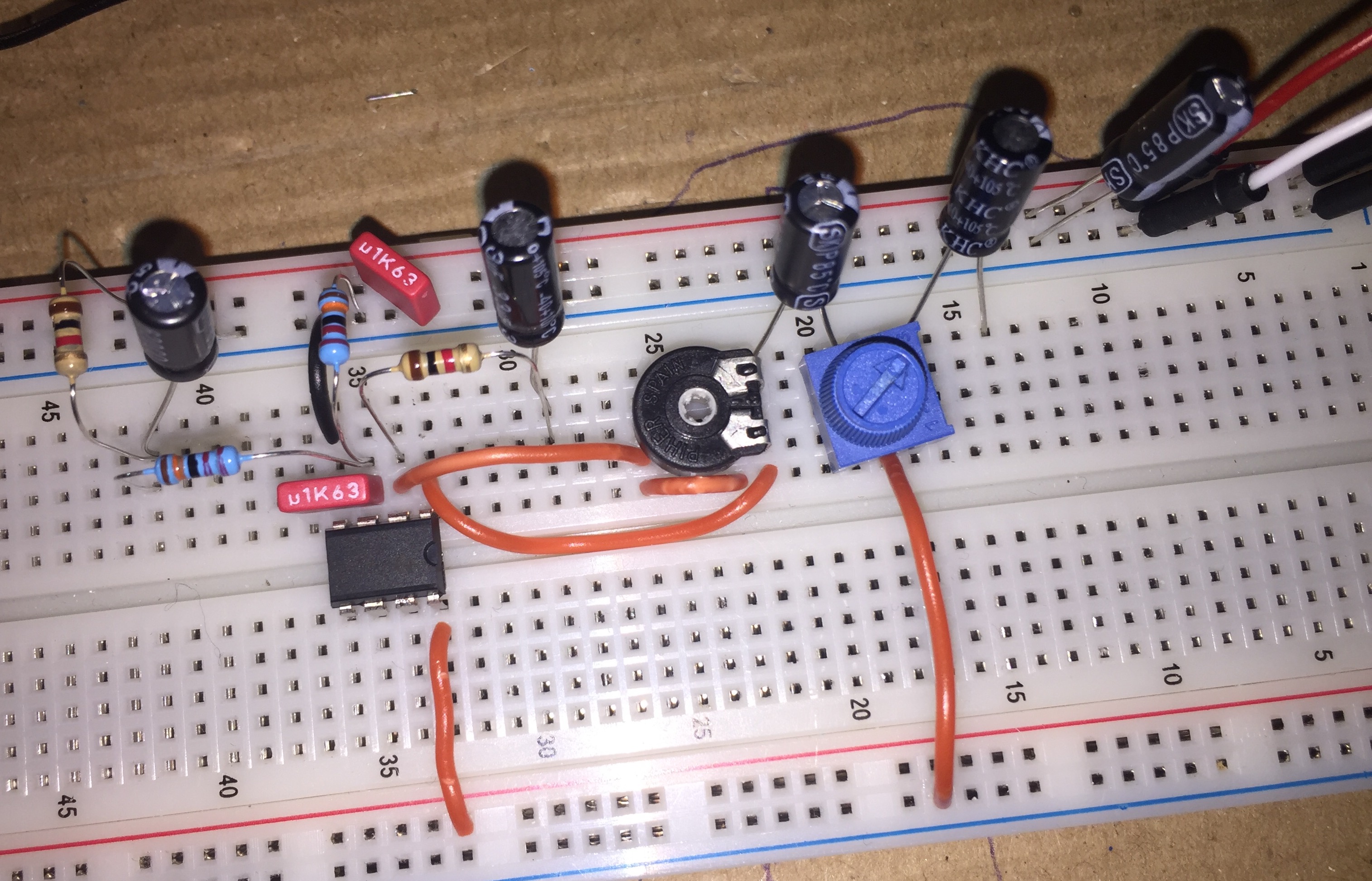

Looks like this now (whitout the resistor, diode, capacitor-thing)
still no luck with the potentiometer (gain). Tested two pots same with both.

Hi again Rorut,
I see that you have only wired up opamp A of the LM358.
The other opamp, opamp B, needs to be put in a defined state.
Can you,
(1) Connect pin 7 to pin 6
(2) Connect pin 5 to 0V
The color bands on the blue resistors look odd on my laptop. Are the resistors actually 220K Ohms?
spec
I am suspicious of the 4.7uF capacitor. It almost seems as though the 4.7K capacitor is not connected or open circuit.
Can you check connections and replace the 4.7K capacitor.
