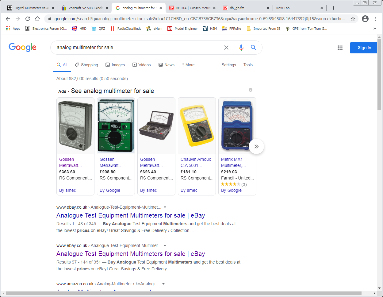

Googling "Analog multimeter for sale" produced this:

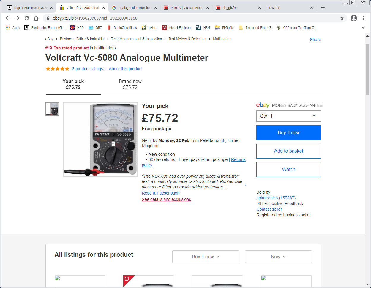

Looking in to Ebay produced this:
The Vc 5080 looks like a reasonable meter, but I have no direct experience.
