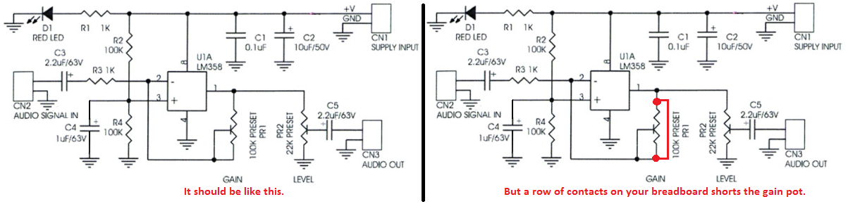

You have a row of contacts on your Mickey Mouse breadboard shorting the gain pot:

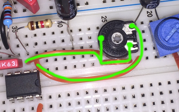

No, it only looks that way on the picture (above, you cant see the pins). The pins on my "mickey mouse breadboard" are at separate rows, on pin is bent and placed alone in its own row. I can take a picture later to show you if you want.
Thanks anyway!
(Should have rotate it 90 degrees instead of bending the pin)
Is it wrong connected like its shown in the picture?

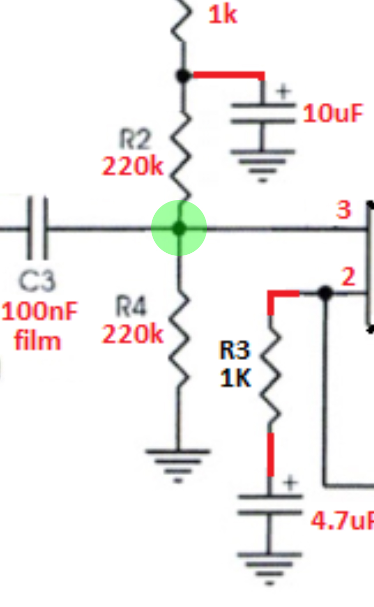

The color bands on the blue resistors look odd on my laptop. Are the resistors actually 220K Ohms?
spec
I will try this after work later today
I am suspicious of the 4.7uF capacitor. It almost seems as though the 4.7K capacitor is not connected or open circuit.
Can you check connections and replace the 4.7K capacitor.
spec
Im using a 33uF. Negative on cap is connected to ground.

Unbelievable. A sneaky pin of the pot snuck under the pot to a different row. Maybe the pot has a very low resistance?
