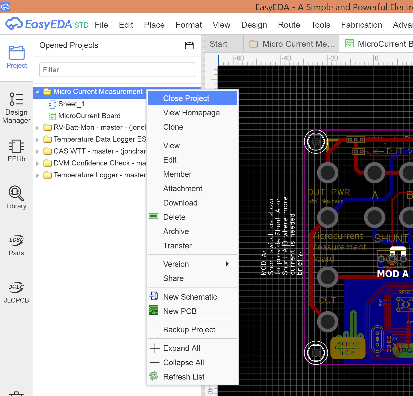

Anyway, the point of this post. I recently came across a new-to-me feature of EasyEDA - attachments. You can upload attachments including pdfs, pictures and even firmware code files that are archived with a project. Great place to save pdfs of app notes that have a habit of disappearing, data sheets, pictures and other documentation that will stay with the project. You could even scan your marked up data sheets and save them for future reference.
I use Dropbox to save my files, but I usually don't save datasheets, so this may be a way to keep all of the bits together for future reference when what was so obvious today makes no sense in the future. There doesn't seem to be any option to view pdfs and other saved files, only to download them.
To use this feature, right-click on the project in the projects menu, which will bring up a list of options.
From there. click on attachment, which brings up a list of stored documents. Click UPLOAD in the upper right corner of the screen (not shown here) to add more files.
