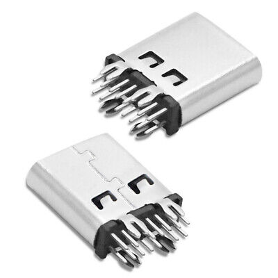

I plan on assembling the USB myself (bottom of board)
Top will be assembled. I located a USB type C on Ebay and the jlcpcb part# is C2798183
It has only 14 pins and in through hole.
The mini C is widely used
That should work.
But that connector only has 33 in stock at LCSC. Other similar ones has good stock.
I found the same part, same manufacturer on Ebay for $12 for 20 (that includes shipping.
The problem with JLCPB or LCSc is you can't order parts and pcb on the same mail shipment
I looked at both data sheets etc. Now to search where I purchased the walwarts and cables from. "visitor" suggested a site long ago I think I bookmarked it?
