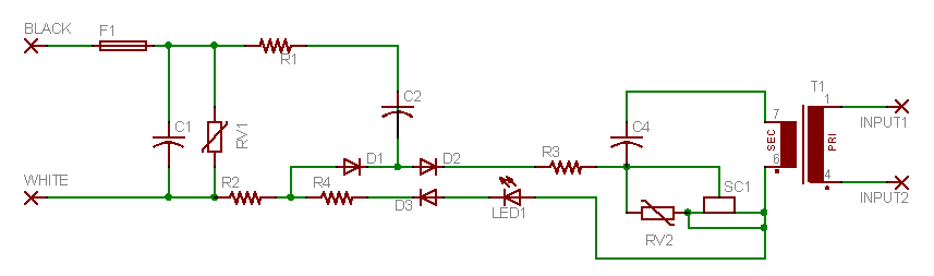

I don't know what advice I can offer you as far as trouble shooting aside from going through the components and testing them one by one. I drew up this schematic from the pictures you posted. I think it's correct but a good double check by someone would be a good idea. The only thing I wasn't sure about was the component marked SC1. I'm not sure what that is. Can you get a part number off of it or maybe post some additional pictures? Maybe someone else might know what it is.

SC1 is an SCR, my guess is that as the LED is permanently on it's faulty and has gone permanently closed circuit which is a common failure mode.
You could look at the part number and buy an equivalent if you like but any SCR rated to 400V at a couple of Amps, in a package with the same pinout should do fine.
SC1 is probably an SCR, and in your drawing it looks like you have it bypassed with that connection to the right of RV2.
edit: Hero, you beat me by a minute
If indeed the TO220 device is an SCR, how come the gate and the cathode are tied together?
It would be good if you could take a picture of the front of the device, to see any markings and legends it may have.
That would help solve the puzzle.
I thought SC might have stood for SCR but that doesn't seem consistent with how it's used in the circuit. Why are 2of the 3 pins electrically connected?
I bypassed SC1 in my circuit on purpose to clearly show that 2 of the 3 pins were connected. I wasn't sure if it was an SCR or not because of how it's used.
Great question. Unfortunately, I don't know the answer.

Maybe it's acting as a spark gap?
When the voltage across the SCR reaches its break-over voltage, it turns on and sends a high current pulse to the transformer.
Without a part number there is no way to tell if the part you have linked is equivalent. Are there any marking on the other side? It looks like both pictures are of the same side of the component?
You know, hero, you read my mind.
They may be charging the cap until the SCR goes in avalanche mode.
Very poor engineering practice, if you ask me.
The best would be to have a proper trigger device, (neon lamp, diac, etc) fed from a voltage divider, to properly trigger the SCR. Similar to the ciruits they use in auto-strobe lights

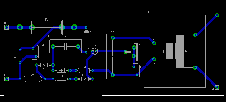

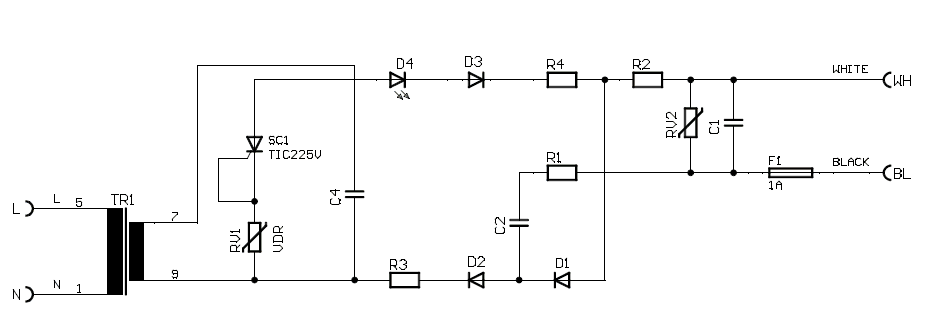

I reverse engineered the circuit and came up with the same schematic as vne147 did. I did something extra to see if schematic and PCB are consistent compared with the original PCB layout.
As much as SC1 is concerned my guess is that it acts as rectifier when RV2 voltage gets high enough to fire the thyristor.
Boncuk

Thanks for double checking me but I think there might be an error with your schematic. In the pictures posted by the OP, there are 2 pins on the SCR that are connected together which then connect to the anode of the LED. However your schematic has the single pin from the SCR connecting to the LED. I think you can fix this easily in your schematic by flipping around the SCR so that the anode is on the bottom. Am I mistaken?
Also, does anyone want to take a stab at simulating this circuit?
