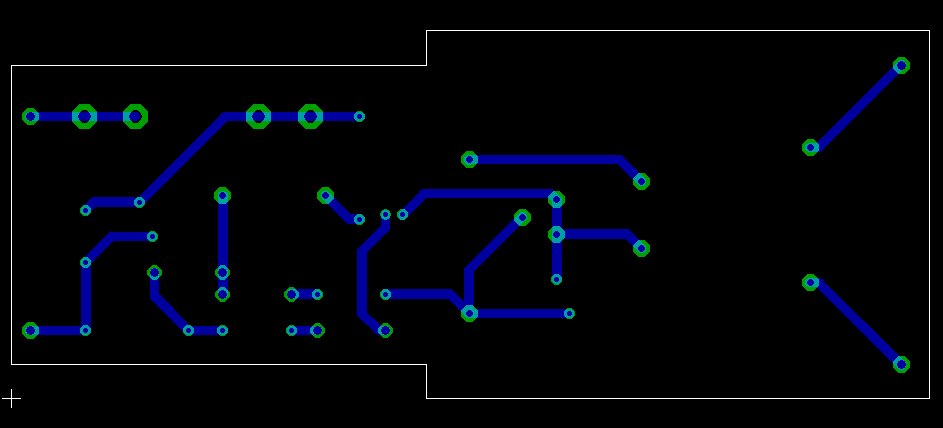

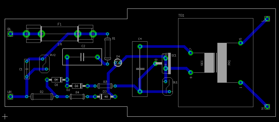

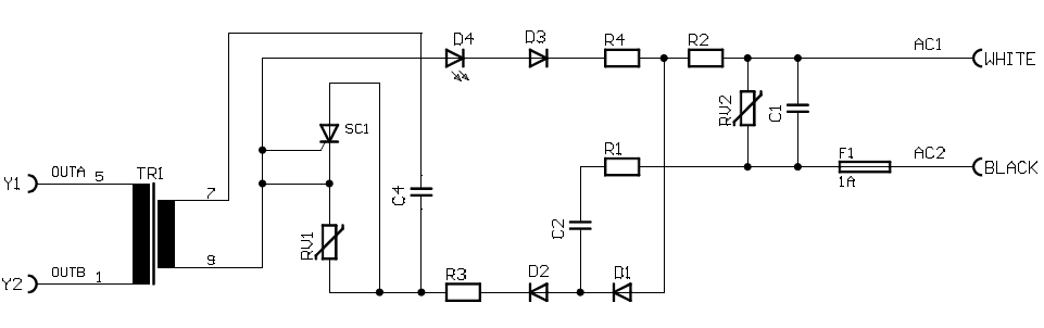

I redrew the schematic and the layout to the nearest possible as the original layout, having no clue what the SCR's purpose is within the circuit.
I doubt that the transformer is on the output side.
In that case the electric fence would certainly turn out as electocuting device. :confused:
I also don't see VR1 and the SCR connected in parallel. [the bottom side of VR1 goes to C4 and the top goes to the SCR.]
Anyway I wouldn't like to build that circuit for own applications.

The width of the traces connected the screw terminals are really thick compared to the traces in the rest of the circuit. That indicates to me that the screw terminal side is lower voltage higher current while the other side is higher voltage lower current. It looks like the transformer is used to step up the input voltage. At least that's what it looks like to me. I think one way to figure it out for sure would just be to ask the OP. So talkinggoat, which side is the input and which is the output. Also, are there any markings on the transformer?
Did you also read the print on the original PCB? "HS 03V-0" "94V-0 Δ" and "E119853". They certainly have a meaning - just don't know which.
Yes I did. I did a search for the code on the PCB but didn't turn up anything.
The black and white wires are the input for 110vac. The transformer is for the fence.
OK, now we are getting somewhere. It sounds like meatpie was right. The output is likely lower than 110 VAC or else those ginormeous traces wouldn't be necessary. Right???

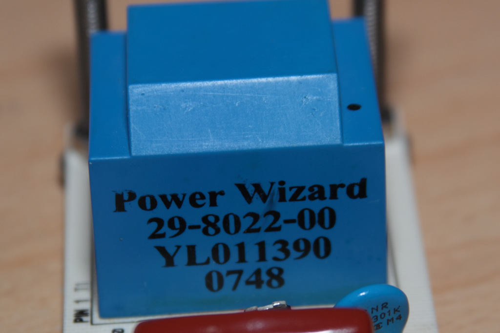

Talkingoat, the old man wants to know if there are any marking on the transformer or else it's back to the truck with you!

Its a variation on a fairly common line powered capacitive discharge type electric fencer.
The AC line voltage gets doubled by the C2, D1, D2 part of the circuit and charges up C4 using the LED and D4 as the return circuit. Once the voltage in C4 reaches the break over voltage of either SC1 or RV2 it creates a pulse that is stepped up to a much higher voltage with low current by the transformer.
Most likely the SC1 or the RV2 varistor shorted out and are in full conduction mode which is why the LED never goes off.
The question is why use a MOV and an SCR?
Surely doing it the conventional way with an SCR and a DIAC is better?
Anyway I think the OP should modify the circuit to do it the conventional way, at least then he knows it's going to work and be reliable.

Here is a shot of the transformer.

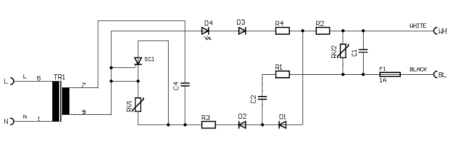

I suggest to try a TIC106D first. It has a gate current of 0.2mA. If it triggers too early the output voltage will decrease.
The TIC106M has a gate current of 15mA and is rated 600V for inductive loads.
Attached is the updated schematic.
Boncuk
