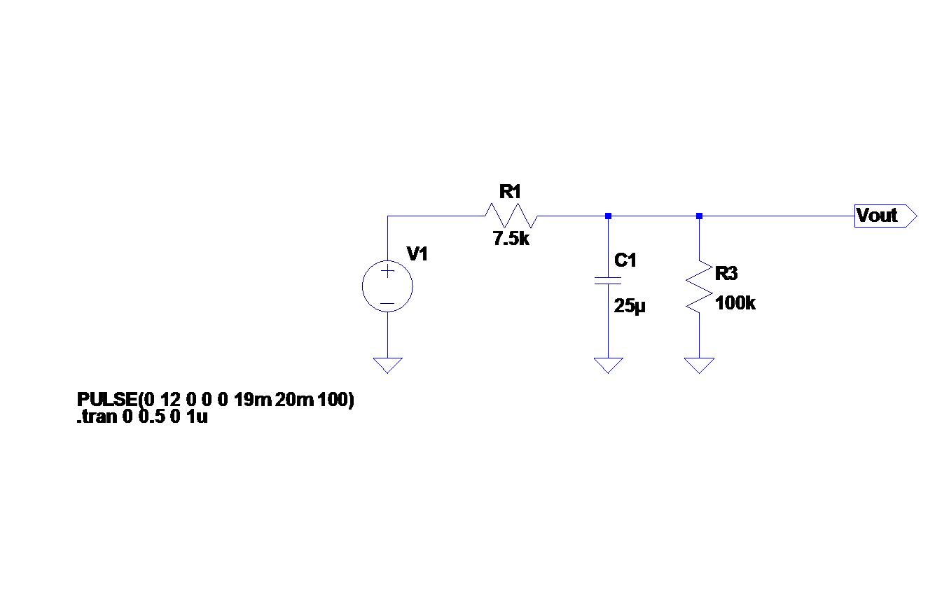

So this test box in my minds eye would be in the middle of the circuit and just show if the voltages are present and the command signals that are being sent to the thruster if any.
It looks like the only signal of interest ... the one requiring a little more clarification... is the speed control.
Is the speed control signal at 5 volts, or 12 volts, or 24 volts, when it goes from the thruster control pcb to the DC motor?
Is it correct to say that the speed control signal has a 50 Hz base frequency, and is modulated ... 0 to 100% duty cycle, as it inputs to the DC motor?
Does the polarity of the speed control signal change .... or reverse ... according to the direction control input ... between the pcb control board and the DC motor?

Yes .... speed control circuit pdf is very helpful.
It looks like the output of the speed control board is a variable pulse width signal, with a magnitude in the range of + 12 volts to 0 volts.
It may be possible to devise a simple test/diagnostic circuit to provide a led readout that is proportional to the duty cycle of the speed control signal. .... ... Will have to try this out and see if it actually works at the stated operating frequency.
Is there a circuit diagram available for anything related to the DC motor itself?
... Trying to get some idea regarding the main DC power signal waveform .... That would be the 250 volt DC/4.5 amp circuit.
Unfortunatley there is no drawings of the motor assembies as the company don't want people to be able to service them in field.
The motors have quite a complex set of circuits that provided braking etc for the motors as the have to change direction rather quickly.
As far as I am aware the power side of the motor is just plus and minus DC which is permanently on and all the speed and direction is done inside the motor from the speed and direction signals fed to it from
the motor drive card which is external to the motor.
proto-circuit for PWM evaluation ....
The principle of this circuit is to create a voltage that is proportional in magnitude to the input pulse width modulated signal ... according to the duty cycle that is present.
The circuit will require some adjustment/tweaking. However, the main principle seems to work..
With a small fraction of the 50 Hz time period turned on, Vout is about 500 mV or so.
With a 50% duty cycle, Vout is about 5 volts. With a 95% duty cycle, Vout is about 10 Volts.
... Would eventually like to get a little smoother waveform.
The circuit here is only a simulation, and the it will have to be constructed on a breadboard in order to determine if Vout gives a reasonable response as the duty cycle of the input signal is varied. ... Something that has not yet been observed ....
If there are no major flaws or critical problems, then it should be possible to use a comparator circuit to set one or more limit levels .... and turn on appropriate leds to display the PWM output level.
.... Another possibility for utilizing the voltage output of the circuit would be to use an LM3915, which would supply 10 output leds, turning on at the appropriate voltage levels. ... This is similar to using individual comparators though.
