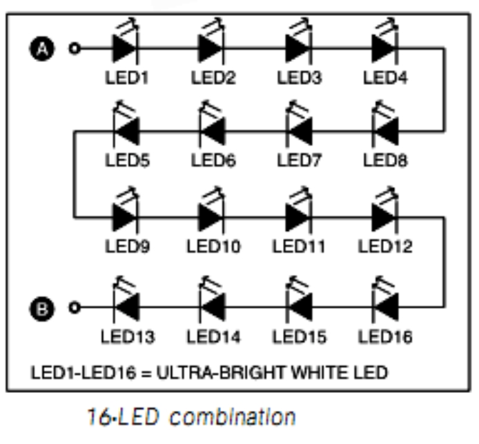

Thanks to all of you for helping me.:) From all the suggestions I got, I think this is close enough to a better circuit I came across :
This circuit employs capacitive reactance for limiting the current flow through the LEDs on application of mains voltage to the circuit. If we use only a series resistor for limiting the current with mains operation, the limiting resistor itself will dissipate around 2 to 3 watts of power, whereas no power is dissipated in a capacitor. The value of capacitor is calculated by using the following relationships:
XC = 1/(2πfC) ohms —————(a)
XC = VRMS
/I ohms ———— (b)
where XC is capacitive reactance in ohms,C is capacitance in farads, I is the current through the LED in amperes, f is the mains frequency in Hz, and Vrms is the input mains voltage. The 100-ohm, 2W series resistor avoids heavy ‘inrush’ current during transients. MOV at the input prevents surges or spikes,
protecting the circuit. The 390-kilo-ohm, ½-watt resistor acts as a bleeder to pro-vide discharge path for capacitor Cx when mains supply is disconnected. The zener diode at the output section prevents ex-
cess reverse voltage levels appearing across the LEDs during negative half cycles. During positive half cycle, the voltage across LEDs is limited to zener voltage. Use AC capacitors for Cx. Filter capaci-
tor C1 across the output provides flickerfree light.
Is it all right now ? or are there still many errors to be corrected.
What can be substituted for MOV 270/20, if I don’t get hold of it. ?
Zmint. (Trying to gain, a positive charge from electronics)
XC = VRMS
/I ohms ———— (b)
1) Can someone please elaborate, how the vlaue .22uF for Cx* was reached, for using 16 LED
2) Secondly is there any programmable shunt regulator which can be programmed for 48v, 1 w or 69V 1 W.
3) The "mov 270/20" what does it signify .. 270 ? 20 ? I was not able to get it. There are some kind available but they have different labeling system.
1) 0.22 uF yields in 16 mA at 230 Volts
2) No
3)MOV clamping voltage 270 Volts 20 kA rating, you can fit another one as long it has the 270 Volts rating or just leave it out. ( a power spike could take the lamp out)
The one I have got is 47D471K will it work ?
Can't find any data on it, sorry.

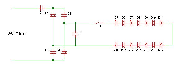

Have a look at the second circuit I posted, Is it the way it should be done ?
There is nothing wrong with doing it that way but it's better to use a full wave rectifier because it reduces the ripple, especially if a capacitor is connected in parallel with the LEDs.
This is the basic circuit I have been using for many years without problems.
I think you should put a 1M bleeder across C1 to discharge it when the power is removed and a 470R resistor in series to reduce the on surge and harmonics.
I could but given that the original LED light I made with it has been on non stop for about 5 1/2 years now I am content with how its been working as is.
1
What are the values you use for C1, C2 and R1.
Basically, how would I calculate them, for a 230 V 50Hz AC. power supply.
The method I used was to subtract the total voltage drop of all of the LED's in series from the RMS voltage of the lines. Then use that value to calculate the needed impedance of the capacitor at the normal line frequency and voltage I have in order to limit the LED current like a resistor normally would but without the power losses associated with it.
For the R1 and C2 values I just use any spare capacitor I have laying around thats between 20 - 250 uf and has a higher voltage rating than the voltage drop the LEDS produce.
Its mainly just to take the flicker out and give it a short standby power source during momentary power blinks. It also absorbs line spikes that everyone seems to get their underwear so knotted up over in regards to line powered LED circuits as well.
R1 is for additional flicker and spike smoothing of sorts and allows for any short voltage spikes being dumped into the C2 capacitor to be further trimmed down. I use around 200 - 500 ohms depending on how much current I am driving the LED's at. But its not critical so anything from 100 to 1K will work just fine.
If you think you may have higher levels of line noise a larger value of C2 and R1 will further filter it out.
