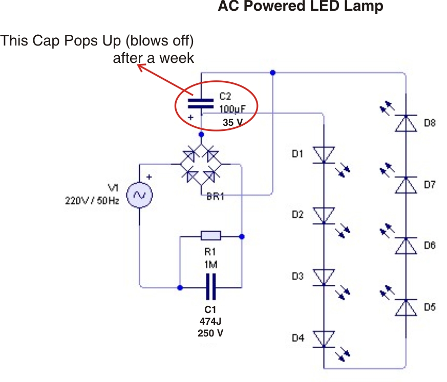

I purchased a few simple LED lamps from market.They consume very less power but with a little problem, they are not durable enough. They only last a week or so. When I opened one of them It had this circuit.
The problem is that the Capacitor (100 uF 35V) in the circuit Pops Up (Bust) after continues use. I tried changing the damaged Cap. C2 to another value 100 uF 63 V, (Pls. note that I only changed the volt rating 35 to 63 not the uF rating i.e. 100 uF) but the LEDS didn't glow.:confused:
Can someone please suggest me the value of the Cap (or some other modification in the circuit), so that the lamp keeps on working without the Cap being busting, even after prolonged use.
I am open to all suggestions.

I'm feeling a bit lost here. The output voltage of that rectifier is fed directly to those LED mesh? How much is the output voltage of the rectifier? Are those LEDs functioning now? Have you tested them individually?
I guess the main problem is not the electrolytic cap, but the 470nF cap in parallel with the 1M resistor. At a rating of 250VAC it is pretty poorly dimensioned. It should be at least 275VAC. Check out WIMA MP3-X2 caps.
Have you checked that cap for a possible short circuit? If it is shorted out the rectified voltage will raise far beyond the (supposedly) 28V supply voltage for the LEDs.
Also check the 1M resistor if it still has the value as posted.

They are using the reactance of the capacitors to decrease current, similar to how ballast works in a fluorescent light. The question was asked (this post, and many others) but they are a bit more conservative there, so it was closed.
I think that cap needs considerably more voltage rating, I would put it at 100V, though that is overkill. Basically the schematic is whacked. Come to think of it, I would throw that schematic away and start over.

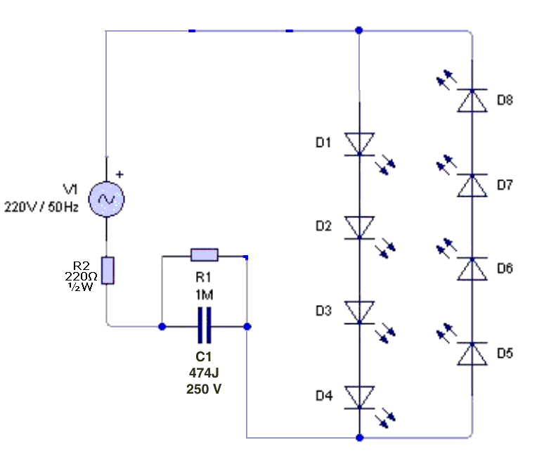

This might work better.

You're right, I relooked at the schematic. The LEDs will have 28.8V across them, way to close to the capacitors value. Bump up the voltage rating to 50VDC?
The other cap (C1) is around 6.77KΩ reactance. I'm being lazy and not calculating the total reactance. This puts the current around 32ma. The neat thing is, it doesn't dissipate any wattage, unlike a resistor.

Now coming to the circuit. Definitely the schematic is whacked and worth throwing away but for me, I checked all the components and changed the Cap(C2) value to 100 uF 50V and only the first LED (D1) turned on. As you all anticipated well the rest of the LEDS were fried by overcurrent caused by overvoltage. I redesigned the LED array increasing the quantity to 10 this time and It was just like old days (Bright and Clear). I hope it will keep on working that way.
The facts : The original assembly use to work fine, daily, every night, for continues 3 hours at a stretch. (for a duration of about 2 months) and finally on THE DAY, I forget to turn it off and in the morning the Cap was spotted with a head (no to severe though, just a POP). Hope the new assembly works a little longer.

1) Without the LEDS & the Cap(C2) the voltage is near 148V DC
2) Without the LEDS, but with Cap(C2) 100 uF 63 V, the voltage is near 87 V DC
3) Without the LEDS, but with Cap(C2) 100 uF 50 V, the voltage is near 80 V DC
4) Without the LEDS, but with Cap(C2) 100 uF 35 V, the voltage is near 56 V DC
5) With the LEDS (8) & with Cap(C2) 100 uF 50 V, the voltage is near 32 V DC
I lack a good electronic head like yours. So can some please explain this, in layman terms. And also suggest me the value of C2. How about adding a current limiting resistor in series to the LED array ?

Leds run on DC current if you don't want them to flash. The value of C1, along with the voltage and frequency of the mains, controls the current. There is nothing wrong with that idea, but C1 should be rated to 400V. It is also a good idea to put a resistor of 100 ohms or so in series to limit the current as the lamp is turned on.
The current is rectified and fed to the LEDs. The capacitor C2 is there to keep the LEDs alight during the times when the AC current drops to zero. Without C2 the LEDs may be seen to flicker, which can be annoying, but there is nothing wrong with it electrically.
If the LEDs aren't there, the voltage will rise to nearly the mains voltage, which is far higher than normal running voltage. The voltage on C2 and BR1 may be far too much for them.
If you remove the LEDs, and leave C2 in place, the current will continue to flow until either mains voltage is reached, or something fails. In your tests 2, 3 and 4 you are overloading the capacitors, and the bigger the voltage rating of the capacitors, the bigger the voltage before they fail. It is a bit like putting water into a water tank. If you have a tank rated to 100 gallons, and you trickle water in at 1 gallon a minute, in two hours (120 gallons) it starts to overflow and you can't get any more water in, but it isn't a good thing to do. Each larger voltage capacitor is like a taller water tank. (The capacitance is a bit like the base area of your tank).
Test 5 is how it should be run, and at 32 V, your 50 V capacitor is fine. The original 35 V capacitor would be too close to its rating to be reliable. There will also be a lot of AC voltage on top of the 32 V that you are measuring, so the peak voltage will be too much for the 35 V capacitor, and its not a good idea to run capacitors that close to their rating anyhow.

Yep it should have another resistor in series with the X2 reactance capacitor.
The mains reson for the electro blowing apart is that if a LED fails, or gets a dry solder joint etc even for a short time there is nothing to limit the voltage rise on the electro cap!
So a LED probably blew first (or got an intermittant open circuit) and the secondary fault was the electro cap exploding.
Quietman's solution is good for getting rid of the electro cap but the LEDs will flicker at 50Hz and get twice the ripple current so LED life will be reduced.
If you just use the original circuit but swap in a good 100uF 63v cap and resolder all the LEDs it should be ok PROVIDED no LEDs have gone open circuit from the last fault. :)

You need some R2 in series with the array. If you power it suddenly in the middle of the AC cycle (you have no control over this) the current won't be limited until C1 is charged. R2 also needs to be there to limit the current when spikes occur on the AC mains.
