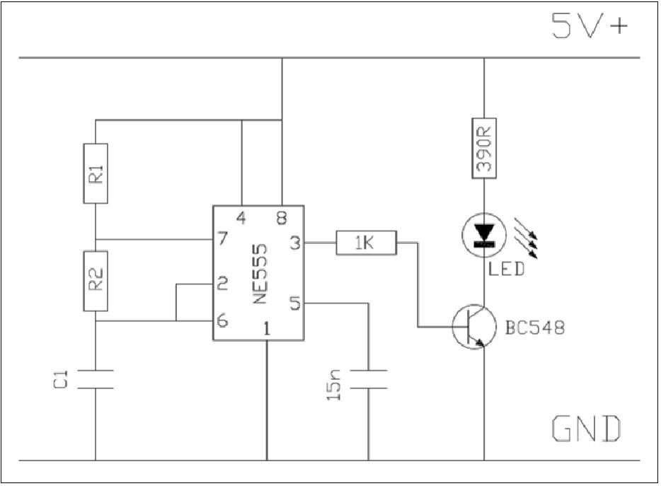

I put this .xls file together a couple of days ago (see attached). It might help you out. It's a simple flasher circuit using a 555 Timer. There's a formula for working out pulse/duty etc in the spreadsheet cells. you can change the cap/resistor values to get the right frequency. This one just drives an LED. Take out the LED and put your relay coil there. You might need some bypass/filtering caps and diode as dougy83 suggested though. -Tom

Ignore that, my circuit is astable! do a google image search, the monostable circuit looks very similar to it.
Cheers -tom

it's an excel file with an image in the spread sheet. couldn't attach it so i had to zip it first. I can unzip it at this end. see attached image from the xls file. it should be ignored anyway. as i mentioned earlier, it's not really applicable since mine is an astable circuit, not a monostable circuit. apologies for the confusion. -Tom

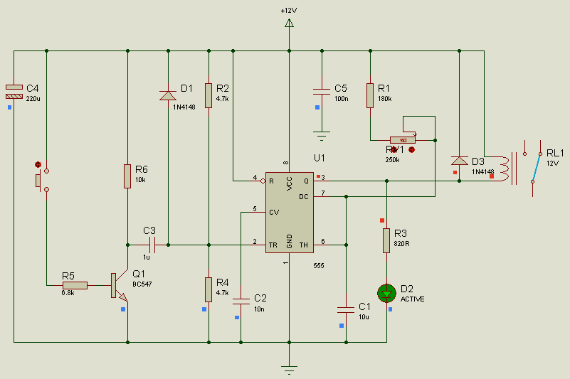

Hi thecritic,
here is circuit using a non-retriggerable input. It accepts a new input only after the circuit has timed out.
Please note the decoupling cap of 100nF close to the NE555 supply pin and a 220µF electrolytic cap in the supply. If possible place it also as close as possible to the timer IC's supply pins.
Make sure to use a free wheeling diode for the relay. If the relay has to switch a high current load it will also cause false triggering by the spark caused on the relay contactors.
The 1µF coupling cap at the trigger input takes care not to react on false triggering.
Boncuk
It is a simple 555 oscillator driving a transistor that blinks an LED at only 9mA. The transistor can be removed because the 555 can drive the LED and its current-limiting resistor easily by itself.

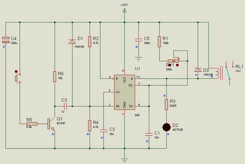

Hi thecritic,
Boncuk
