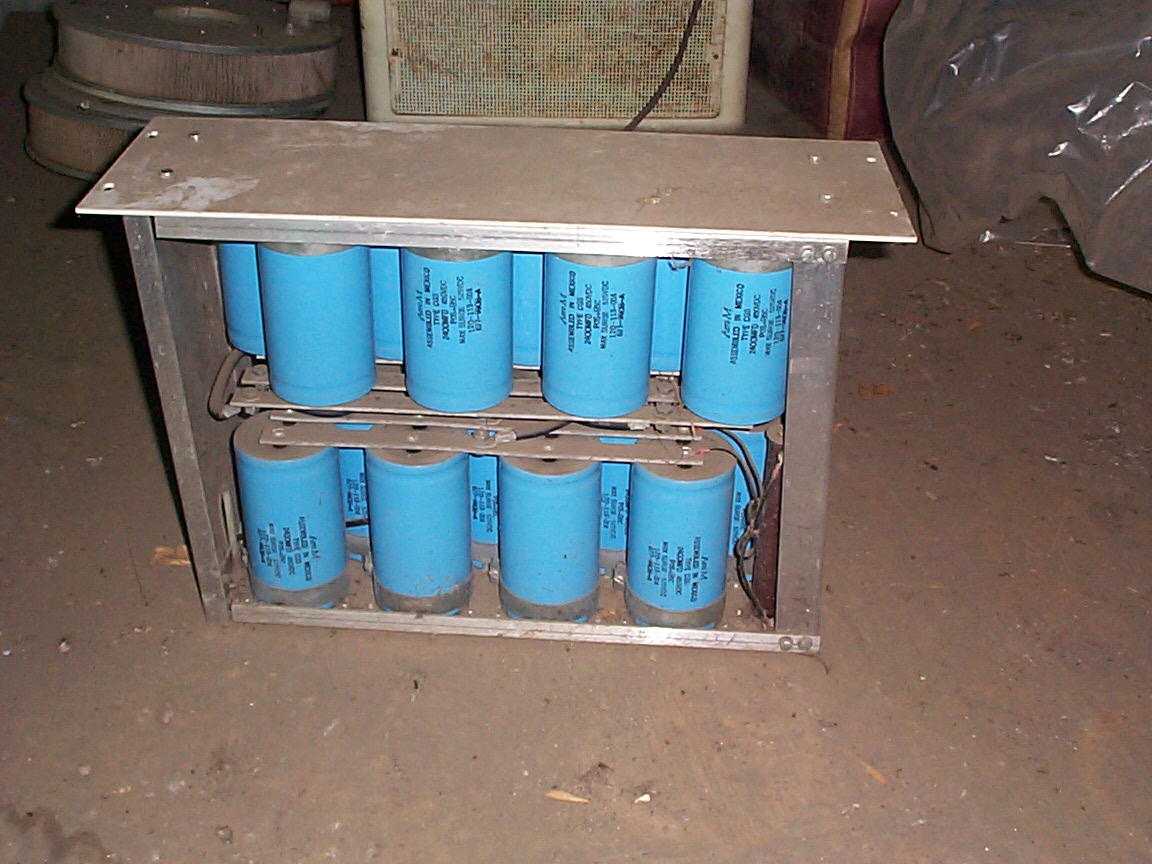

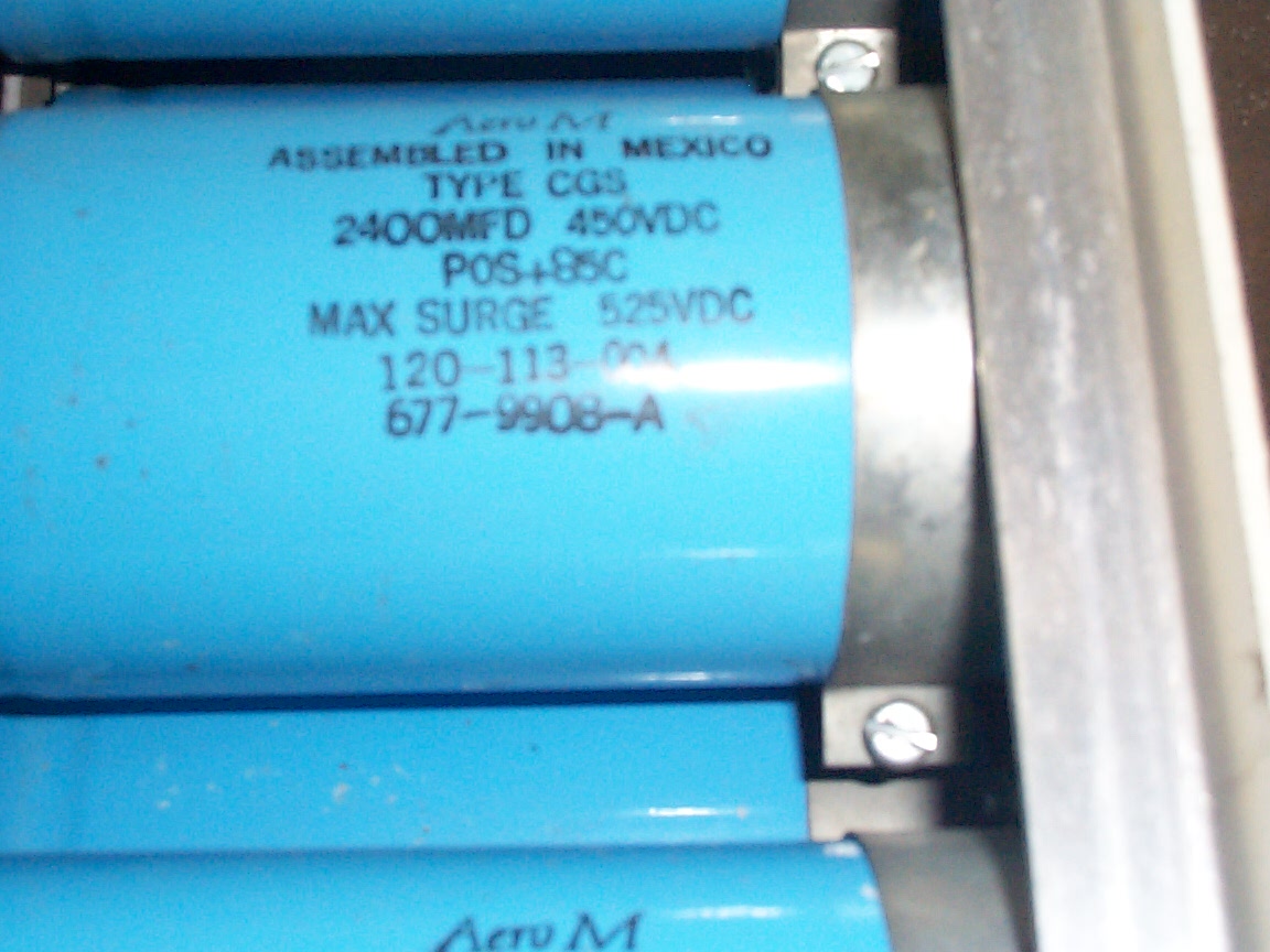

Um... I dont have photo flash caps I got these. My count was way off. I have 4 banks of 16 not 2. Plus they are 2400uf :D

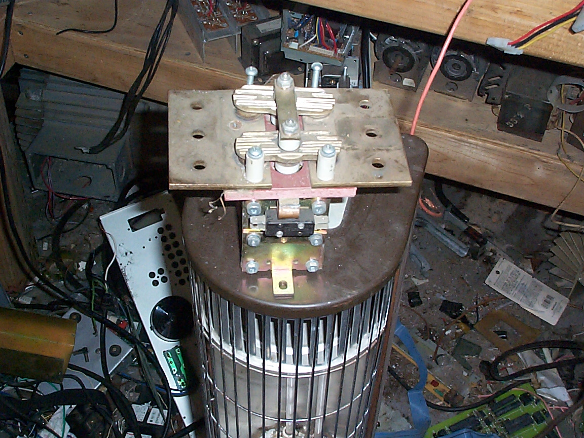

And a 600 amp DC contactor. :D
It shoud still do something! with 6 banks of ten and a theoretical cappacity of 1440 uf at 5250 VDC peak. :eek:

That's 19 thousand joules now =O time to discharge through a total resistance of 1 ohm down to 50 volts is about 350ms, starting power is upwards of 240kw's =O The question is what do you do with it =) You could make one hell of a railgun with those banks, but you'd need to time their discharge through a series of separate stages. Wanna send me one of those banks? I'll try not to kill anyone, I promise.

All the capacitors I got like these in the picture came from a 100hp units. I got them for free too! The salvage yards can't send capacitors to the smelters. (PCB laws from way back.)
So I have my scrap buddies call me when a big lot come in. I happily haul them away for free!
