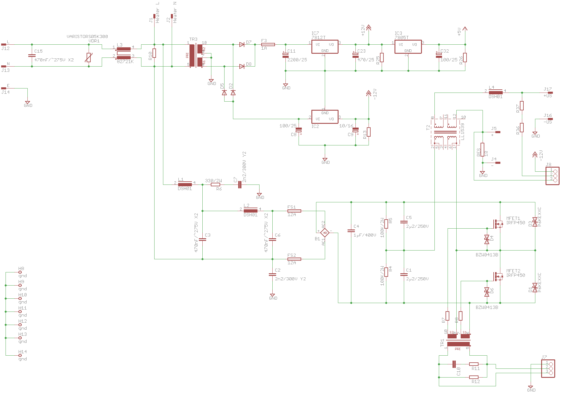

Thanks for the suggestions. I know it is not a childs play this design and also for the moment at least I am not going to a powerfull supply. The specs are not more than 100watts of output in any combination of current-voltage.
Few years ago I tried the attached design on a prototype for Ultra Sonic cleaners of about 500 Watts but the transformer T2 was ready made and did not deal with it. Also the operation was relatively limited in control, as the voltage and current to the transducers was stable. TR1 is also off the shelfe driver transformer. This is half bridge design that may work, maybe not in the range I need. Before blowing the mosfets(!) I'd like to know at least how to properly construct the transformer T2. Please note that the real part has one coil on each side and not as shown on the schematic.
Here I need to adjust the output voltage on a wide range and this is puzzling me. If anyone knows more on ferrites or can lead me to design specs and calculations, it would help alot.

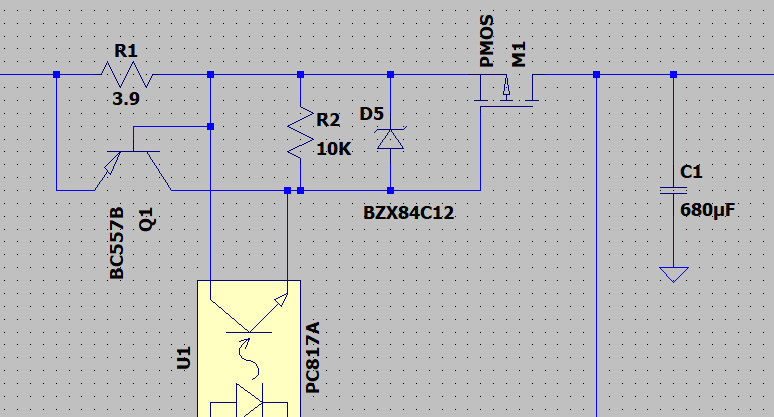

Let me express another idea that I tried on the fly with not good results though, because I used optocouplers. Optocouplers are not fast enough and the end result was enough power loss.
I 'll try to make a schematic later but the general idea is to have a Mosfet right after the rectifying bridge and BEFORE the smoothing cap. On zero crossing, the Mosfet is ON and is charging the cap up to the Vreg output plus say 10 volts. Then it is turned OFF for the rest of the period.
I tried this with an optocoupler design that was a bit slow in response, leading to power losses on the Mosfet. The opto was necessary because of the big voltage differencies in the circuit.
You used the wrong opto-coupler then, there are plenty of fast ones - and they are VERY, VERY commonly used for feedback in SMPSU's.
It could be, but all I tried (4N25-27, PC817) had the same result.
Maybe something was wrong in the Mosfet driving circuit. Did not turn it on/off fast eough. Will make a ciruit file and upload it.

Indirect because Mosfet was getting hot.
OK, here is the schematic with the opto coupler. The regulator is not important and was used for testing only. The real regulator is different.
The idea is that when the output is around 10volts less than the cap C1 voltage, the Mosfet M1 turned OFF and stop charging C1.
The Q1 was added to protect M1 from high current charging C1. Unfortunately the M1 is getting very hot.
Ioannis

I do not see how that can do anything? The opto is driving against a 3.9 Ohm resistor to turn on the transistor, and there is no turn-off for the MOSFET??
The MOSFET gate needs pulling towards the drain to turn on, with voltage limiting, and to near 0V relative to the source to turn it off. I just don't follow this.
You are right. I forgot to draw the resistor from gate to ground, of 270K. That way the Mosfet is driven to ON state and the optocoupler would turn it OFF when the difference of output to C1 voltage is more than 10 volts.
I attach the corrected file. Thank you for spoting the error.
Ioannis
  • Power_Supply_optocoupler.asc
I wouldn't be happy trying to drive a switch-mode FET with an opto-coupler, neither for speed, not current driving capability. However, I can't see your circuit, as you've posted it in a non-standard format - luckily rjenkinsgb posted part of it as a sensible jpeg (although png would have been better :D)
