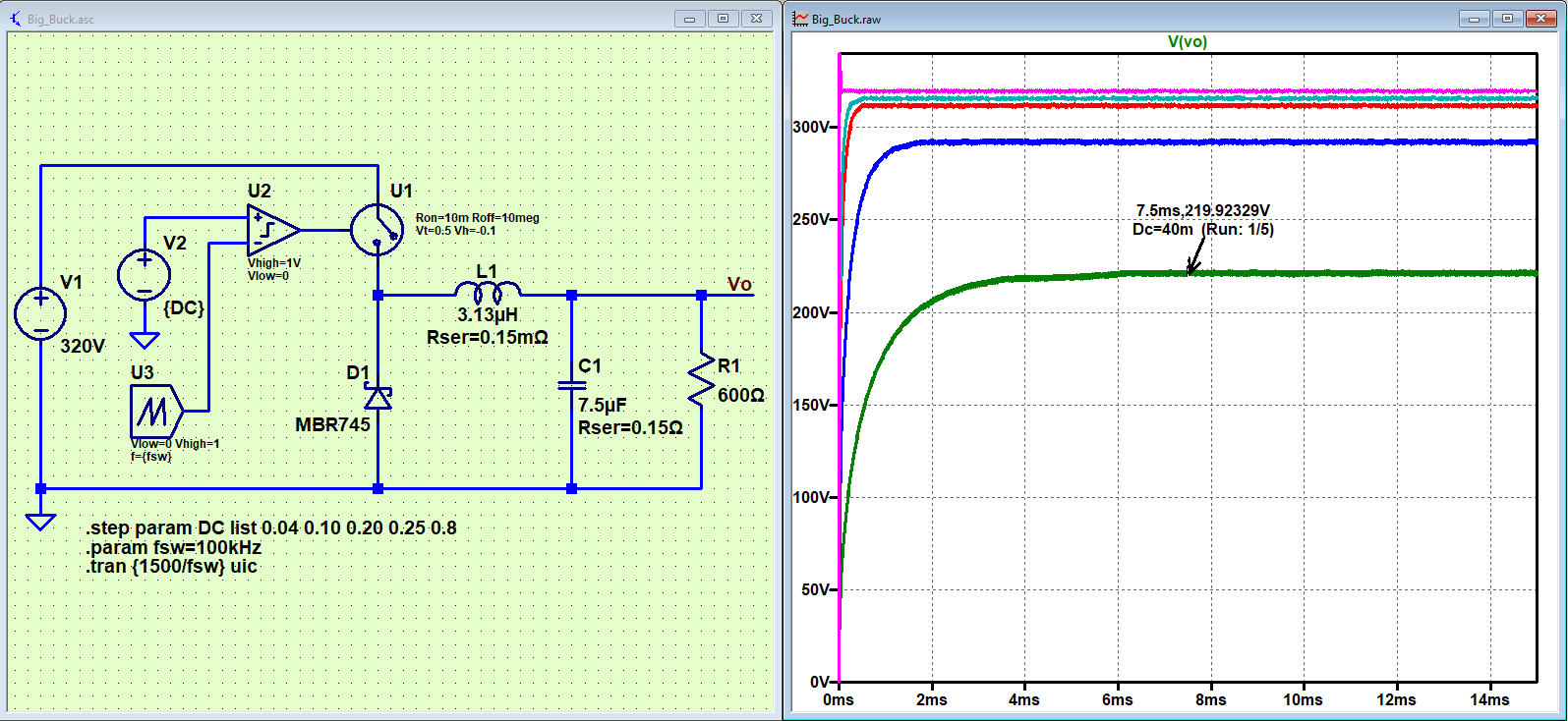

The main problem with using a buck converter is having the duty cycle vary from 10/320 = 3.23% to 300/320 = 93.75%. Most buck converters will have a problem using a duty cycle over 50%. At the higher duty cycles you may have to tolerate increased current ripple and potentially sub-harmonic oscillation. Neither of these things will be good for the output.
As you can see from the following simulation there is only a narrow range of duty cycles that can control the output effectively. There may be a way around this, but the method escapes me at the moment. The duty cycles from 20% to 80% all result in approximately the same voltage. and 4% gets you about 220 Volts. I have no idea how to get 10V with some level of stability. It would take an incredibly small duty cycle, where very small changes in that duty cycle will result in very large large changes to the output voltage.

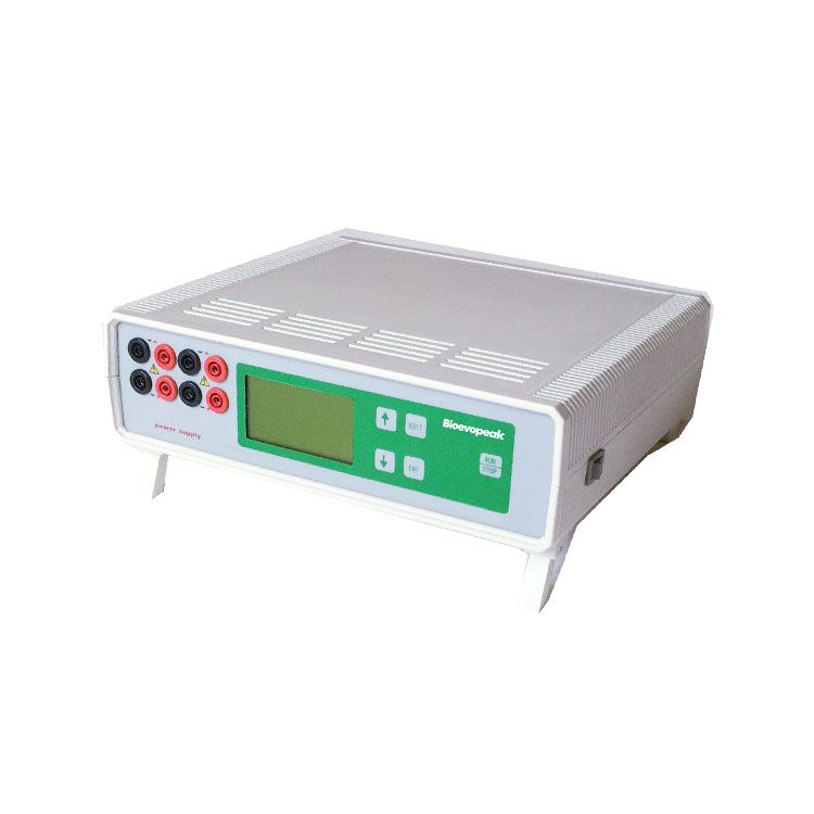

But would really make the difference with a new design based on SMPS. Then got stuck in the wide range of DC that needs to control the output voltage. Such designs do exist with output voltages 10-300 up to 20-6000 volts:
All seem to have switching power supply as the enclosure size is small enough.
