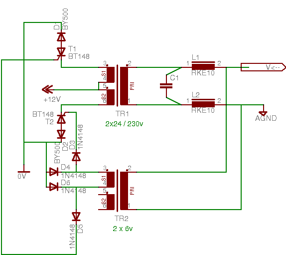

I mean this type unit. Components are some random from eagle library, but if replace thyristors SCR, like S0802MH there is no need for diodes and slight more efficiency (no 0.7v drop). I have pile of S0802MH:s accidently buyed as triacs.. 200uA triggers.. 8A up 800 volts..
Transformer volts needs to be more than supply and trigger circuit need more components to give single adjustable trigger point.
SCR/thyristor shut off gently when phase come high because supply is ~½ voltage from transformer high.
This type circuit push power to grid rising edge so it is capasitive load.
What think is it usable if supply is kept low enough. How think about harmonics? I see it is guite gentle switch. Add some more coils and it come more gentle.

I am not actually sure what your going for. D1 and D2 are reverse of the SCR's they are associated with and will prevent any power from being switched.
I have never gotten SCR's to work as a reliable GTI switching device. They turn on easily enough but getting them to turn off on the back side of the wave from is the problem. There are ways to do it but several more inductors transformers and capacitors are needed to make it work and that all takes away from any possible efficiency gains to be had by using SCR's
Half and full H-bridge switching systems using transistors, Mosfets, or IGBT's are simple rugged and have far better control capabilities.
SCR's have the design problem of not being able to be turned off on command. When the wave form changes from rising to falling they will keep conducting right past the zero point on the back side of the wave and just keep right on going onto the reverse side of the wave. Thats very bad!
They work well for AC to DC conversion but do not work well in the reverse usage. If that makes any sense.
Their inability to be turned off at a specific point is the whole limitation.
Starting the turn on point low on the wave and then having the wave peak greater than the input voltage will turn them off but you are very limited on the available power you can possibly transfer that way. The most efficient and also peak power transfer is when your input voltage is about 5 -15 % above the peak voltage of the transformers primary side, switched side on a GTI not line side.
Ups, I did schema too quickly, they should be reverse and deny bacwards current.
Yes and consume zero keep open energy after triggred. Low conduct resistance too.
H bridge have two silicons, so double loss (not real broblem). Silicon cost, but minor broblem too. lot of simpler than H bridge.
But think if you use 24v transformer and 12v supply voltage. When wave rises, it have only first 1/4 less than 12v. During that keep SCR open. Coil have some current runing and continue some amount over 12v, but current go zero and SCR off before wave got top point.
Right?
And that SCR close is smooth operation so it produce low harmonics and low loss.
Power transfer is definitely less. I agree. Only 1/4-1/2 of time power feed is posible.
But usually you find big enough transformer for low cost and use of cheapo tyristors/SCR:s reduce cost. Less silicon to blow up..
So what you think is harmonics broblem in that kind of device or not? How about efficiency? You had play these for long time. Do you have tested suchs device?
Is it worth of try (I can find 90% parts of my junkstorages)
