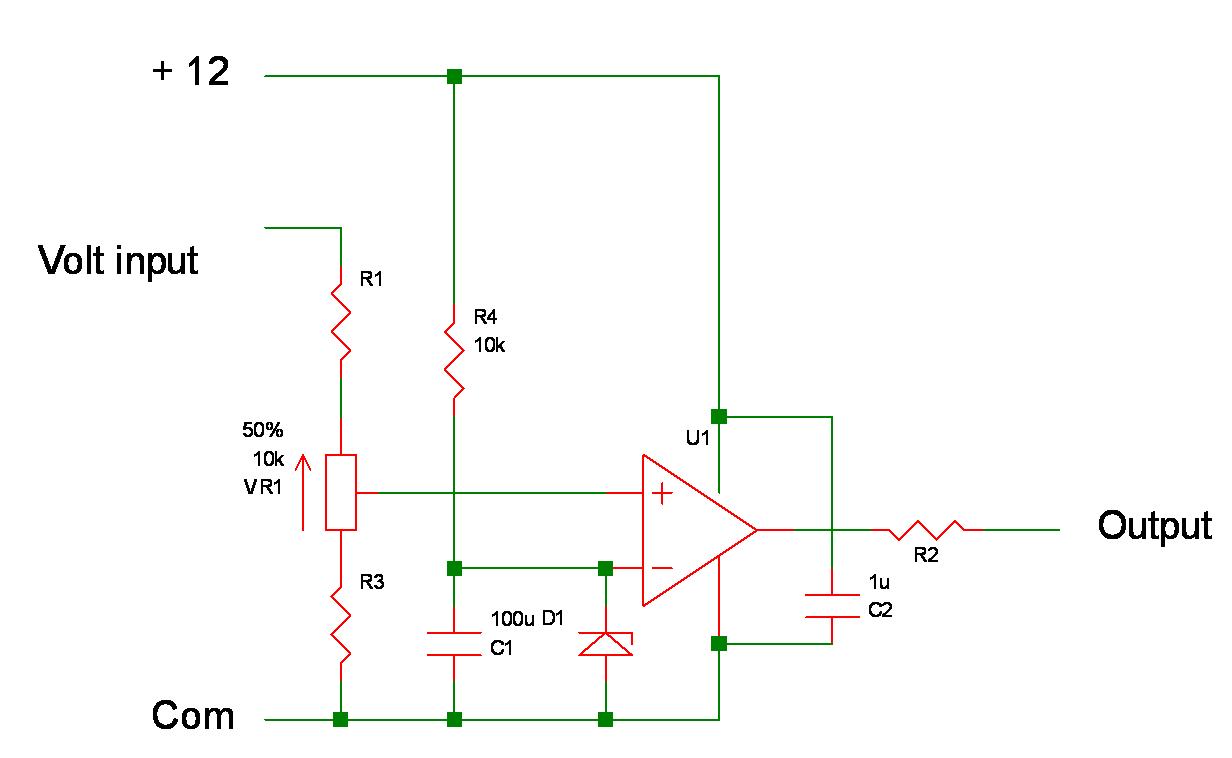

SINGLE STAGE VOLTAGE COMPARITOR.
This one is a basic voltage comparator. It just sends an on/off signal based on the voltage set point. If the input voltage is below the set point its output is off. If its input voltage is above the set point the output is on.
This circuit is used for the stage change functions and for the basic line voltage and part of the frequency monitoring circuit.
I have chosen the LM324 quad op amp for its simplicity and easiness to find.
(See Spec sheet below)
(Any other voltage comparator can be substituted if you wish. Just makes sure it has suitable voltage and output current capacity ratings.)

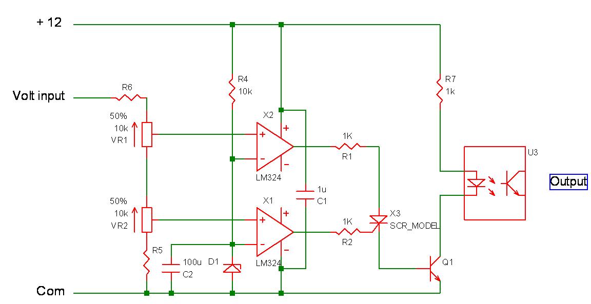

TWO STAGE WINDOW COMPARITOR.
The second comparator is a window or dead band type. It has to go above a high level set point before its output will change from off to on. But it then can drop below that level without turning the output off. It uses a second lower level comparator that controls the second set point to reset the output to off. Once it has turned the output off it can not turn on until it passes the high level set point again.
This dead band allows for monitoring voltages that tend to fluctuate during operation. Being able to set independent high and low points will keep it from oscillating during load changes or power fluctuations.
