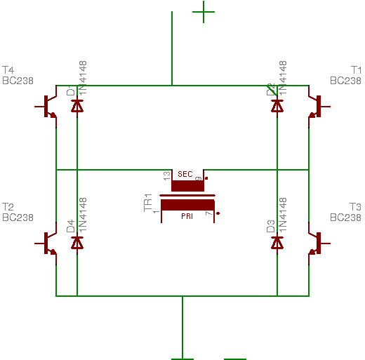

I actually built one on my desk with biggest available transformer -> sinking cca 2A at 12V power supply and power meter shows 35W.
Got wings!
Got questions!
I'd like to use old 3-phase 3hp 230Vac motor (till waiting for material to make own 12V windings). It is clear that I need rectifier. And with stronger wind also DC voltage will rise.
So I obviously need something in between. Or not?
Tcm, You used caps in H-bridge to dump switch off current. Do you have tested diodes instead? Using bridge rectifier paraller with transformer conduct switch off current back to power supply.
It looks more efficient way and put less stress to h-bridge parts. It may reduce harmonics too?
Comments?
Take a closer look at the first schematic I posted. they are part of the IGBT devices! They are what bypasses the switching devices and let the spike get absorbed by the capacitor.
What your saying is true it does help protect the switching devices and it already incorporated into the design.

Basic analog power system with IR2110's driving a standard H bridge. It dont get much simpler and more efficient than that! ;)
I dont see any AC line filtering though.
But at 100 watts it wont put out too much noise any way.
Nice clean layout of the actual unit.
The control systems seem a bit over complicated but thats just my opinion.
I would still consider it a good reference point any way! :)

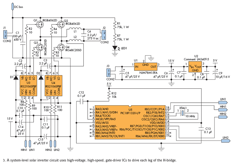

Here's another one
Hi guys,
here's another one, now more neatly designed I think. The article seems to have been published only today:
Link to **broken link removed**
Please also see attachment.
