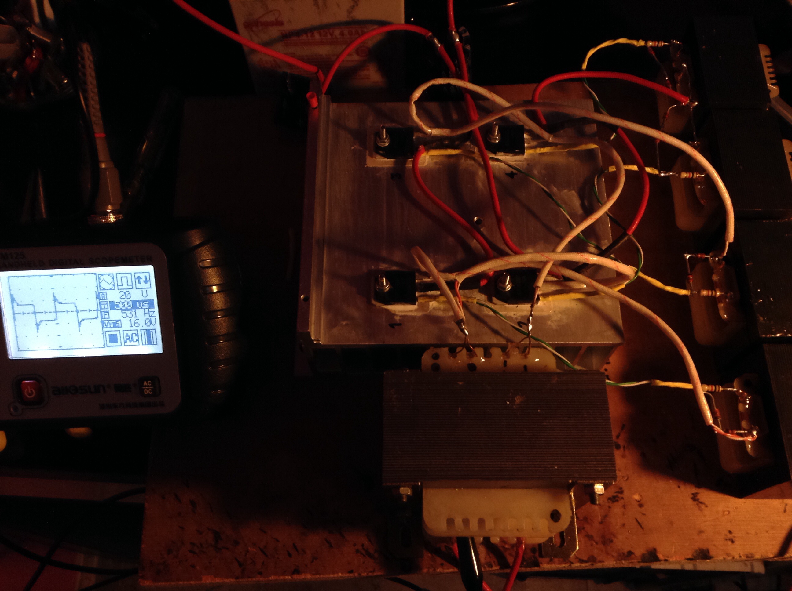

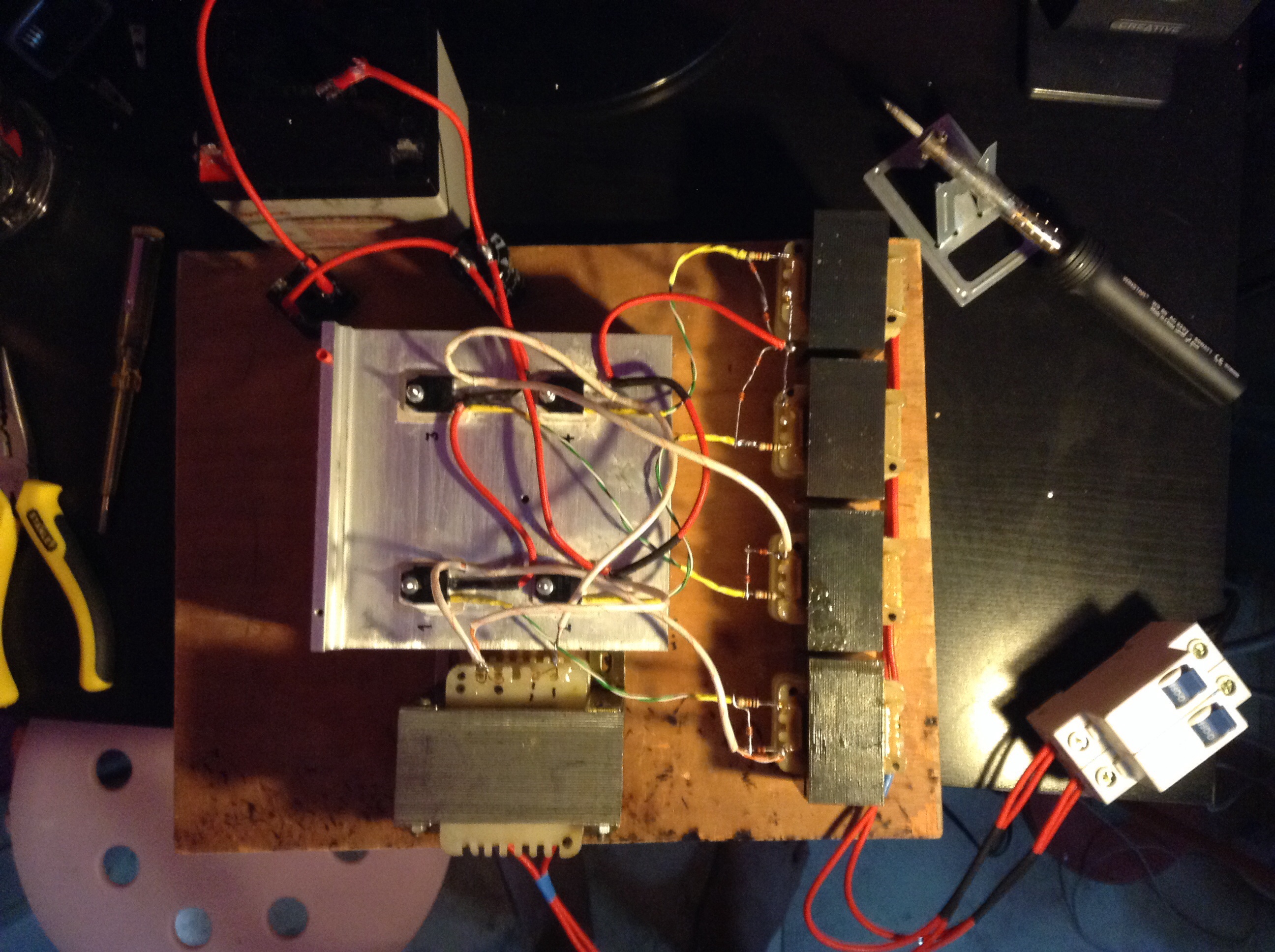

Sorry guys..its actually working...i used battery...12vdc but my issue is my output 117v only my primary on 10v...any suggestion
Input DC voltage might be a bit low for the power transformer you are using or the zero crossing deadband too wide due to not having enough voltage coming from the gate drive transformers.
How are you measuring the voltage and are you able to get any actual feedback to the grid when it connected?
Im measuring using voltmeter....mate, also im using 100uf/400vdc caps am i right do ineed to change it to ac? Sorry but im not familiar with the flow..though i have background in electronics..i have very little knowledge on this one...if you dont mind could you please explain to me regarding the feedback to the grid how can i assure that is actually working? But your design is perfect...but i think youre corect my input dc is not enought(12dcv/4amps battery i used for testing). Thank you again in advance for your help...
All IGBT is in perfect temperature....at the moment im using normal diode...not scr...GBPC5010 i use only the two pin..and my powr transformer primary is 12vac 0-12. Its actually 12-0-12 but when i first used it is not working so i deside to make it 12volts and i parallel the primary...and its working...i get 176-177ac secondary and my primary is 10ac measuring by voltmeter...and the four control transfo have the same secondary 10ac...
Here is my actual build of your design...thank you for this in advance for making this in public youre actually helping others...:)
If your power transformer is a 12 VAC unit running it in a grid tie application you would need around 18 volts DC at the input before you start seeing the unit loading up.
For a 12 volt transformer the peak voltage would be around (12 x 1.414) ~17 volts. Then add in a your switching device forward drops and blocking diode forward drop and the small loses with running the transformer in a step up mode and likely you wont see full output into the grid until around 18 - 20 VDC input.
Ah okay then..thanks for the info..seems i need to increase my dc input..i will let you know then later...thanks mate :)
