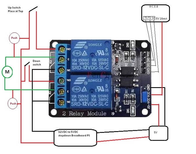

Since I have so far made a disaster of my DIY board to control a 12vdc motor bi-directionally, I have made the below drawing using a 2 relay module.
The module will be controlled with a WebController 8.0 uC giving 5v and 20ma, the motor will draw 10A full load. Though, it will only pull a small plexi glass door, so the load should never max out.
In the drawing are two switches - these are limiter switches when door travels to full up or full down position.
Not only does the uC control the motor with limiting switches, , but I need one additional component - two push buttons at the site of the door/ motor which will allow local activation of the motor, without the use of the itnernet/ LAN.
I beleive the below drawing would work, with one caveat as I can see it (in my very limited electronics knowledge): If I push one of the buttons to activate the door and the uC is activating the other relay at the same time, I would essentially have 2 hot wires goign to the motor. I can't figure out any failafe for this.
In review, I obviously did the drawing wrong at the PS - Bottom left black and red lines should originate from a 12VDC PS, then divert up to relay and right to 12VDC to 5VDC converter module
Any ideas (other than scrapping the project which I am not willing to do)?

You really need an interlocking relay, ideally this is done on the inputs, you could possible use a double pole PB for each with a N.C. and a N.O. contact and use the N.C. contact to open the opposite relay output.

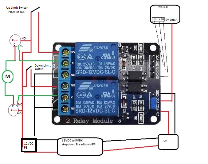

The way you have drawn your circuit you will short out the 12 volts via the NC contacts on the relays if you press the buttons when the relays are not energised. You would need to use push buttons with change over contacts. The common terminal on the push button would connect to the motor, the NC contact would connect to the NC contact on the relay and the NO contact would connect to +12 volts. If this is for the same project as your "Adding push button to 2 way motor circuit" thread then the design that Reloadron provided should work if you wire it up to his schematic.
Les.
That makes sense - the witch probably should be a DPDT so it can divert the OPOSITE relays hot wire, yes?
Am I getting closer?
I still think S.P.D.T push buttons will work. I have just noticed that I made an error in post #6. The part that says "the NC contact would connect to the NC contact on the relay" should say "the NC contact would connect to the C contact on the relay" So this means that the push button swaps the motor from the C contact on the relay to the +12 volts.
Les.

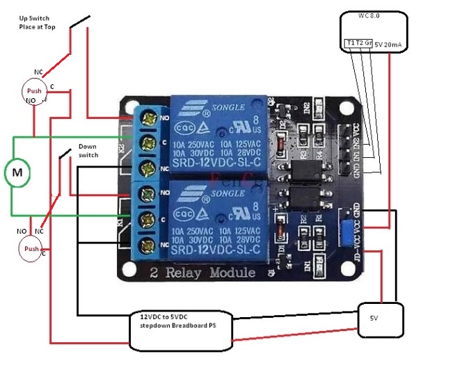

I assume by "h bridge" you mean the two S.P.D.T relays. With the push button not pressed the motor would be connected to the C contact on the relay via the C and NC contacts on the push button. (As it would be without the push button.) In both your circuits in posts #1 and #5 you are shorting out the 12 volts when either of the push buttons are pressed. Also you show the limit switches as normally open. They need to be normally closed. I still don't understand why you are trying to change a design that you have proved to work just because you wired the extra push buttons incorrectly. You have gone from a good design to a circuit with obvious design faults.

Yes, but the limit switches (Which are still shown normally open when they should be normally closed.) will not work when the door is operated from the push buttons. To make the limit switches work both from the relays and the push button pick up the 12 volts to the push buttons (NO contact.) from the side of the limit switches that connect to the NO relay contacts.

What is the reason for putting the manual push buttons on the output of the relay board rather than the input ? Although you would need to add two diodes (Say 1N4148 and these only cost £0.0135 + VAT each) that would be much less than the saving in cost by using a cheap low current push to make push button instead of a 10 amp changeover push button.
