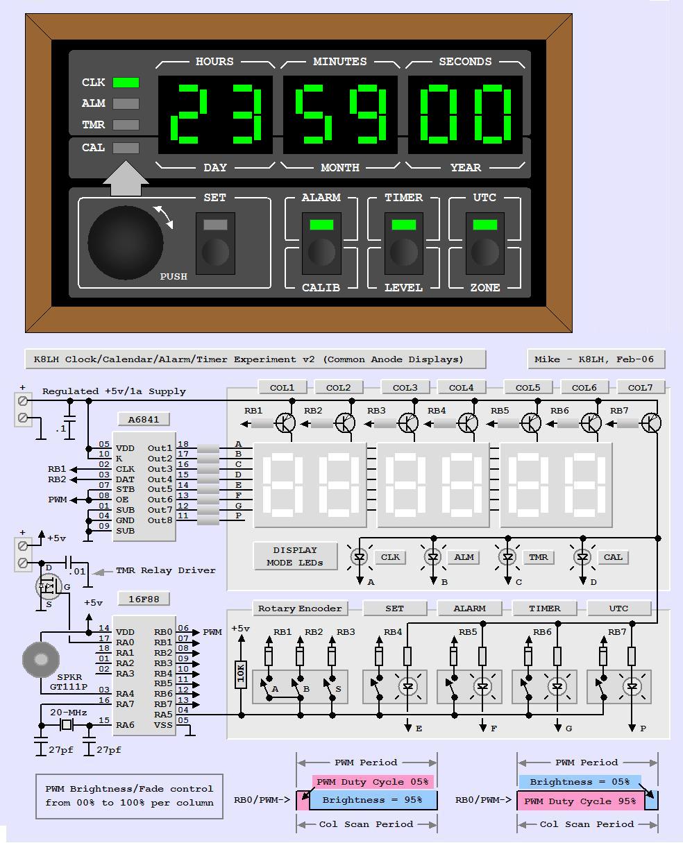

You could also use a tiny 8-pin PIC microprocessor and 20-MHz crystal to provide a 1-Hz clock output accurate to within plus or minus 200-nsecs per second (6.3 seconds per year) not including temperature drift or crystal aging by utilizing "software trimmer capacitor" program code.
Mike

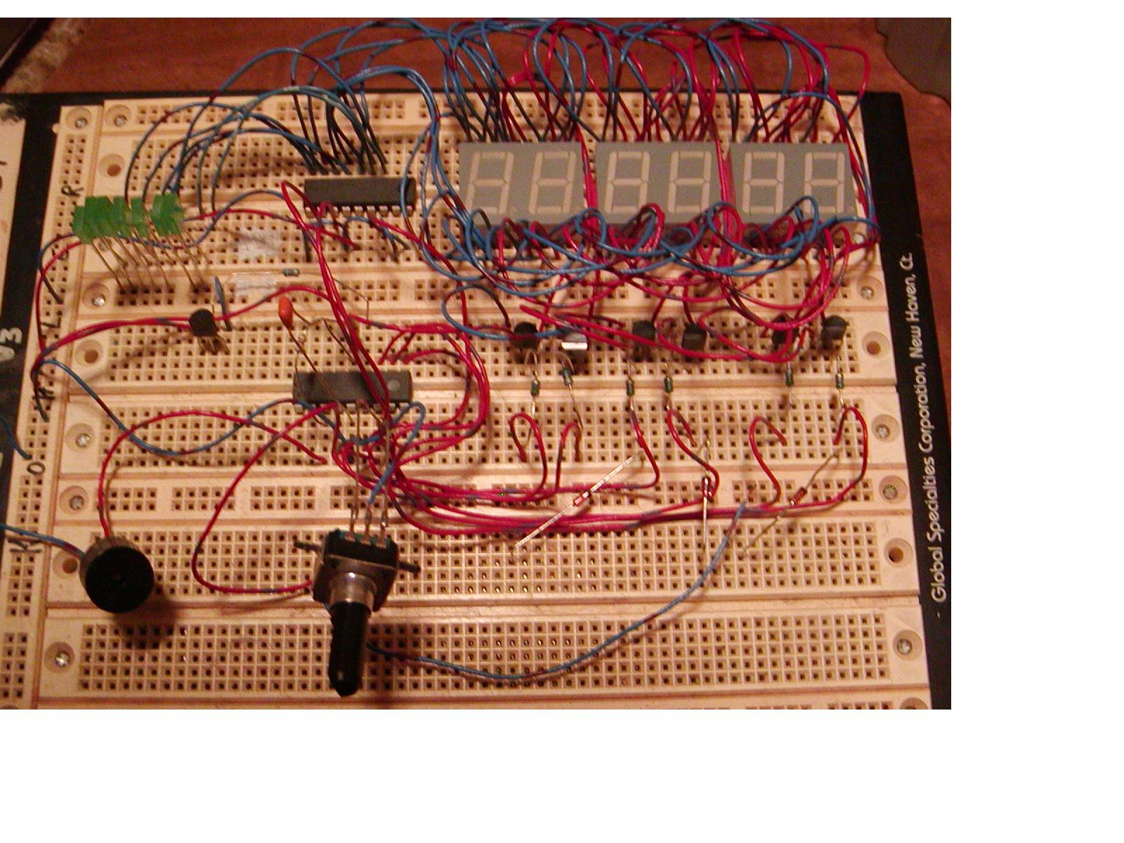

I have a picture of the clock and an idea of a crystal oscilator that worked wiht a capacitor instead of a crystal (Idont have crystals yet). And how do I divide a Khz clock crystal to 1Hz With room for only 2 or 3 more ic's?

May I just say, that's probably the worst build circuit I've EVER seen!.
There are plenty of crystal oscillator circuits about, for this type of use they generally use a CMOS or TTL gate - your opamp 'circuit' wouldn't work, and doesn't appear to be complete either?.
How did you manage to get that wire bunch to work !!
Must be very hard to trace for faults and reading the actual segments for the clock.
But good effort, although now it needs tidying up.
I dont exactly understand.
How do you make it work?
(And yes, that clock isnt extrmely pretty, but it works great (exept the timinng).)

You wouldn't really, an opamp isn't something you would use for a crystal oscillator. However, have a look here **broken link removed** which as well as logic crystal oscillators shows exactly what you're looking for.
Do you buy all your wire pre-cut?, and don't own a pair of cutters? :D

I got a big spool of wire and a good cutting/stripping tool.
Me, too. What a mess! I didn't see it before.
It has about 1 dozen old TTL ICs. It looks like a circuit from 1975 and I expected it to have Nixie tubes instead of LEDs.
I has all CMOS ic's and they are brand new.
Lets not change the subject.
I tried TTL's before this one and it didn't work well.

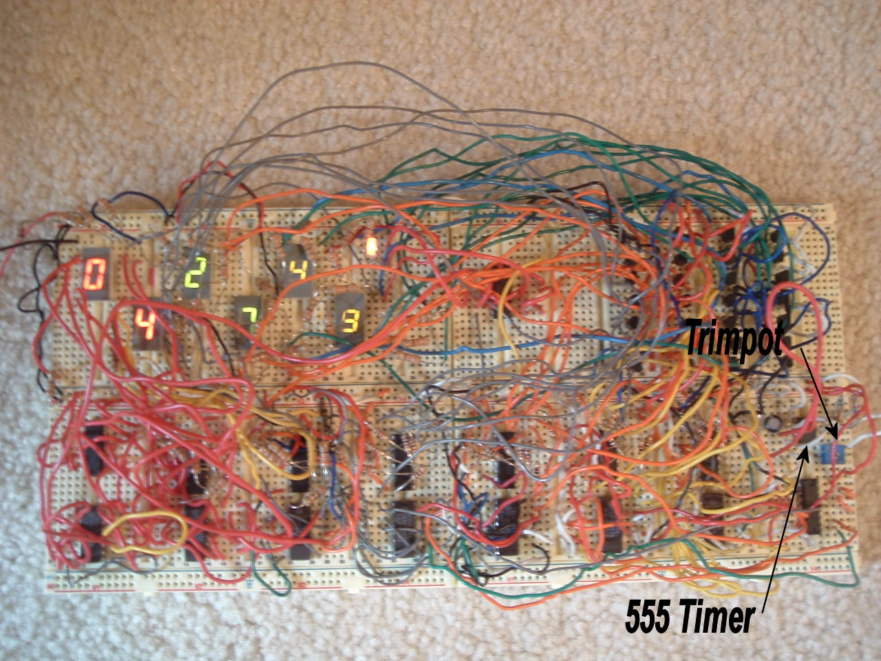

Hey guys, it's hard to keep things neat on those wireless breadboards. Here's what one of my early clock projects looked like. Pretty sad, huh?
Mike
