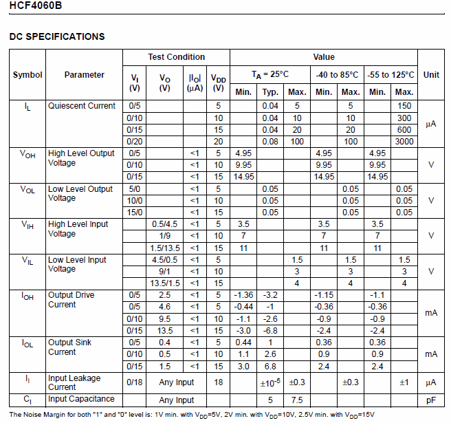

Here are the electrical characteristics (Source ST microelectronics)

That's odd that it can source more than it can sink.
At TTL voltages.
It can source a higher current when its voltage drop is allowed to be half the supply voltage.
It can sink a small current when its voltage drop is only 0.4V.
The datasheets from Texas Instruments have graphs that show the output current at three supply voltages and with any amount of voltage drop. The current is pretty high (typically 14mA) directly into an LED when the supply is 10V.

The OP runs his circuit at VDD=5V.

Then the typical output current directly into a red LED is 3.5mA.
I don't know why the supply voltage is so low. The IC is ordinary Cmos with a max allowed supply of 18V. A 5V regulator is not needed.
That's exactly why I recommended to either use a low current (nominal 2mA) LED or drive a normal (20mA) LED via a transistor.
Anyway, even using a low current LED at Q13 of the 4060 it won't drive a 4013 properly anymore.
Connecting the LED to the output of the 4013 without any further load should make the LED flash at 1Hz.
Experience proves that CMOS-ICs get undefined output levels when connected to a current consuming element. (Their outputs become neither high nor low.)
