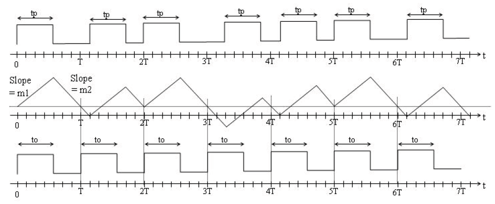

A jitter reduction circuit can be made by feeding your jittery square wave into a positive edge triggered monostable multi-vibrator having a jitter-free positive output pulse width. The output of the mono is then precision integrated with an op amp to form a triangle waveform. The negative slope of the triangle waveform will then cross through an arbitrary positive DC threshold at precisely equal intervals, the jitter depending mainly on the jitter on the positive output pulse width of the mono (see attached figure) and the quality of the integrator. A precision comparator detects when the falling slope of the triangle waveform crosses the threshold to generate a pulsed output with reduced jitter on the leading edges. With only 100 nS of jitter on your input pulse, the challenge will be to make a mono with a pulse width that varies from pulse to pulse by significantly less than 100 nS, which should not be difficult. At such a low frequency, the precision and repeatability of the integrator and comparator should not be a challenge.
Credits to (and where you can get more detailed explanation): https://www.electro-tech-online.com/custompdfs/2013/06/EECS-2007-96.pdf

Thanks Ccurtis, that's a really clever system. :) I especially like the way it could be done in software, with the monostable up-ramp being replaced by a fixed time count up, and the down-ramp by a count down with digital setpoint. That would require the jitter to be large compared to the count rate so would be best on low freq signals with high jitter.
But for my application re this thread I don't think it's ideal. The jitter I am trying to remove is generally 50nS per 1S (1 part per 20 million) and the chance of making a monostable with a timed period more precise than that is low, as is the integrator and threshold. Just 5v PSU variance alone is going to be in the 10's of millionths even with a good regulator. By the time it has some type of active precision regulator(s) and precision monostable and threshold it's getting far from the goal of a very simple filter.
I do appreciate you posting it though, it's a great system. For now re this app I designed a math filter algorithm that has very high filtering and zero accumulated error, which has been working well for the clock timing tests I needed to do. If not perfect, at least it was a zero-hardware solution and got me up and running.
