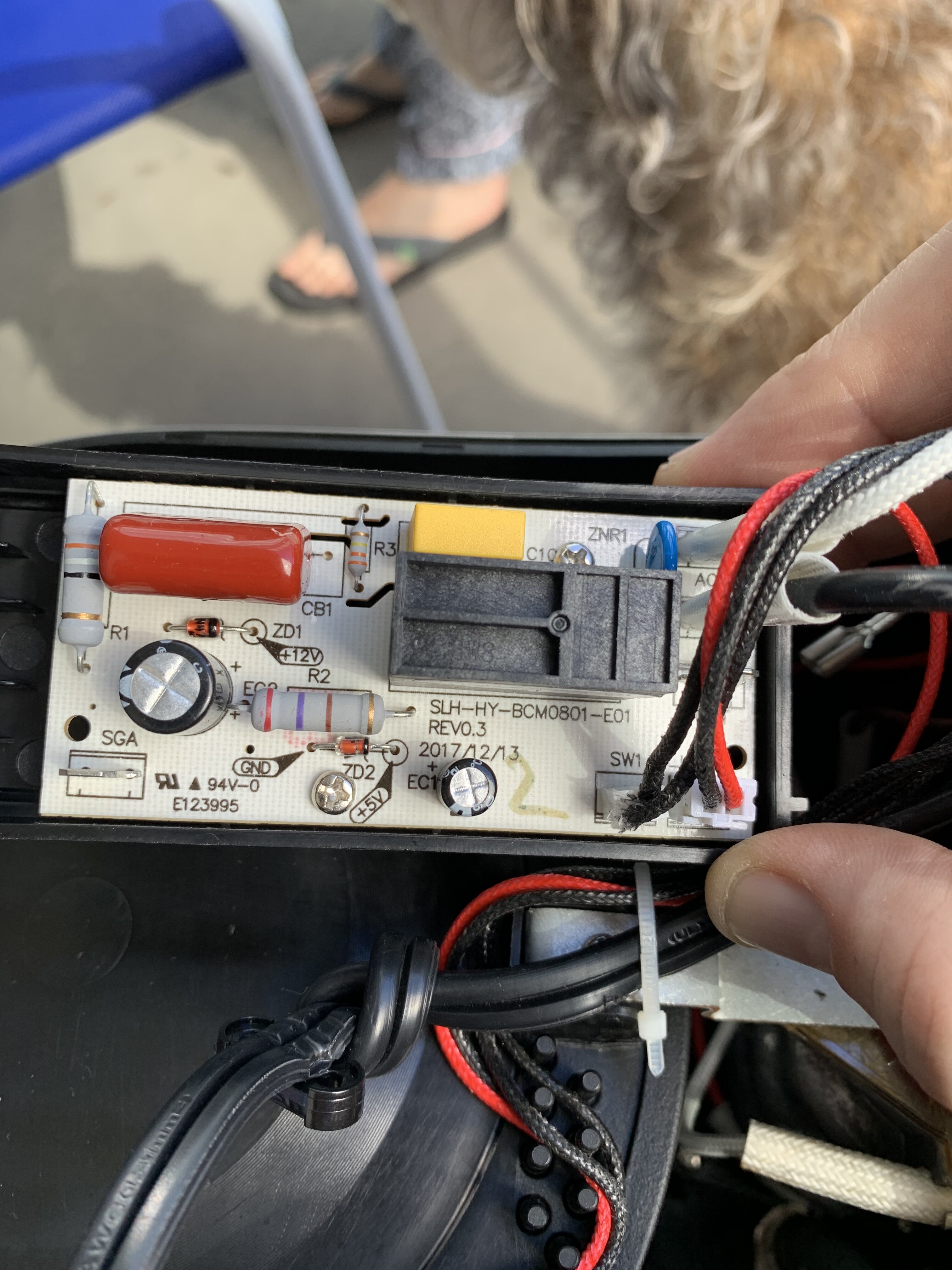

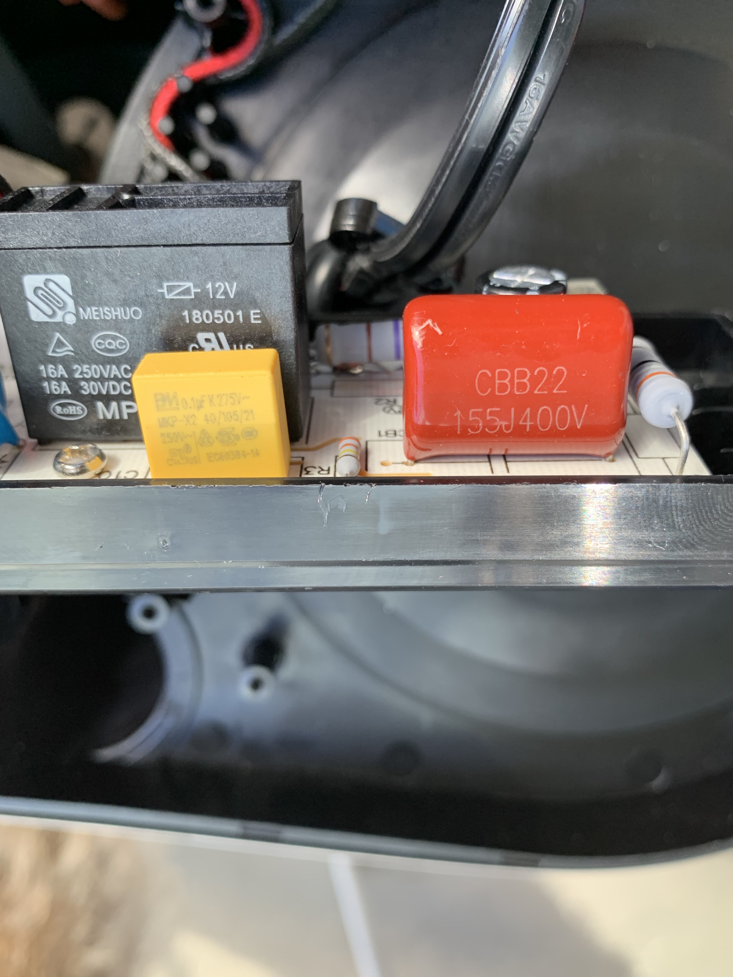

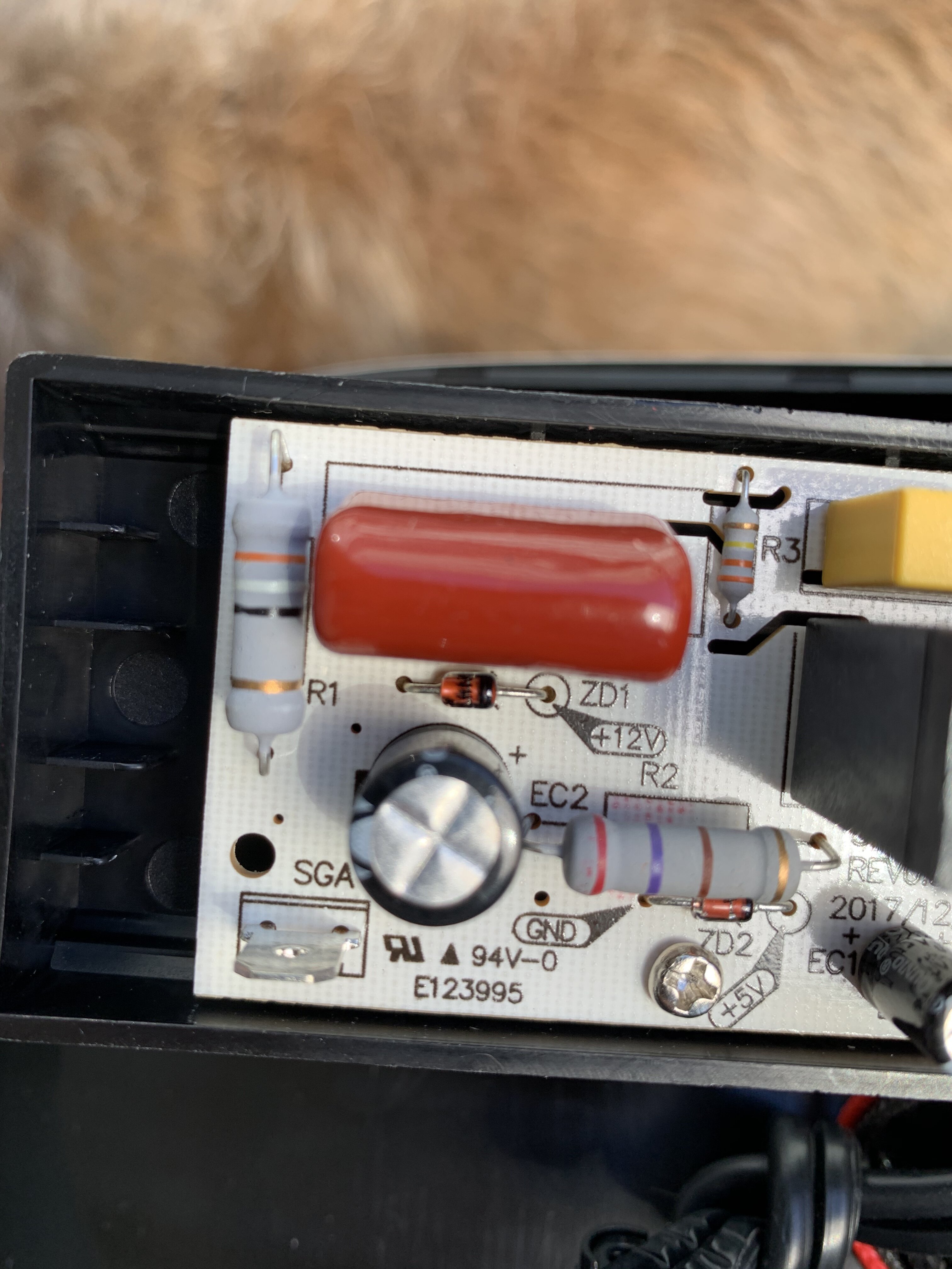

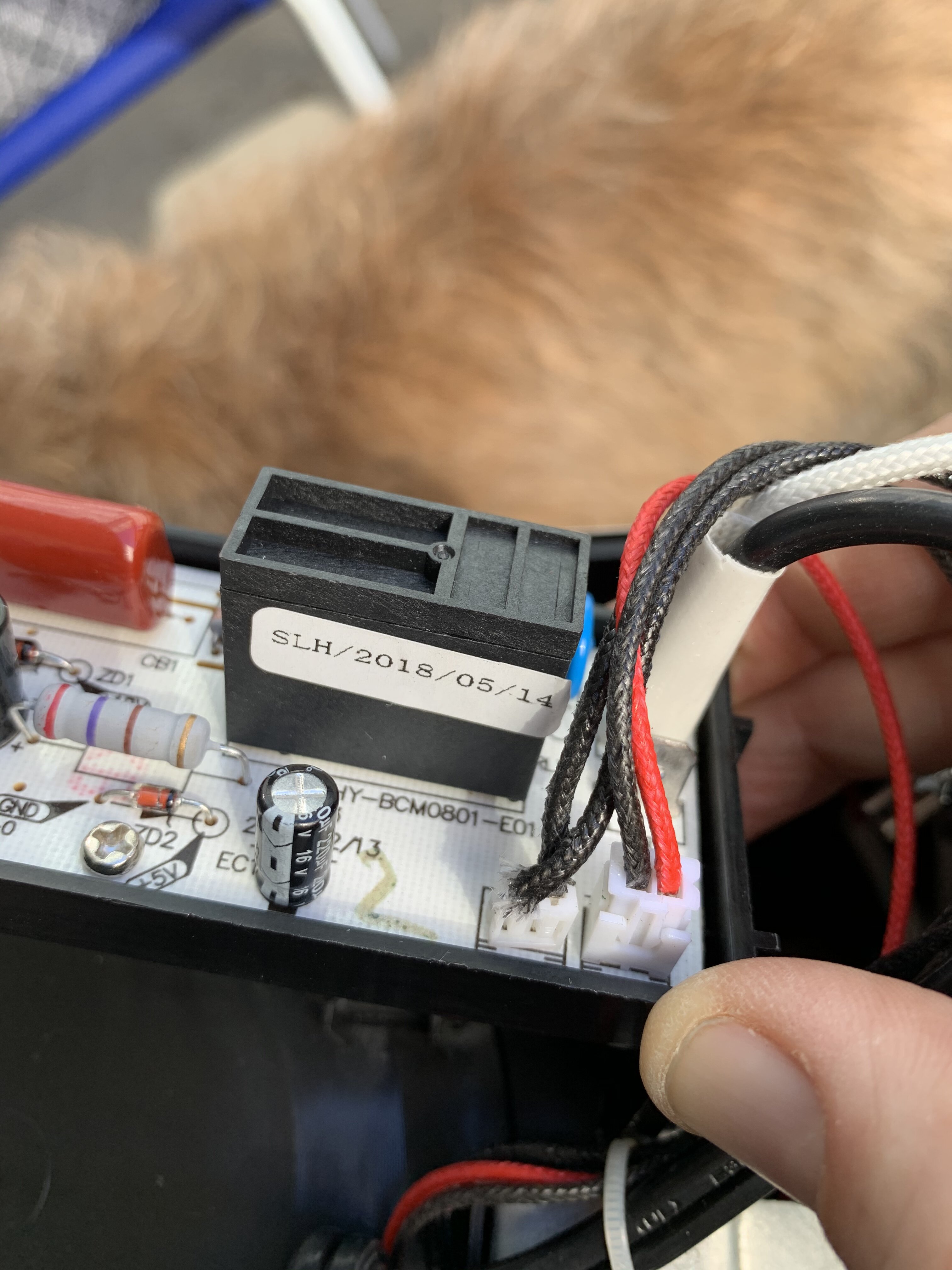

I want to Alexa enable a Bonavita BV1900TS coffee maker. It’s a very simple machine that just has a momentary switch that engages a relay to turn on the brew and turn off when done.
My idea is to just plug the coffee maker into a controllable outlet, basically a WiFi controlled relay.
Goal: When power is first supplied to the coffee maker I want the momentary switch to be “pressed,” to engage a brew cycle, and after that to return to working normally.
My plan: I would use a normally closed relay across the momentary switch to engage it and a capacitor charge delay to then open that relay and return the machine to normal function.
Are their better ways to accomplish this?
Here’s some photos of the circuit inside the coffee maker.

As you have to fill/load the coffee machine manually, why can't you just use the normal power switch immediately afterwards? Doing so would provide valuable physical exercise during this lockdown period. :)
I had the same issue with my garage door and solved it with some help from others on this forum. The key to this is having an internet switch that allows 'inching', sonoff switches do that. Inching allows you to determine how long the switch stays on for when you trigger it, I have my garage door set to to 0.5 seconds. On opens it, whilst opening on again stops it, once open on closes it. I used a low voltage switch as I only needed 5v, but there's lots of comments on how to make the output dry so it acts as a relay. Hope this helps.
Obviously a classic solution would be to use a 555 timer to trigger the button, allowing much better and reliable control than just a capacitor - I did this many years ago at work, to convert old cam-corders to surveillance cameras - really good cameras. but if the power goes off the cameras don't come back on.
A modern day, and superior, solution of course would be to use an 8 pin PIC in place of the 555.
The sonoff low voltage solution would allow you to keep the coffeemaker plugged in and the sonoff would make the connection on the push button (if you can wire it to something). Or, you can make a button-pushing mechanical finger and have the sonoff trigger the finger to push the button!
And...
The modern way to make a one-off microcontroller-controlled device is to use an Arduino or, if wifi is needed, an ESP32/ESP8266.
Thanks for all the input. I was thinking that with a simple relay, resistor, capacitor hooked to either the 5v or 12v on the existing board would be the simplest. I would just have Alexa toggle the outlet control off, wait 1 minute and toggle it on and leave it on. This would trigger my startup relay across the momentary switch. Let me look into some of these ideas mentioned.
