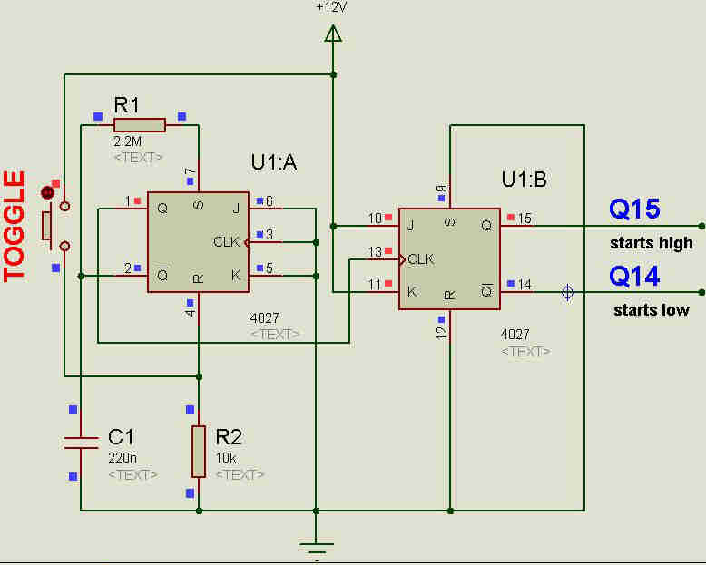

If you want to stay close to your design use a toggle switch made with a CD4027.
The outputs change state with each high pulse edge on the input, which has to go low before next triggering.
Boncuk

To Boncuk:
Is this the chip you are talking about?
https://www.electro-tech-online.com/custompdfs/2008/11/fn3302.pdf
It looks like 2 flip-flop switches on a single chip.
How would I be able to make a toggle switch with the chip?
Do you mean something like a master-slave (pulse-triggered) D flip-flop?
Also, would the input pulse have to be constant high to keep one route and then constant low to keep the other route?

To Boncuk:
https://www.electro-tech-online.com/custompdfs/2008/12/fn3302.pdf
The switch toggles Q14 and Q15 every time the switch is depressed. The duration of switch activation has no influence on the function. However to toggle again the switch must be released for a short time. (to have the input return to ground) The first half of the IC produces a needle shaped pulse to trigger the second half.
