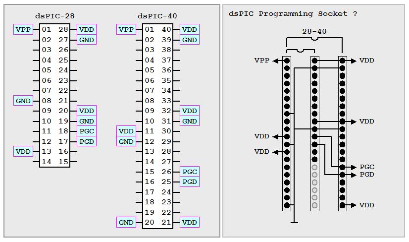

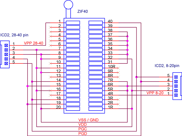

Well here's the "flippy socket" for ICD2 clones. On 28-40 pin PICs the PIC is inserted with pin1 in the socket pin 1. On 8-20 pin PICs you turn the socket 180degrees and pin1 on the PIC goes into pin 21 (or 1R on the schematic)
Happen to have PCB layout of it. I will be getting ICD2 clone soon. :)
I can draw it, but if you already have it.
Bill,

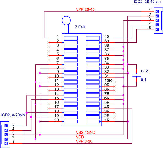

Looks similar to an adapter board I posted last October in this thread. My design allows for the use of a ZIF-40 socket or less expensive 20-pin single-in-line machined sockets. While the silk screen says "8-18", a newer layout says "8-20" (same electrical layout).
zif-40a-jpg.6190
One potential problem I see is that you're routing the PGC and PGD signals to multiple pins if a 40 pin device is installed. You've got seperate 8-20 and 28-40 connectors -- use 'em.
Regards, Mike
