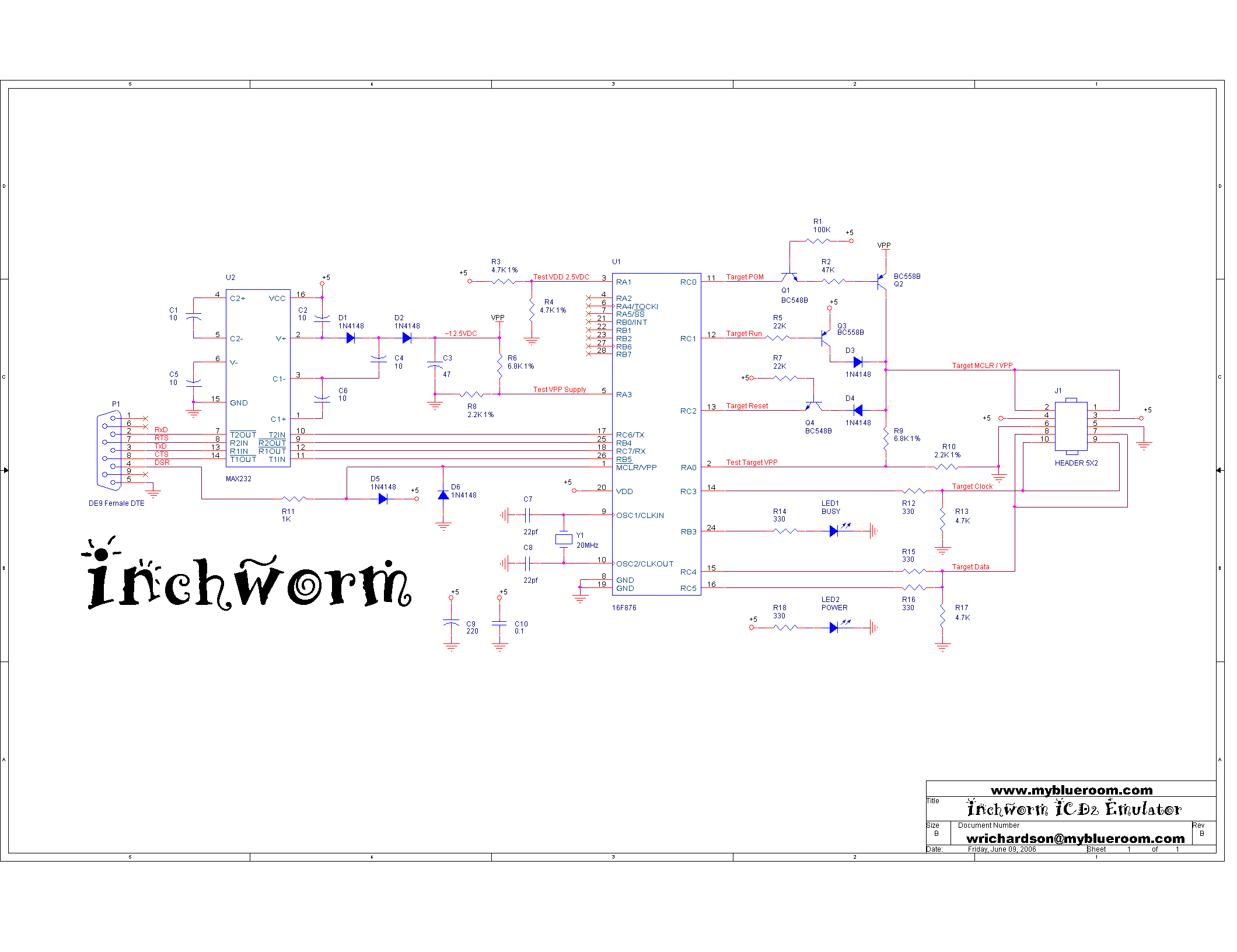

Yet Another ICD2 Emulator
Yup it's another ICD2 clone. It's about as simple as I could design it. The power supply (not shown) is a 5V DC switching wall wart and cost me $2 from a surplus store in Toronto.
I used a 16F876 (not A) with microchips firmware and it passes all self tests. I've designed it with a weedy power stealing VPP from the MAX232 (with big 10uf caps) and a 1.5x multiplier (the diodes and such bring it down to approx 12.8V)
Looking at the scads of ICD2 clones on the net and the might work might not modded firmware for the 16F876A I stuck with the still available 16F876 (If you've got working 16F876A firmware let me know)
The Lothar Stolz ICD2 clone is very good **broken link removed** , it's the basis of this one (the Inchworm). Only real change is the power supply and LEDs. I haven't tried his LM358 op-amp version. I don't see how it generates all three states for VPP. (12.5V target VPP, 5V target run, 0V reset)
Comments & flames welcome :)

cute design for Vpp but wont the drop across Q2 take it below the level needed for some PICs?
I've done a simulation of the op amp part of lothar's circuit and it does, indeed, generate the proper 3 Vpp states. if you want I can send you the Switcher Cad file. You would need a Rail to Rail opamp if you fed it 12.8V. The 358 doesn't cut it in that case.
I got lothar's opamp design working with the 877A so I believe the 876A should work, too. You just need the ICD661.hex bootloader instead of the one that ships with MPLAB.

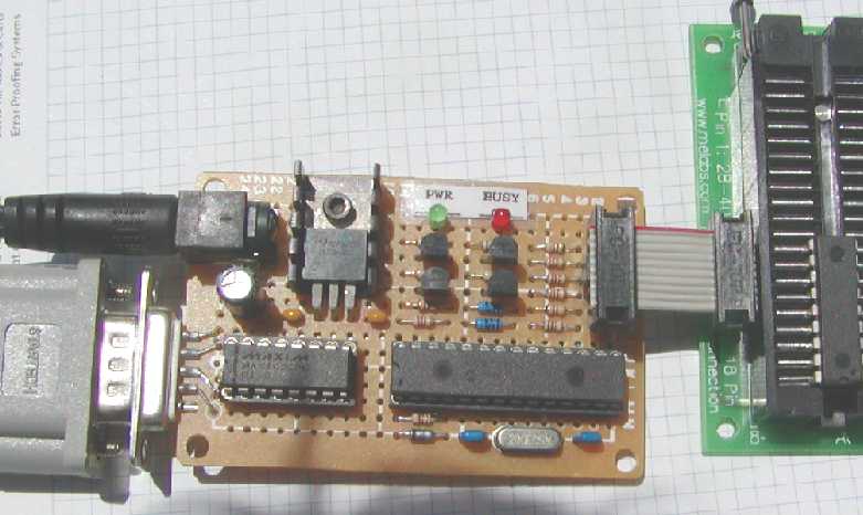

Any pictures of the completed project Bill?

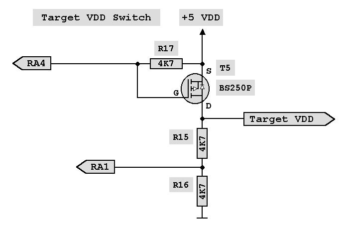

I added a Target VDD high-side switch to allow ICD2 powered Target VDD (an option in the ICD2 menu).
I've used both the '876 and the '876A (with modified bootloader file below which should be renamed with ".hex" filename extension) and they work exactly the same.
Regards, Mike
It works very simple:
Uses 3 input combinations to get 3 modes:
Off = 0V
Repeater mode= 5V (5V from the input = 5V out)
Amp mode = Vpp (based on resistor ratio and PS voltage)
