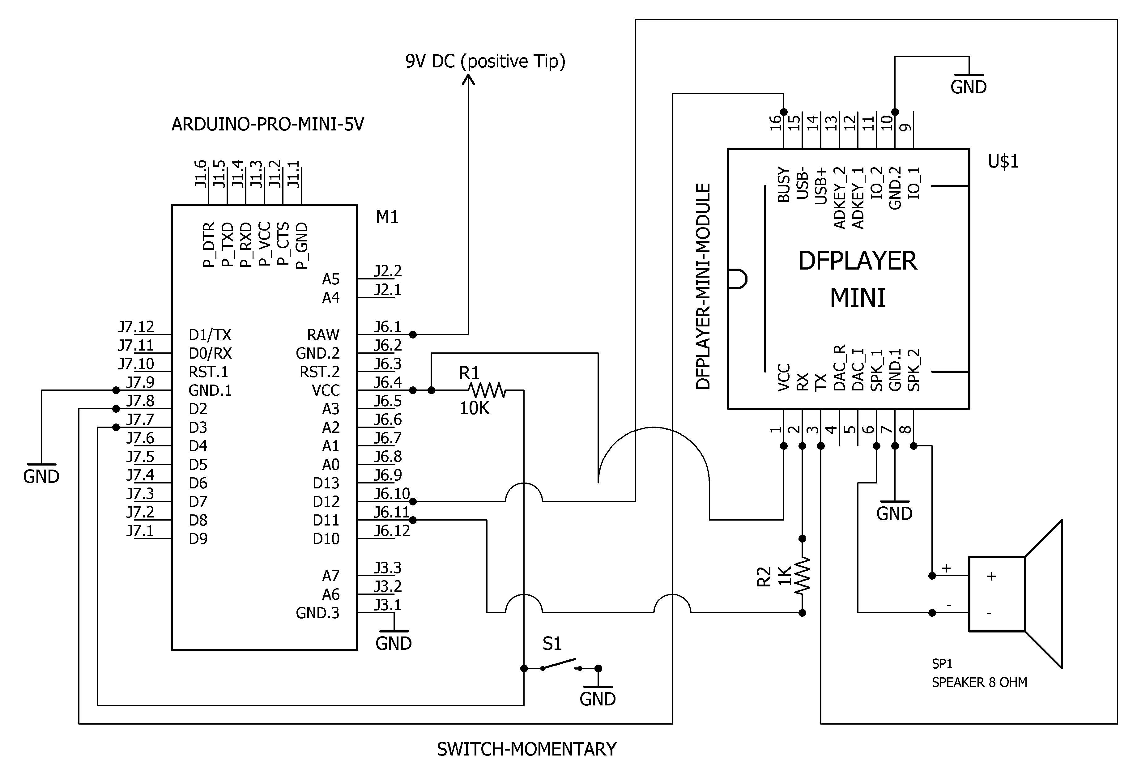

Here is what I came up with:
These DFPlayer boards are really pretty remarkable at a couple of bucks (bay clones). You record one or more (up to 255, I think) mp3 files on an sd card and then using a simple controller, you can play a selected file under program control. They even have an onboard amplifier that can drive a little 8 Ohm speaker with decent quality and volume. I chose an Arduino ProMini 5V clone as the controller.

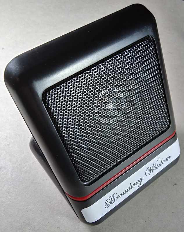

The entire project is enclosed in an old speaker meant to connect to a PC.

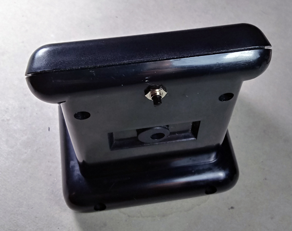

The back side shows the trigger switch (one press will play one "phrase" at random. You can also see the power jack. I used one of the many old wall warts I have on hand. The ProMini has an onboard regulator using the "raw" pin and then, the Vcc pin drives the DFplayer.

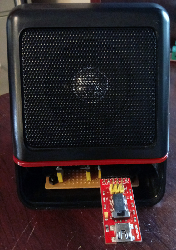

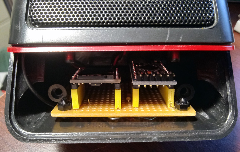

The lower panel comes off to allow access to the controller and the SD card.
Thus, you can attach a USB to Serial board and reprogram it easily.
You can also easily remove the SD card and add / subtract and change phrases. I used Audacity to record and trim the mp3 files and I highly recommend that program.
