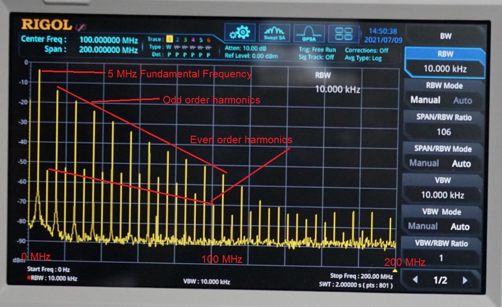

The signal was generated at some lower frequency, and the radio was receiving a harmonic in the FM band.
But the micro was also generating other harmonic signals up and down the radio spectrum. A very anti social thing to do, also illegal.

The power output of such a system will be low, it is difficult to be precise without a lot more information.
But 50 mW can go a long way, more that a couple of metres, a lot depends on what type of antenna it is connected to.
There are many badly designed (ie cheap) digital devices and switching power supplies for things like LED lighting which cause widespread interference to radio systems.

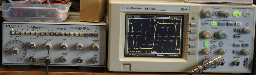

This is not a simple thing, but try this:
Let us assume that the 3.3v peak to peak signal is a sine wave (ie one single frequency), the RMS value of that sine wave will be
3.3/(2 x 1.414) = 1.17v (the '2' converts peak to peak into peak value, the 1.414 covberts peak value into RMS value).
To find the amount of RF power delivered to a load such as an antenna, we need to know the impedance of that antenna.

Going back to your microprocessor FM "transmitter", It is unlikely that it would be able to generate a 100MHz signal directly, but would generate the signal at a lower frequency, such that a receiver would be able to detect one of the harmonics.
As a demonstration, I set my function generator to give a 3v p-p 5MHz square wave, seen here on the oscilloscope:
A reasonable square wave, the rise times look a bit slow, but good enough.
Now look on the spectrum analyser:
The thing spreads far and wide.
On well shaped square wave, we would expect to see the fundamental frequency and the odd order harmonic.
Here we also have a lot of even order harmonics.
If this were connected to an antenna, we would radiate signals at
5MHz, the fundamental
15, 25, 35, 45, MHz etc, the odd order harmonics
10, 20, 30, 40, etc MHz, the even order harmonics.
Which is why, in my first post, I referred to this technique of signal generation as "dirty".
