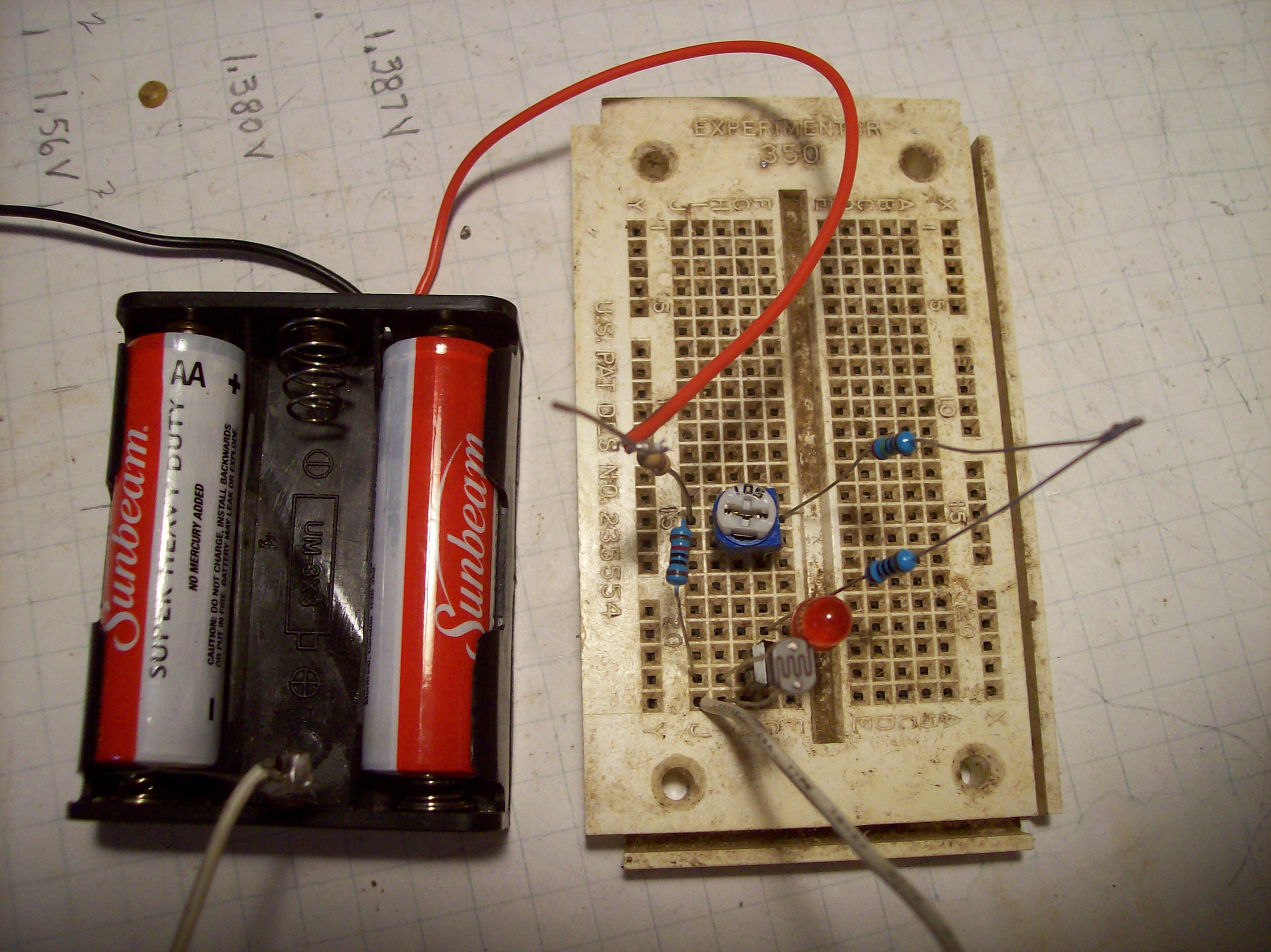

This is my first prototype I hung it on a trellis before dark. As it slowly gets dark all 3 LEDs slowly come ON. When voltage gets high enough the flasher starts to blink. The unit did good all night running on 2 AAA batteries. This morning as it slowly became light RED LEDs stopped flashing and slowly got dimmer and dimmer until all 3 LEDs are off. The light detector circuit has a yellow LED that stays ON all night it uses unnecessary power from the battery, this LED needs to be OFF or removed to save battery power it defeats the purpose of the light detector circuit. The 2 Red LEDs blink rate is 2 seconds at a distance it appears to be 1 LED blink rate of 1 second.
What is the resistance of an LED? Yellow LED needs to be gone then maybe R3 = 340 ohms needs to be higher. Flasher should still work maybe better with larger voltage across a larger resistor. No sure how to prevent this unit from slowly coming ON & slowly going OFF ? Is it possible to put a voltage multiplier between Q1 & Q2 to increase 2.07v to 3v ?

The light detector can be a Schmitt Trigger circuit to suddenly switch the LED blinker on or off.
A 74HC00 IC has four Schmitt Trigger gate circuits in it and works from a supply that is 2V to 6V. It draws very little battery current but has enough output current to light LEDs.
One Schmitt Trigger can be the light detector and a second Schmitt Trigger can be an oscillator driving the 1st LED and a third Schmitt Trigger can be an inverter to drive the 2nd LED.

I put an alligator clip across LED 1 to short it out the light detector no longer works. I tried to ohm an LED I get no reading on any meter setting. I increased R3 to 470 ohms light detector works & flasher still works too. I looked at data sheet for 74HC00 I have no clue what this does? It says TTL login but it is not in my TTL book. I found information that says, 74HC00 see 7408 flip flop. TTL Book does not tell how 7408 works there must be a circuit that sets the speed? All I need is 1 flashing RED LED with a light detector that operates on 2 D batteries. There is no circuit information? I need information how 74HC00 works a circuit drawing and educational write up how to design a circuit. I can't fine youtube video how 74HC00 works.
The 7400/ 74HC00 is not a schmitt trigger device.
Look at the CMOS 4093 or 40106; they both have schmitt trigger inputs.
You can use one input of a 4093 gate for the on/off control and another for for the flasher oscillator,then the other three sections in parallel as a buffer to drive the LED.

What is the defination of input? Voltage, switch, AC, DC, low resistance, high resistance, capacitor, ??????????
After checking out the data sheet is this correct?
LDR is 500 ohms to 1M ohm
I was thinking about using the high output current of 74HCxxx ICs that can drive an LED but a 74HC132 is a Schmitt Trigger quad 2-inputs NAND gate.
The 2-inputs gate is needed so that both LEDs can be turned off when there is light on the photocell.
Since the 74HC132 has NAND gates then a gate can be a simple Schmitt Trigger inverter when one input is always set to be high.
The 74HC132 is Cmos so its inputs are controlled by voltage, the input current is extremely low.
I accidentally made an improvement on this circuit. I decided to replace R3 with a variable resistor to see if higher resistance will increase the 2.07 volts. I forgot to disconnect the battery soon as I unsoldered the resistor LEDs got brighter and started blinking slower closer to the correct flash rate. Higher voltage make flasher blink slower. Voltage is up to 2.4V with yellow LED & R3 gone. Is there a way to get 2.4v up closer to 3v ?
You have 2.4V because Q1 is not saturated because its base current is too low. The base current is only (3.2V - 0.7V)/57k= 43.8uA.
If the red LEDs are 1.8V red ones then the 470 ohm resistors limit their current to try to be (3.2V - 0.2V - 0.2V - 1.8V)/470= 2.1mA but then the base current must be 0.21mA which is 210uA. Change R1 plus R2 to 15k but then the photo-resistor will need more light to turn off the circuit and R1 will draw more current during daytime.
I had to make 1 small change to the circuit. I walked out to the street 200 ft away 2 LEDs blinking look like 1 LED. I could cover 1 Red LED with tape but decided to replace 1 Red LED with a Yellow LED. Now it is very noticable 2 lights are blinking. 2.4V is making very bright flashing LEDs very easy to see. The 100uf caps are taking a good size charge making more than enough light. The LED Blinker circuit ran for 1 month with 2 AAA batteries and 4 months with 2 D batteries. I can let it run with 2 AAA to see if it will run 1 month with the Light Detector circuit that has been added. If the circuit runs 1 month like before nothing gained. If it runs more than 1 month the light detector is saving battery power not blinking all day in the sun too. LDR is very sensitive days will soon be shorter than they are now. If battery life is increased 50% then 2 D batteries will last 6 months instead of 4 months. It will take a month to learn how well the light detector circuit is working. Instead of waiting a whole month maybe I can use my amp meter to test it if it reads that low. Tomorrow is another day, I need to get 1 of the LED blinkers with no Light Detector working tomorrow and test both circuits on the amp meter. Here is the final circuit drawing.
There is no cardboard tube on LDR this circuit is plenty sensitive LEDs are trying to turn ON in the evening in a time span of 10 minutes. LEDs are trying to turn OFF in the morning in about 10 minutes.
